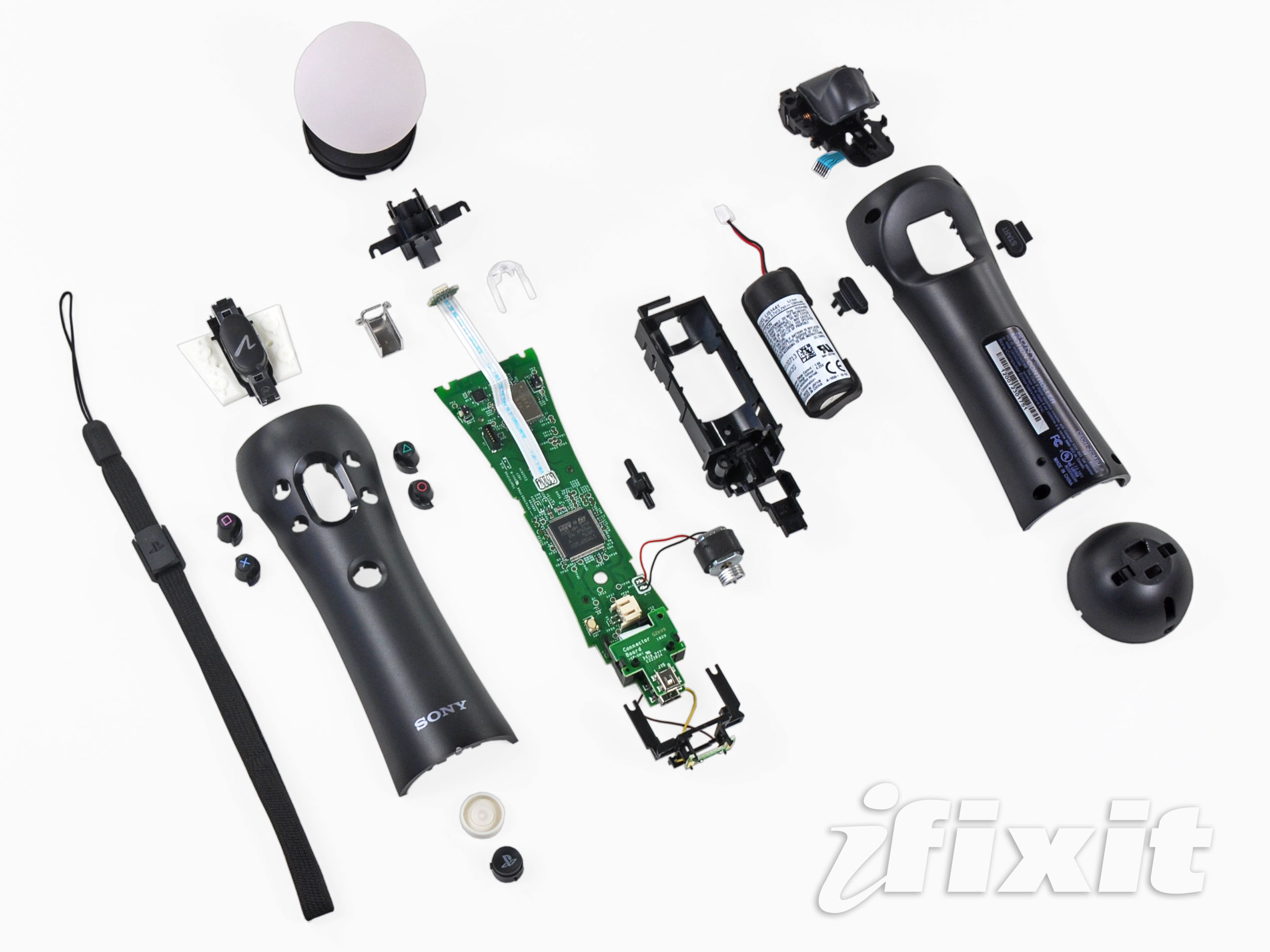

  • Front and back side of the controller motherboard.
    • The Move board loses points on repairability due to the vibrator motor, LED, charge contacts, and EXT cables being soldered down.
  • The top half of the front side of the motherboard is dedicated to the button contacts, while the bottom half is crammed full of chips.
  • The back side is dominated by the ARM processor.
Image #1 Image #2 Image #3
Add Note Edit Step 11  ¶
  • STM32F103VBT6 ARM-based 32-bit MCU with Flash, USB, CAN, seven 16-bit timers, two ADCs and nine communication interfaces.
  • Y5250H 2029 K8QEZ. This is quite possibly the gyroscope, but we won't be able to tell for sure without decapping the chip.
  • Kionix KXSC4 10227 2410 accelerometer
  • Texas Instruments BQ24080 1-cell Li-Ion Charger.
  • A little birdy helped us identify this TPS63030 High Efficient Single Inductor Buck-Boost Converter.
  • CSR (Cambridge Silicon Radio) BC4RE A16U Bluetooth transmitter
  • AKM AK8974 three-axis Electronic Compass (MEMS)
