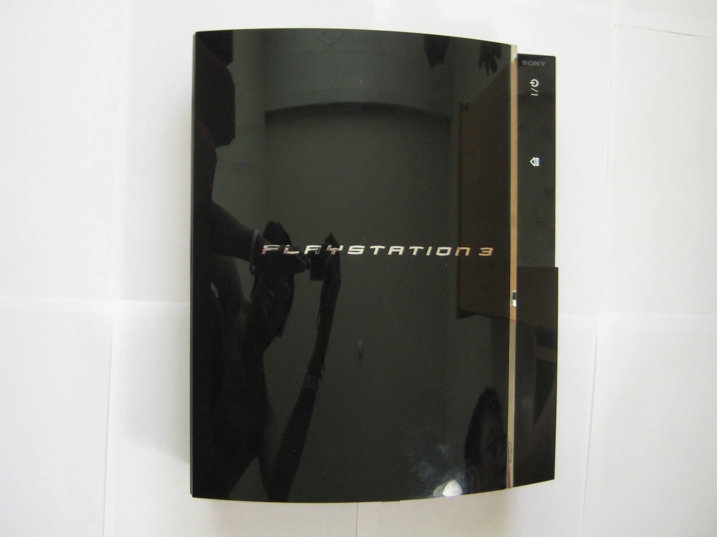

  • There she is, one of the two original PS3 models available at launch (60GB).
  • It's got PS2/PS1 backwards compatibility and a multi-card reader. The current PS3 Slim doesn't have the card reader. The other launch model lacked the card reader and WiFi (20GB).

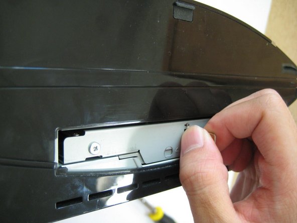

  • Remove the hard drive access cover from the bottom of the PS3.
Image #1

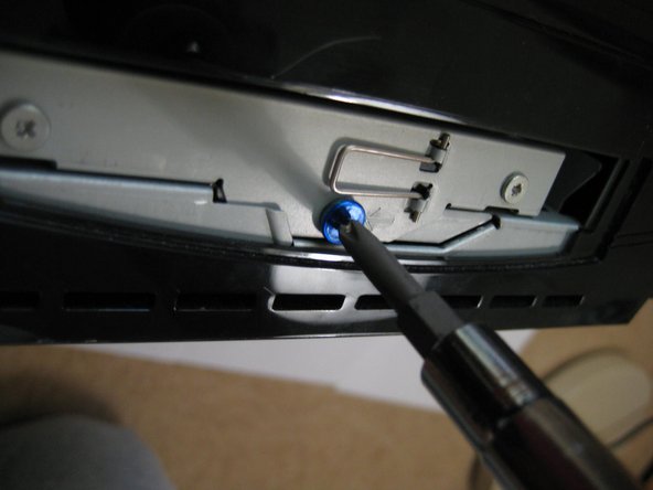

Add Note Edit Step 3  ¶
  • Use the Phillips screwdriver #1 to remove the blue screw.
Image #1 Image #2 Image #3

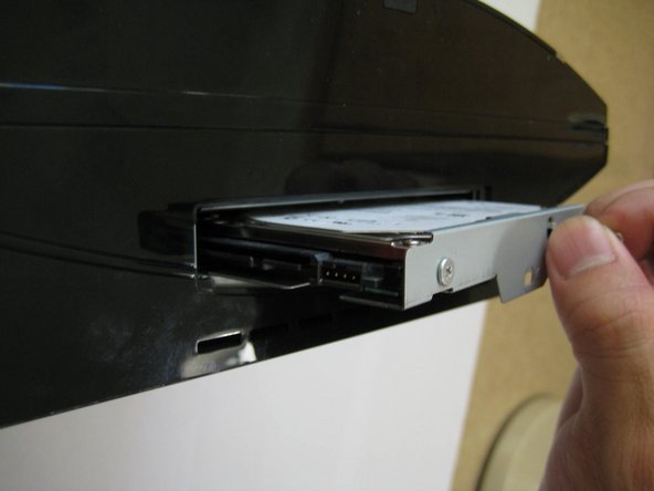

Add Note Edit Step 4  ¶
  • Lift up the metal lever.
  • Slide the hard drive towards the front of the case.
  • Pull it straight up and out of the unit.
    • This is all you need to do to access the PS3's hard drive.

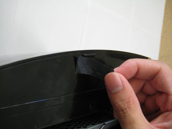

Add Note Edit Step 5  ¶

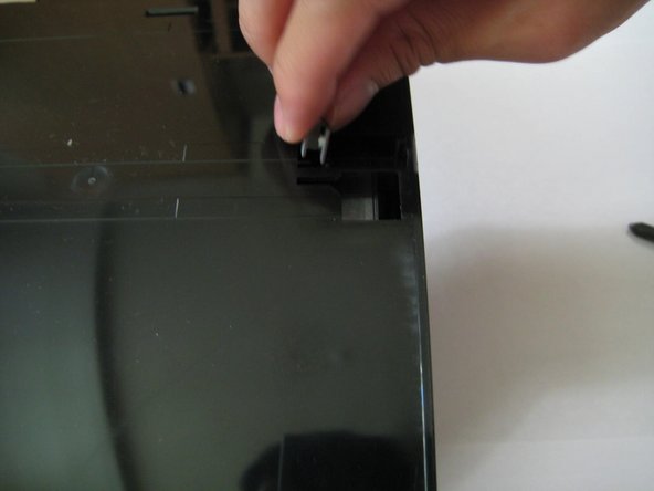

  • Remove the warranty sticker.
    • Obviously this voids your warranty. You have been warned.
  • Use your fingers and pry up and remove the foot underneath the sticker.

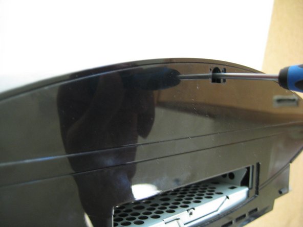

  • Use the Torx Screwdriver (T8 or T10) to remove the torx screw from the space behind the rubber foot.
    • This screw has a security bit but most are able to remove it successfully with a normal Torx driver.

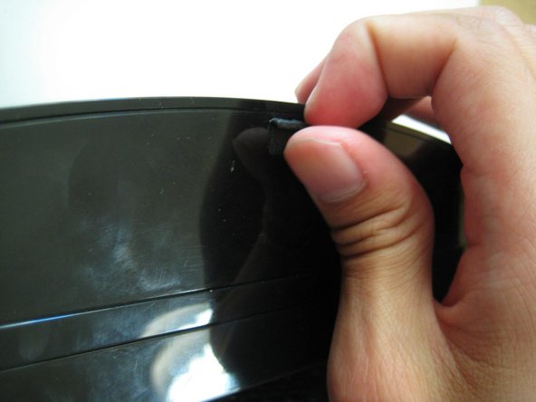

Add Note Edit Step 7  ¶

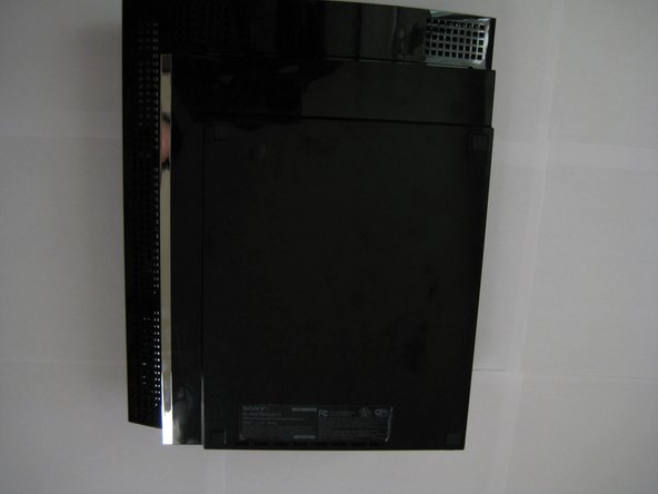

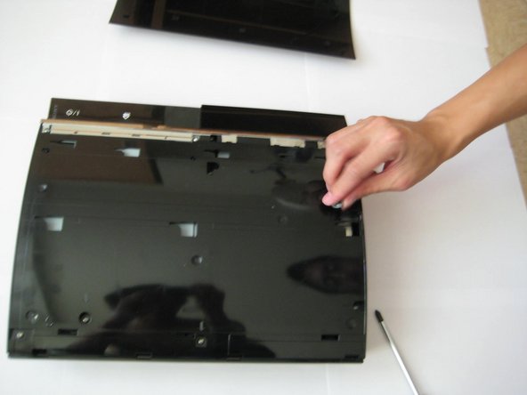

  • Place PlayStation face up such that "PlayStation 3" is oriented so you can read it.
  • Place your palm on the PlayStation 3 logo and slide the plastic front cover towards you and off of the outer plastic shell. Set it aside.

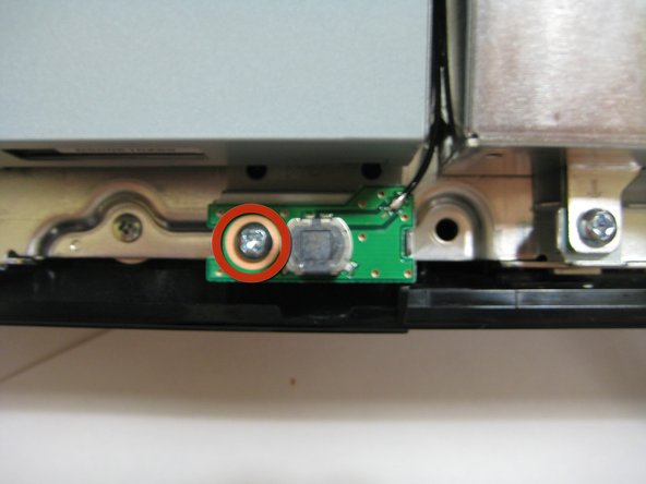

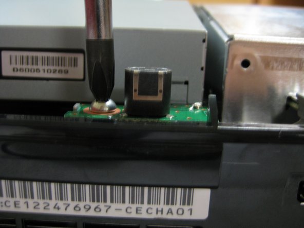

  • Remove the metal receiver that held the torx screw you just removed.
Image #1

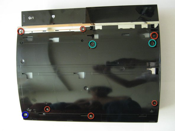

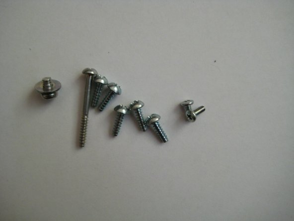

  • Remove the 9 screws from the outer plastic shell using a #2 Philips driver.
    • 6 large screws
    • 1 medium screw
    • 2 small screws

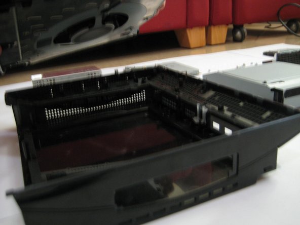

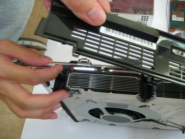

Add Note Edit Step 10  ¶
  • READ THIS ENTIRE STEP AND THE NEXT ONE BEFORE PROCEEDING. Locate the two locking tabs on the back of the PS3. Push them in simultaneously and lift the outer plastic shell off of the main board but BE CAREFUL as there is a ribbon cable connecting the shell to other hardware.
    • Ribbon cables are very fragile. Take care when removing or inserting ribbon cables.
Add Note Edit Step 11  ¶
  • Disconnect the ribbon cable and set the shell aside.

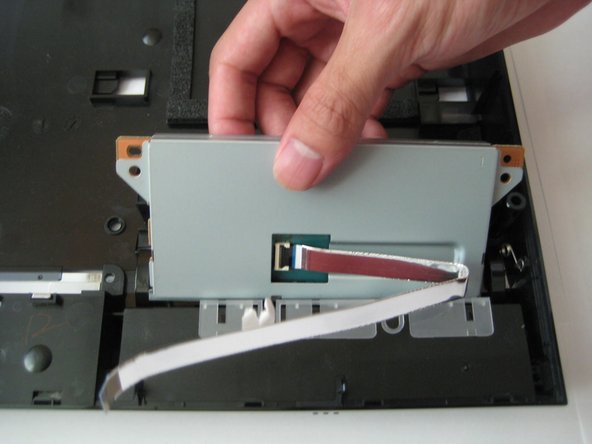

Add Note Edit Step 12  ¶

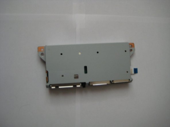

  • To remove the plastic card reader, locate its two locking plastic tabs that hold the card reader to the shell, spread them, and lift the card reader off of the shell.

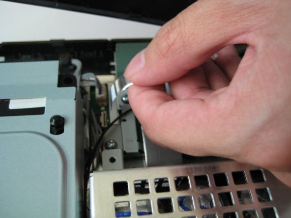

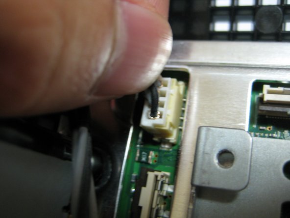

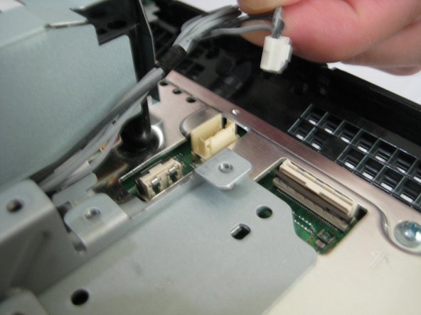

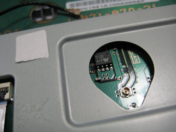

Add Note Edit Step 13  ¶

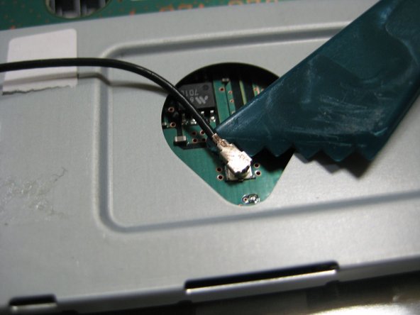

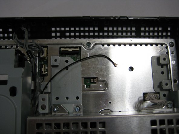

  • Working on the main unit, lift up on and disconnect the black RF wire from the wireless assembly using a spudger.
Image #1 Image #2
Add Note Edit Step 14  ¶

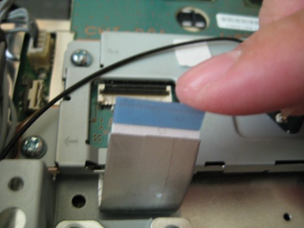

  • Remove the flat ribbon cable from the wireless assembly.
Image #1

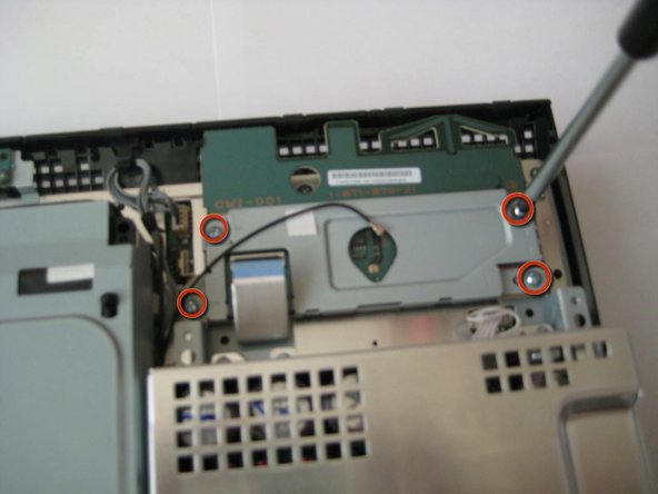

  • Remove the four Philips #2 screws from the top of the wireless assembly.

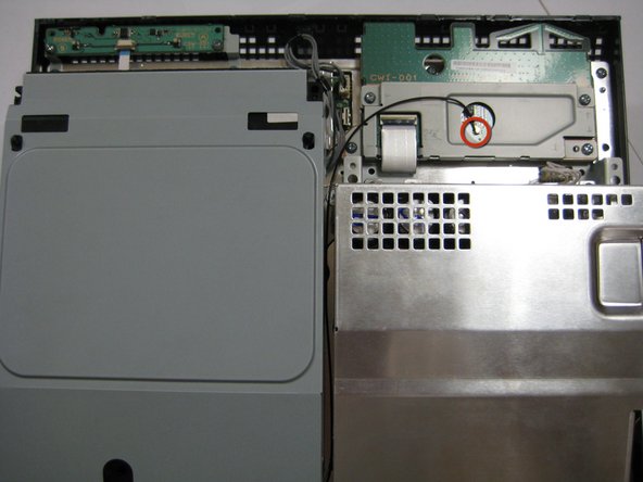

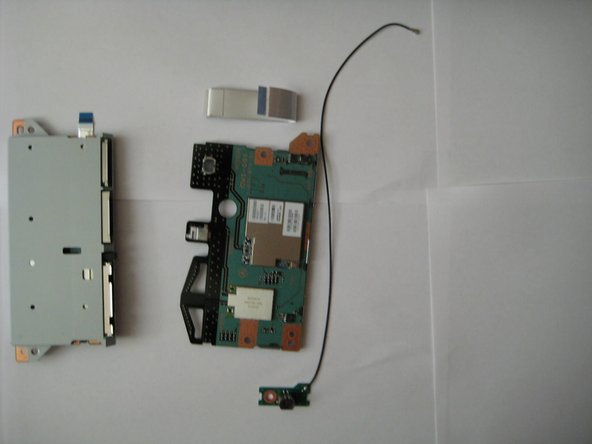

  • Locate the other wireless assembly which the black RF wire is connected to.
  • Remove the one Philips #2 screw retaining it to the main board and lift off the assembly and set it aside.

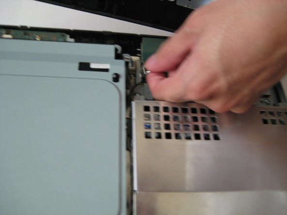

Add Note Edit Step 18  ¶

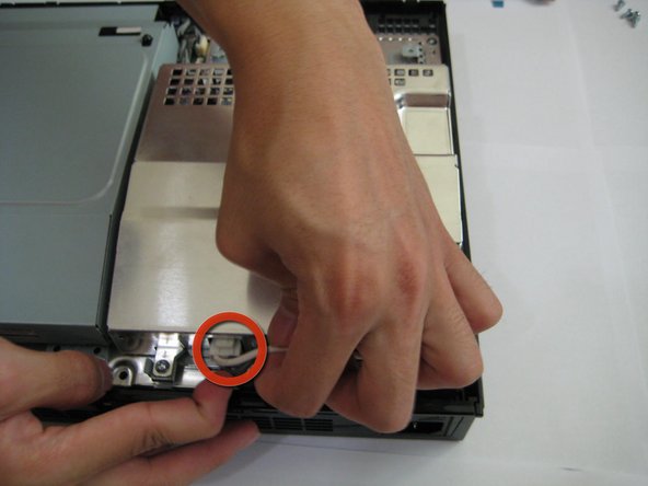

  • Remove the cables that attach the power supply to the main board.
  • Remove the AC connector from the power supply.

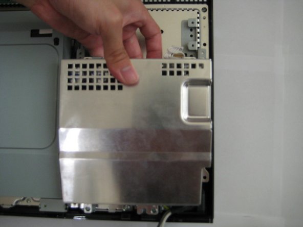

Add Note Edit Step 19  ¶
  • Remove the 5 screws using a Philips #2 from the power supply, and lift the power supply straight up and off of the main body. Set it aside.
    • There are 2 power pins connecting the motherboard to the power supply as you remove it.
Image #1 Image #2

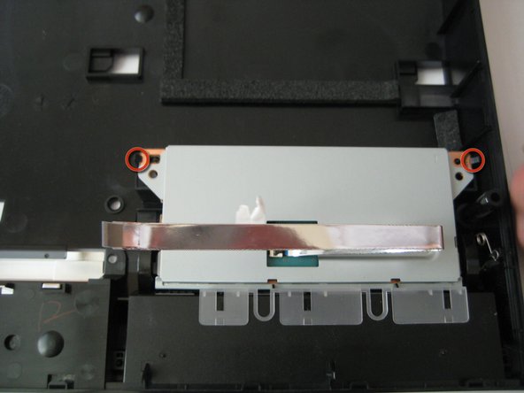

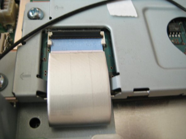

Add Note Edit Step 21  ¶

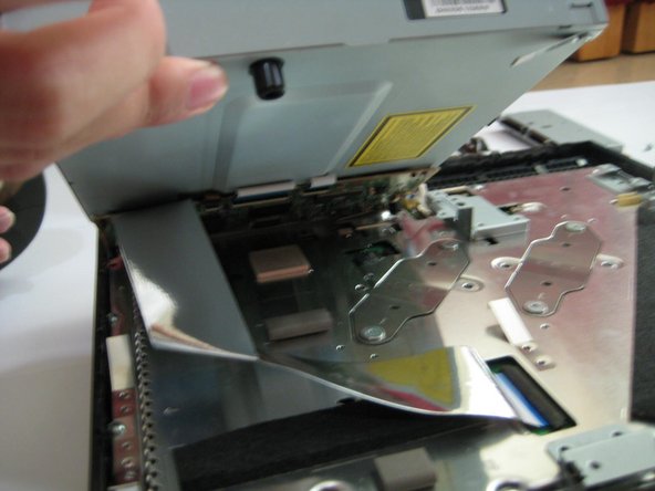

  • READ THIS ENTIRE STEP BEFORE PROCEEDING. Lift the player up slowly to expose the folded ribbon cable beneath it.
  • Remove that ribbon cable from the main board and set the drive/cable aside.
Image #1 Image #2

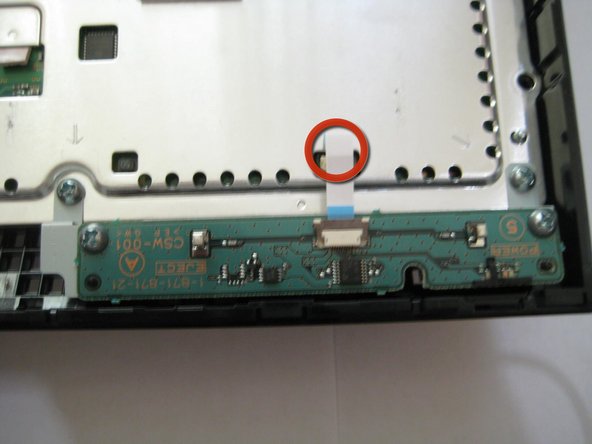

Add Note Edit Step 22  ¶

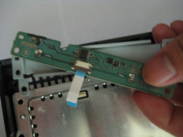

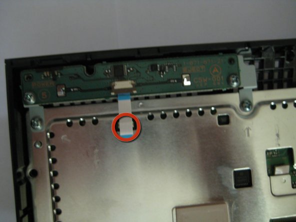

  • Remove the ribbon cable attaching the on/off and eject switch circuit board to the main board.

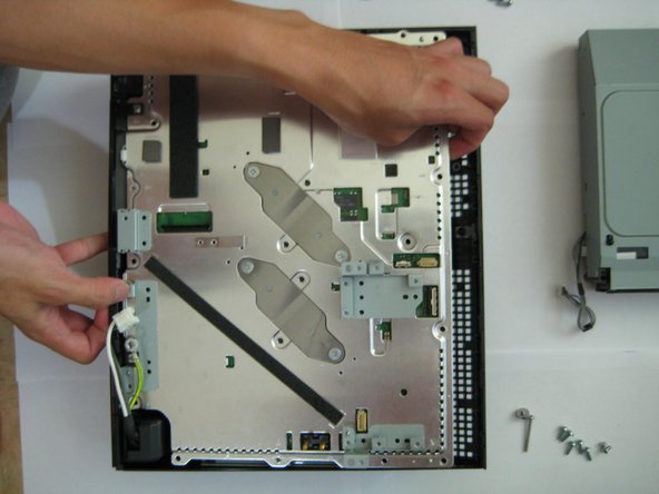

  • Remove the 9 screws from the main body.
    • 5 Medium Philips #2 Screws
    • 2 Small Philips #1 Screws
    • 1 Ground Philips Screw with Washer
    • 1 Bolt Philips Screw (under AC cord)
Image #1 Image #2
Add Note Edit Step 25  ¶

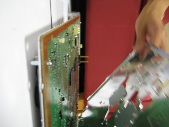

  • Grab the main board at the locations shown in the picture and lift the main board off of the back casing.
  • Set aside the black shell.

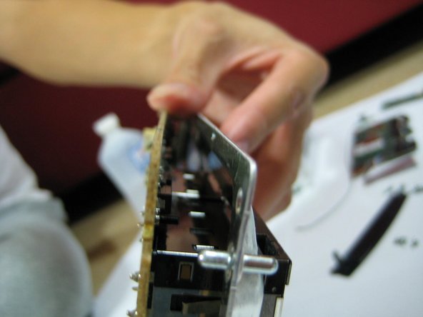

  • On the main body, locate the 5 plastic locking tabs holding the rear plastic I/O shield to the main body.
  • Pry the tabs away from the body and lift the rear shield away.

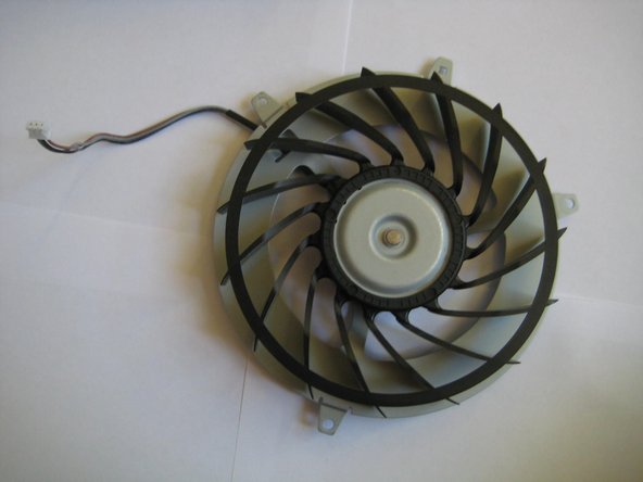

Add Note Edit Step 27  ¶

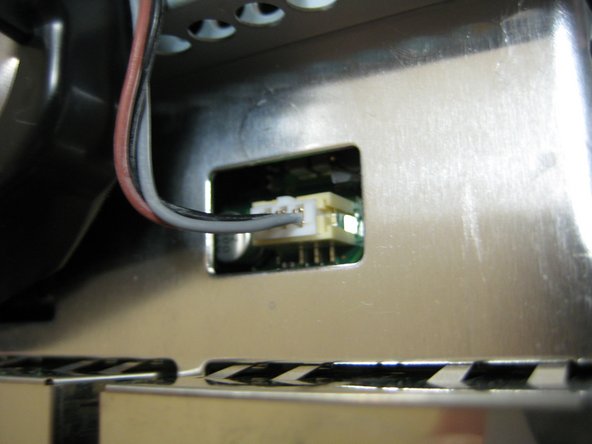

  • Remove the fan power connector.

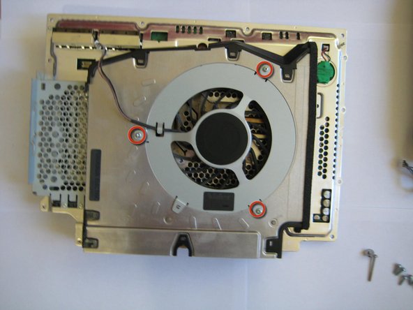

Add Note Edit Step 28  ¶
  • Remove the 3 Philips #2 screws holding the fan to the main body.
    • These are extra small screws
  • Lift the fan straight up and out of the body.
    • Check out the size of this thing.

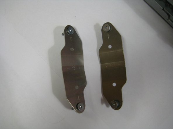

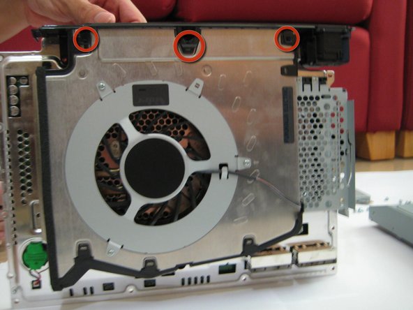

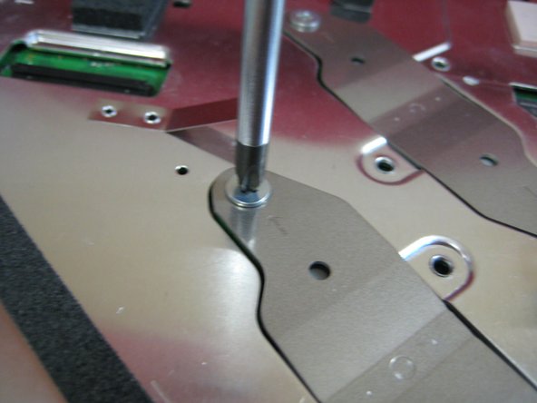

  • On the top of the mainboard, EVENLY remove the four large Philips #2 screws holding the heat sink.
    • Removing them evenly reduces strain on the GPU and CPU.
  • Remove the plates and the screws from the main board.

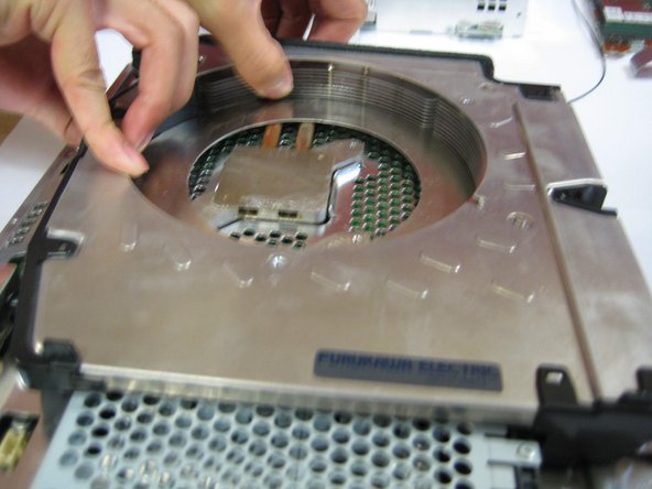

Add Note Edit Step 30  ¶
  • Flip the main board over.
  • Lift (or pry with fingers) the heat sink straight off of the mainboard and processors.
  • Force will be required as the thermal paste "glues" the heat sink to the processor.
  • Note: If new thermal paste is readily available, clean the old paste off well and apply new thermal paste at the time of reassembly. If new thermal paste is not available or you are cheap, do not disturb the "old" thermal paste.
Image #1 Image #2

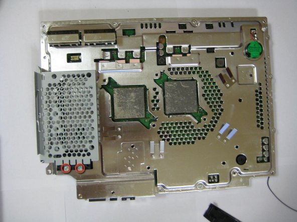

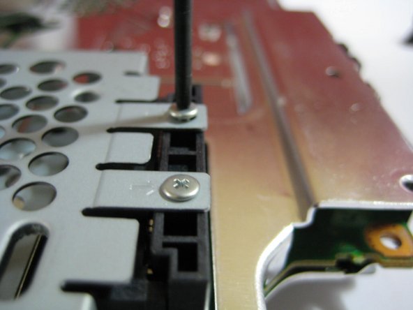

  • Remove the 2 Phillips #0 screws from the hard drive enclosure.

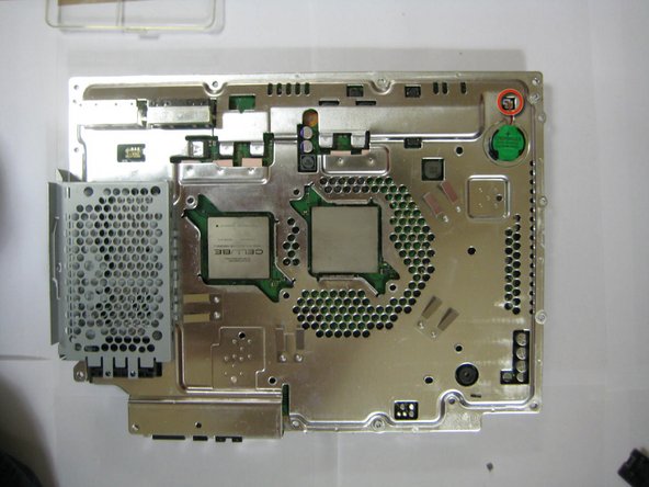

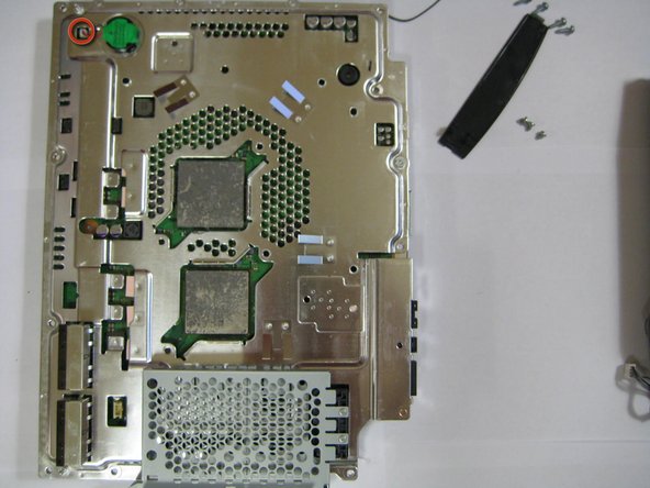

  • To expose the mainboard, remove the watch battery from the mainboard.

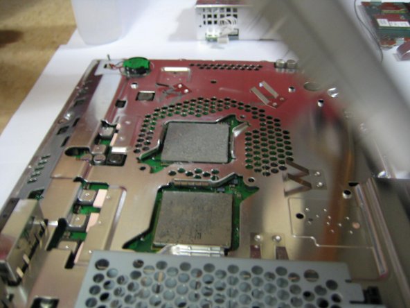

Add Note Edit Step 33  ¶
  • Using spudger, carefully pry the metal shielding away from and off of the top of motherboard.
Add Note Edit Step 34  ¶
  • Turn the motherboard over and remove the metal shielding on the opposite side. Pry with a spudger or with your fingers.
Image #1 Image #2

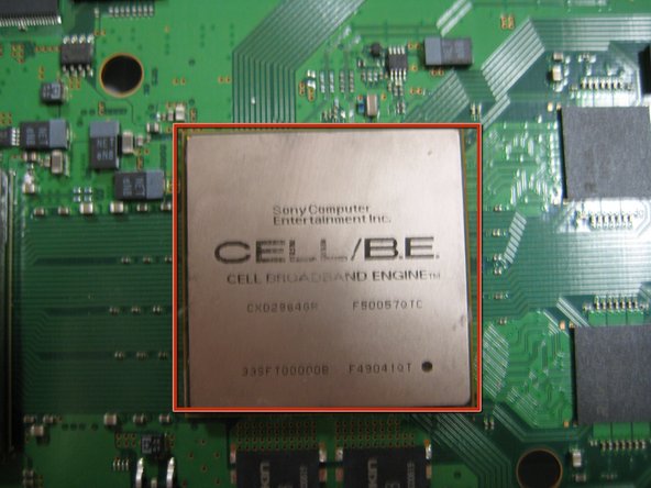

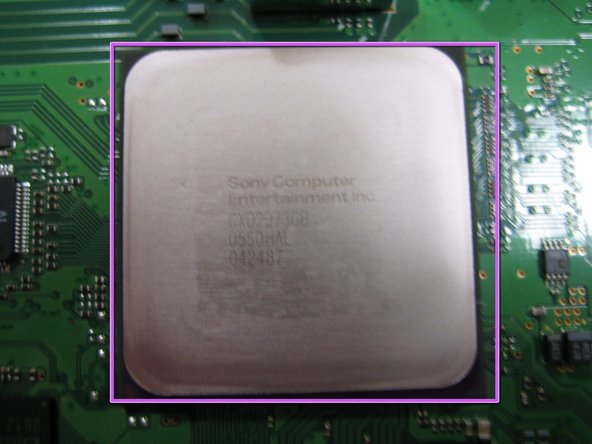

Add Note Edit Step 35  ¶
  • Check out all the chips with heatspreaders on this thing.
    • There's the Emotion Engine chip and Graphics Synthesis chip that allows the sweet backwards compatibility.
    • IBM Cell processor... This CPU has 9 cores, 10 threads and it runs @ 3.2GHz which makes it very powerful.

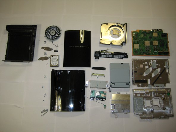

Add Note Edit Step 37  ¶
  • Consider your PS3 disassembled.
