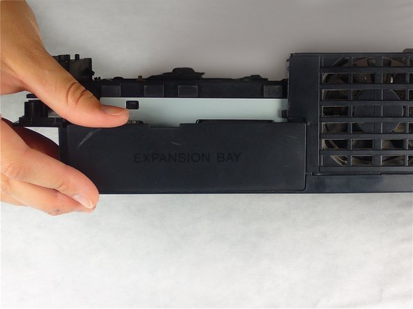

  • Remove the cover for the Expansion Bay.
    • If you utilize your expansion bay for its intended purpose, make sure you remove the component now.
  • Pull the inards out and away from the bottom cover.

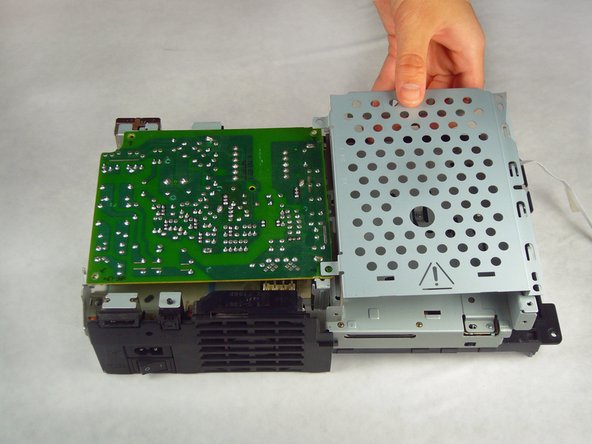

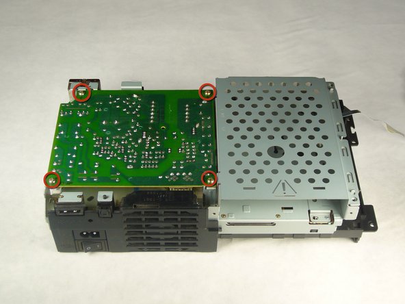

  • Let's begin by removing the four 7.6mm Phillips head gold screws holding on the power supply board.
Image #1 Image #2 Image #3

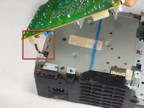

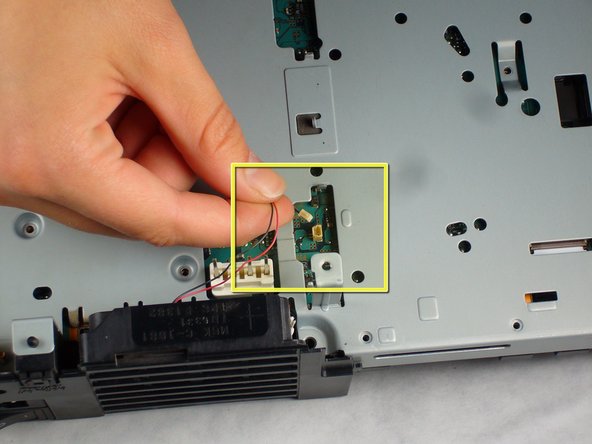

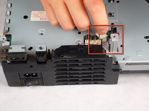

Add Note Edit Step 10  ¶

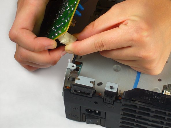

  • With the screws out of the way, the metal case that houses the expansion bay will lift off with ease.
  • There is one cable that is clipped onto the power board. It is located next to the main power switch.
    • Carefully begin lifting the power board. You can now see the clip holding the power board in place.
  • Unsnap the clip, and the board is free from the unit.
Image #1

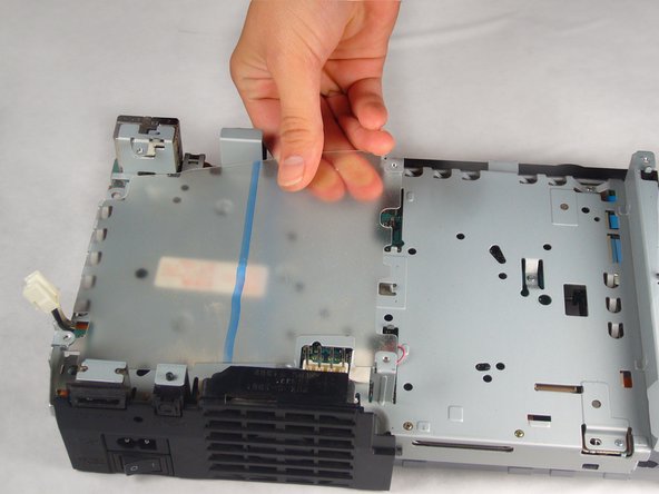

Add Note Edit Step 11  ¶
  • Underneath where the power supply once was is a transparent piece of plastic. This is the heat shield, and it can now be removed.
  • It can be a bit stubborn, so it may take a little finessing to get it free.
Image #1 Image #2

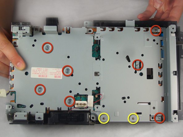

Add Note Edit Step 12  ¶
  • Now with the heat shield out of the way, you can see there are quite a few screws holding the rest in place.
  • First, remove the seven 5.8mm Phillips head silver screws.
  • Next, take out the two 7.4mm Phillips head gold screws.

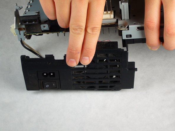

Add Note Edit Step 13  ¶
  • We can now remove the fan and main power switch assembly.
    • Remove the small white piece of tape that holds the wire connected to the fan.
    • Unplug the wire from the logic board.
    • The fan and switch are now free from the rest of the PS2. Simply remove it by pulling it out the bottom.

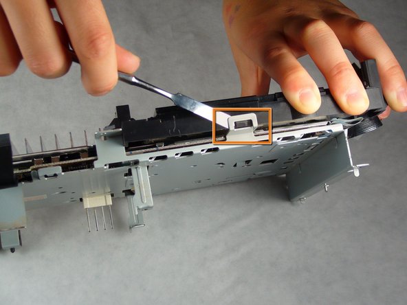

Add Note Edit Step 14  ¶

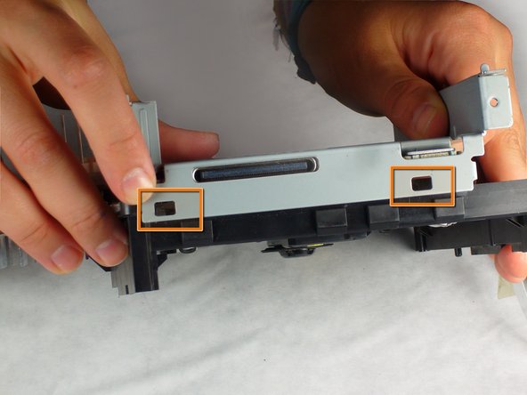

  • Unclip flaps, one on one side and two on the other, holding the disc drive together. The first two pictures display where the three flaps are. This is very tricky so take your time.
  • Carefully begin to lift out the disc drive. Beware, there are ribbon cables still attached.

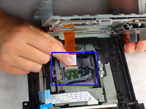

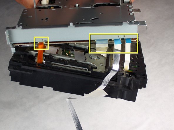

Add Note Edit Step 15  ¶

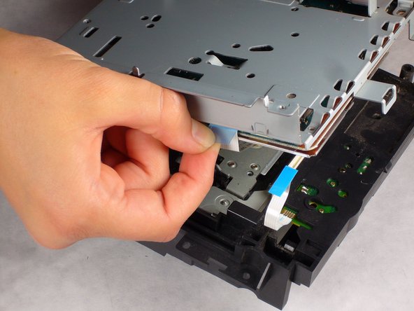

  • There are four ribbon cables attached to the disc drive. Be careful not to rip any of them!
    • Remove the three blue ribbon cables and one little orange cable by gently pulling on the blue plastic strips.
    • Carefully remove the orange ribbon cable from the laser by gently pulling on the white plastic strip.

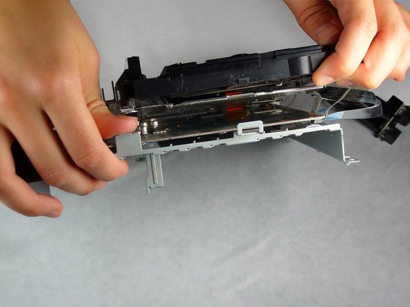

Add Note Edit Step 16  ¶

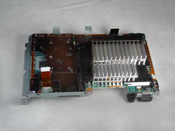

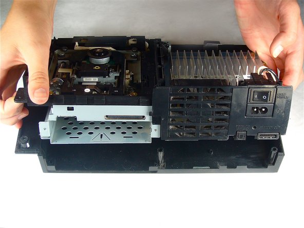

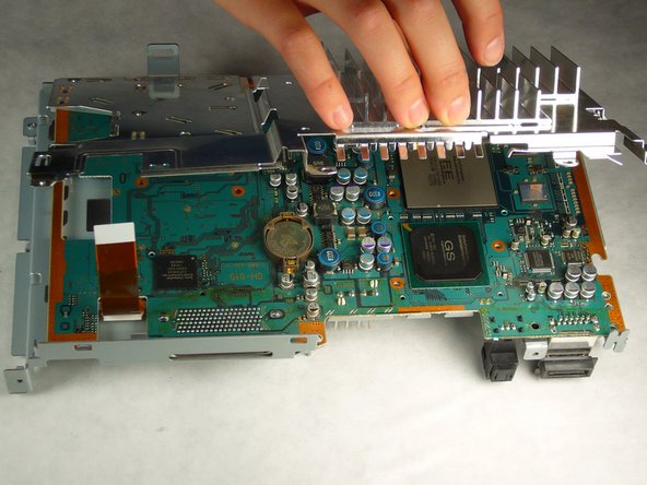

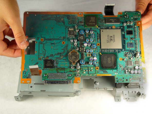

  • After the disc drive has been completely removed flip it over.
  • Gently lift off the metal cooling fins.
  • All that remains in view should be the logic board.
Image #1
Add Note Edit Step 17  ¶

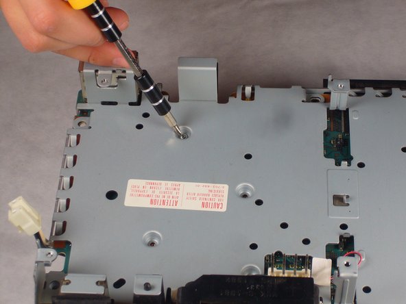

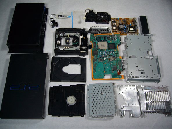

  • This is what your disassembly should look like when finished.
