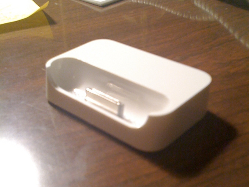

  • The Original iPhone dock!
  • This dock only holds the original iPhone. It will not hold the iPhone 3G/3GS as it is wider and thicker.

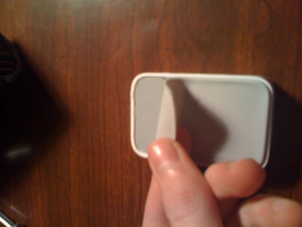

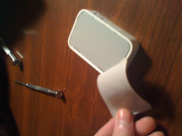

  • Use a hair dryer or heat gun to weaken the adhesive holding the rubber foot to the dock.
  • Use a razor blade or flathead screwdriver to pull up part of the rubber foot.
  • While still hot, pull the rubber foot off the dock.

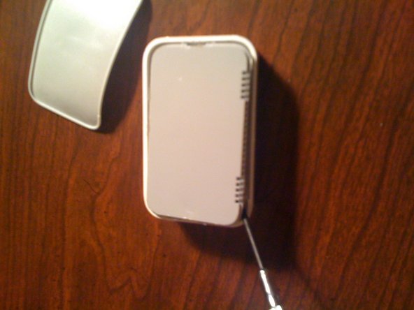

  • Using a spudger or a flat head screwdriver, release the 6 clips holding the dock to the white plastic molding.
  • You will need to pry this out as the dock contains a weight that is stuck to the top casing with adhesive.

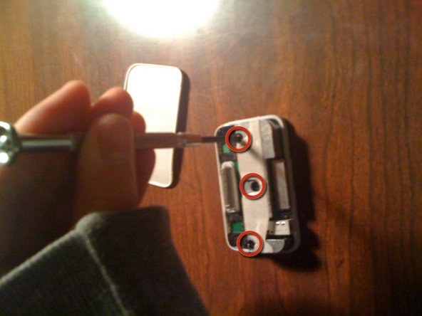

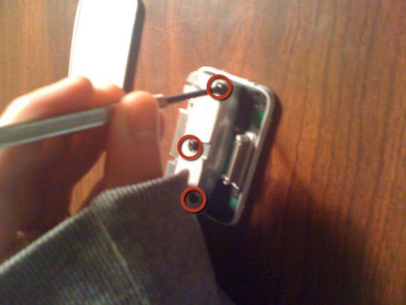

  • Heat up the adhesive that covers the three screws, so you can unscrew the screws that hold the weight in the base of the dock.
first image
thumb image 1
thumb image 2
thumb image 3

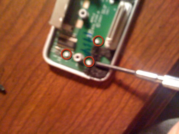

Add Note Edit Step 5  ¶

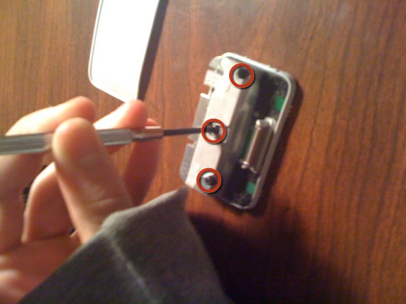

  • Remove the 3 screws holding the weight to the bottom plate.
first image

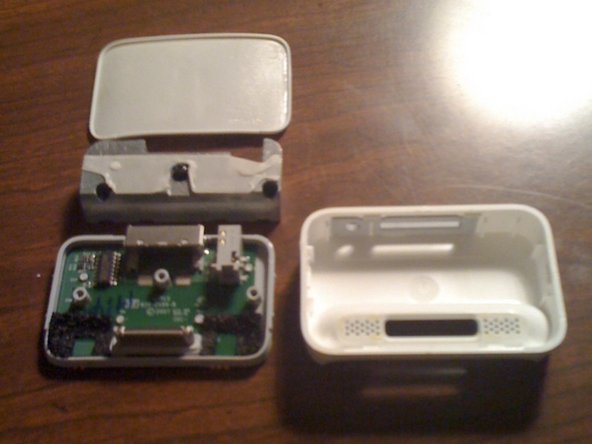

  • Once done separating the logic board from the bottom plate, you should have 2 parts.
first image
thumb image 1
thumb image 2
thumb image 3
Add Note Edit Step 10  ¶
  • Disassembly is now complete. You will have five separate parts as shown in the picture.
first image
thumb image 1
thumb image 2
thumb image 3
Add Note Edit Step 11  ¶
  • Boom! Your done. It took me 32 minutes to figure this out with out damaging the dock.
  • I can do it in 3 minutes now that I've mastered the process.

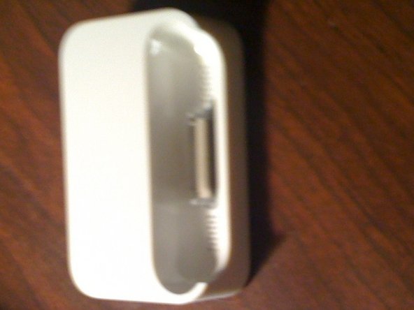

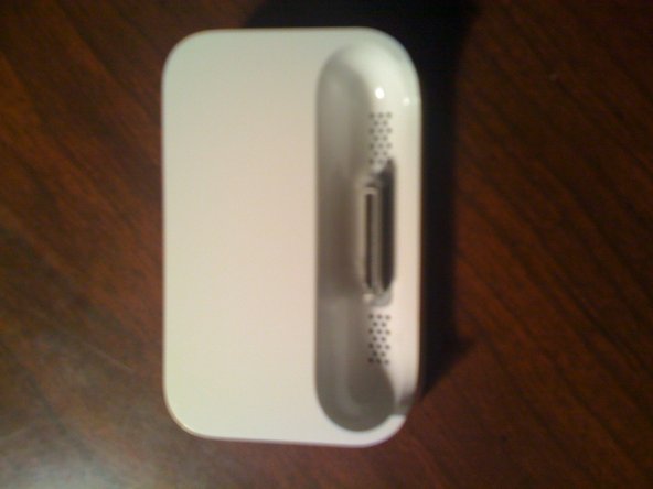

  • If you don't replace the white top cover of the dock when reassembling, you will have a universal dock, that can also be used with an iPhone 3G/3GS.
  • It will also work with any iPod with a 30 pin connector.
