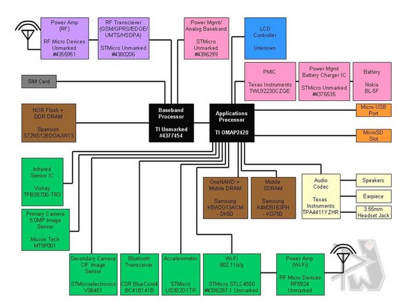

Overview of the Nokia N95 hardware with circuit diagrams and labeled chips. See www.phoneWreck.com for more detailed information on the Nokia N95 and other devices.

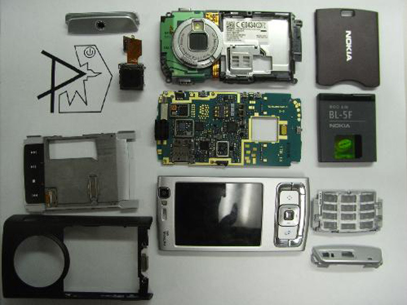

  • It should be noted that this model is the N95-1 with the expandable MicroSD card storage.
  • The N95 was a tough one to crack open since there were more mechanical parts than a traditional smartphone, with dual-sliding modes. This one was totally worth it though, as we were treated to a bevy of ICs, resistors, and the whole lot of circuitry.

  • It’s got three different memory units, one Spansion and two Samsungs, which we’ve made logical guesses as to which processor they served.
  • It runs an unmarked TI baseband processor and a TI OMAP2420 apps processor.
  • The dual processor makes for relatively complex circuitry, but the performance capabilities of the N95 really demonstrate the prowess of having an extra applications processor to do the dirty work.

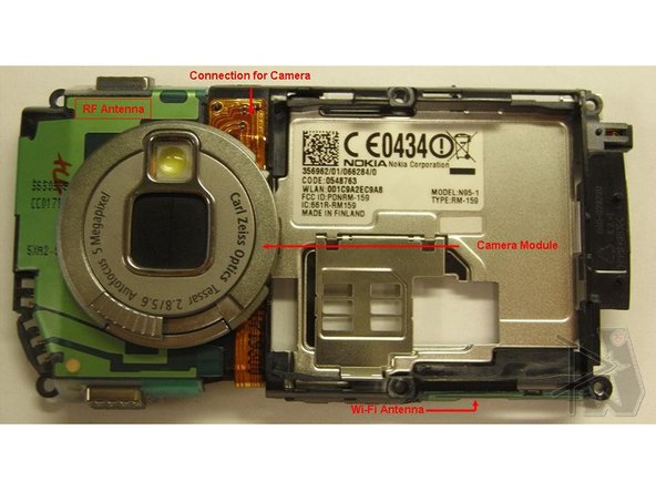

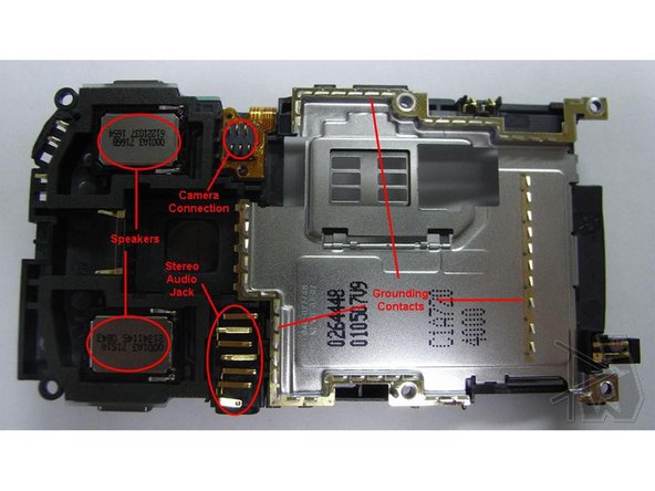

  • The back of the main PCB is shown below. The primary IC diagram can be found here.
  • The interesting thing about the N95 is that since the screen is on a separate mount, both sides of the PCB can be used. This, however, does cause the device to be a little bulkier than its candybar-form-factored friends.

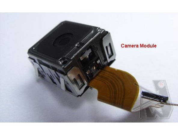

  • Finally, the camera module. This 5.0MP camera, with the image sensor developed by Micron Technologies, was the leading cameraphone back in the day, and its beastly size definitely attests to that.
  • For a full bill of materials and even more pictures, visit the Nokia N95 wiki page.
