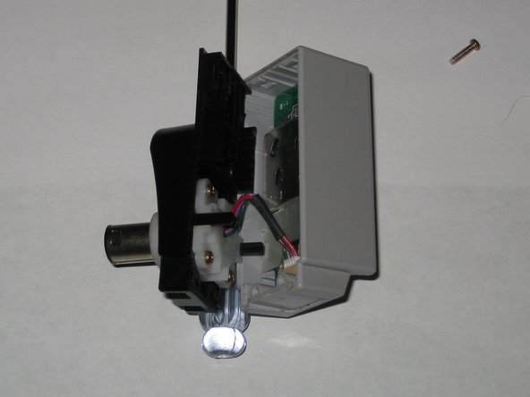

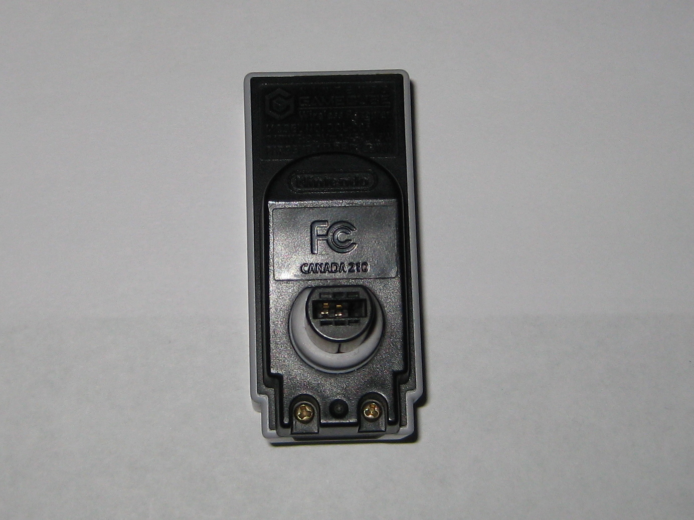

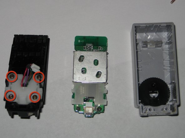

  • This is the connector side of the WaveBird receiver.
  • Remove two tri-wing screws, and separate the black and gray halves of the receiver.
Image #1 Image #2
Add Note Edit Step 2  ¶

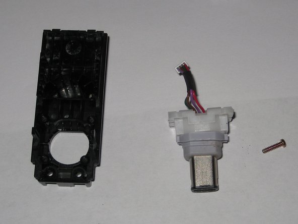

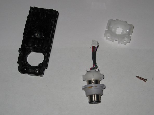

  • Remove four tri-wing screws to remove the connector from the housing.

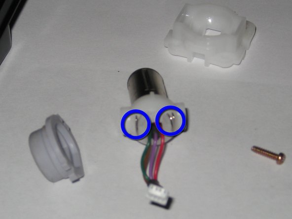

Add Note Edit Step 4 — Controller pinout  ¶
  • Red: 3.43V logic supply (pin 1 on cable)
  • Brown: Ground (pin 3 on cable)
  • Green: Data (pin 2 on cable, recessed by 2mm into connector)
  • Violet: Shield (pin 4 on cable)

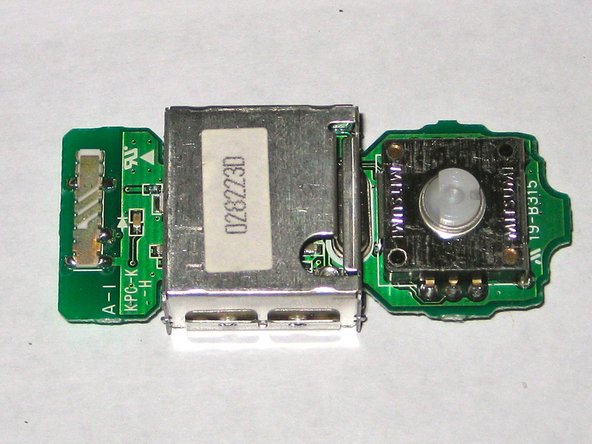

  • The PCB has a metal RF shield that protects the radio from interference from the game console; this extends the useful range of the controller.
  • One half of the shield is held on with friction clips; the other half must be desoldered.
Image #1
Add Note Edit Step 6  ¶
  • The IC is a custom (or relabeled) Nintendo chip marked "WCRX-DOL / T2.7488K1". ("Wireless Controller Receiver - Dolphin"). It is presumably a microcontroller that decodes signals from the radio and sends them to the console.
  • This 4-pin connector goes to the joypad connector on the GameCube.
  • Desolder these four points to remove the shield and expose the radio on the other side.
Image #1
Add Note Edit Step 7  ¶

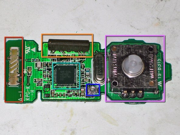

  • The bottom side has all the RF circuitry -- the chip is a Nintendo chip marked "WR-DOL / H2102 / CG2710 / 02", presumably the radio.
  • EPCOS X6882 custom bandpass filter
  • Trim-pot for adjustment at the factory -- could be a frequency tweak or gain adjustment.
  • The rotary switch allows the user to choose a frequency to avoid interference with other devices.
  • The antenna is mounted directly on the PCB, inside the device.
