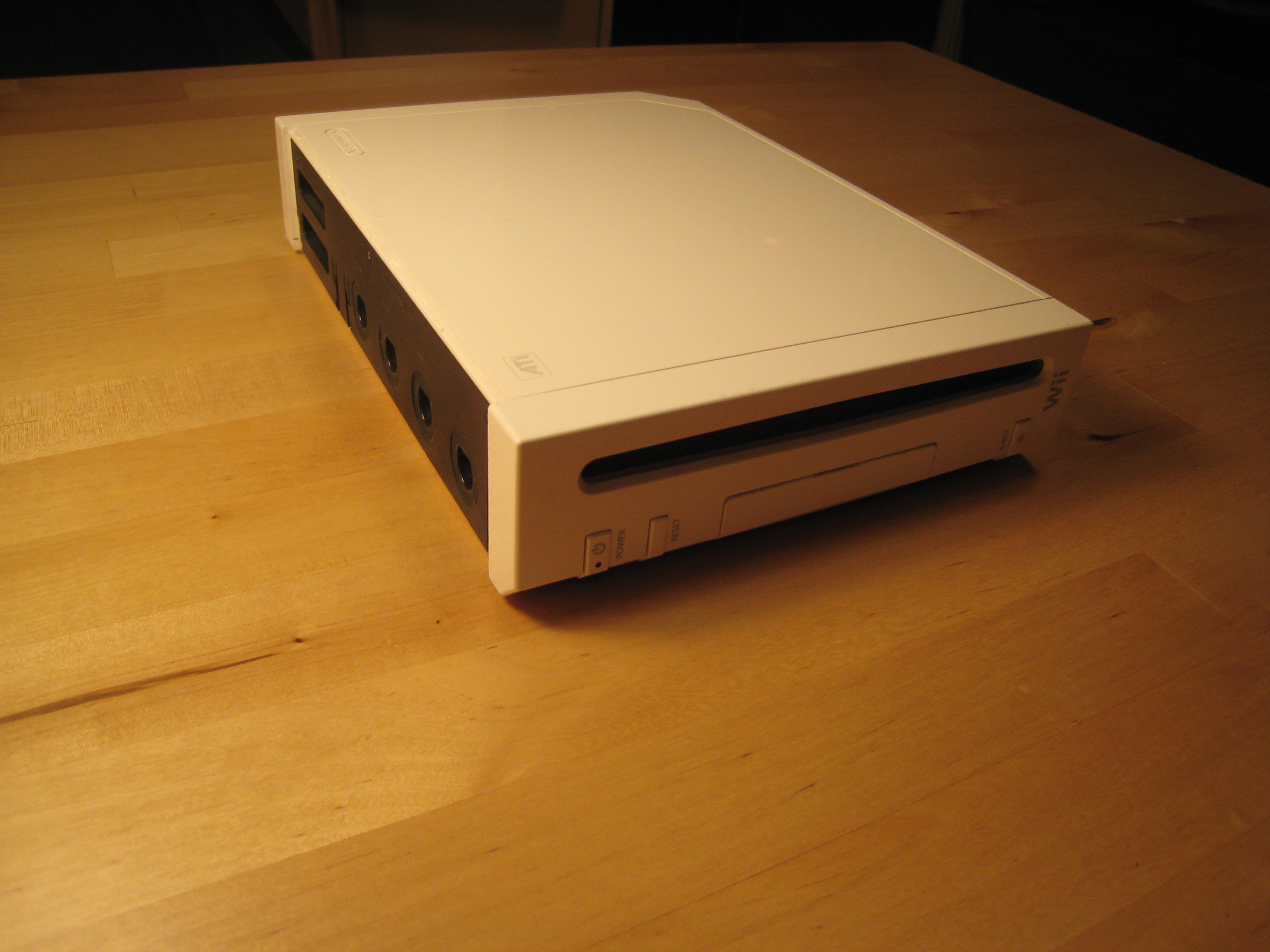

    • Disconnect all external cords from the Wii console.
    • Gather all tools.

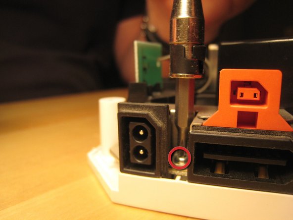

    • Remove these three black case screws. The one on the right is a few mm longer. These screws hold on the black plastic cover for the GameCube ports.
  4. Nintendo Wii Teardown: step 4, image 1 of 2 Nintendo Wii Teardown: step 4, image 2 of 2
    • Lift off the black plastic plate.
    • There are four screws: two Phillips #00 and two Tri-Wing.

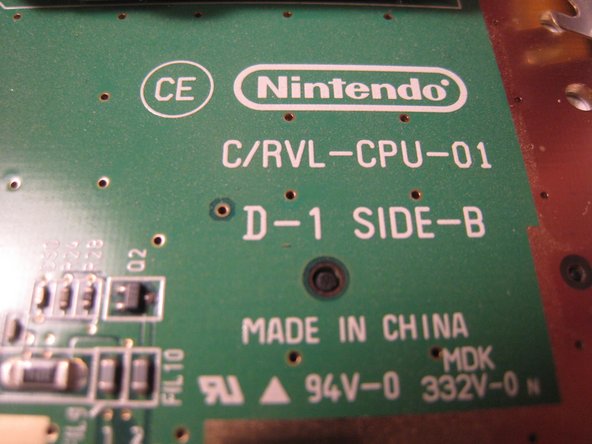

    • Once within the case, all screws are Phillips #00. There are marked on the logic board with arrows, triangles, boxes, and crosses. From what I can tell, an arrow means that it just goes through the logic board cover. A triangle means that it is a longer logic board cover screw. A cross means that it holds on a plastic piece, and a box means that it holds on another EM shield / or heat sink.

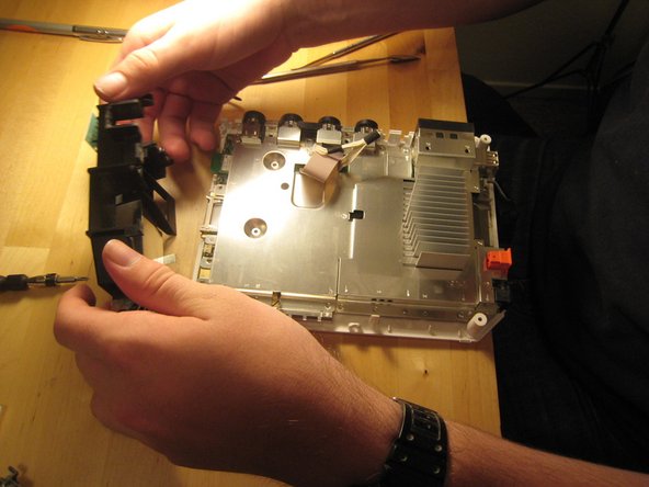

    • Take out these screws in the black plastic casing.

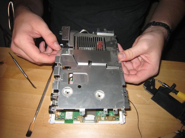

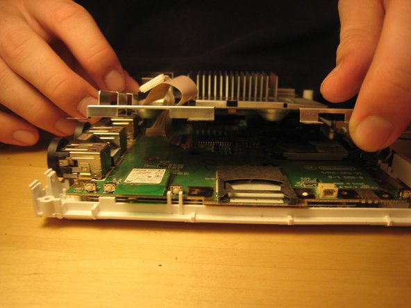

    • With the black plastic covers off, we can see all the screw holes. Most of the screws are out by now, but once the rest of them are out, you can lift off the logic board cover.
    • Note that at least one part is thermal padded to the logic board cover. You might have to replace this thermal pad, but I didn't. I just pushed them back together. Oh well!
    • Remove any remaining screws in the logic board cover.

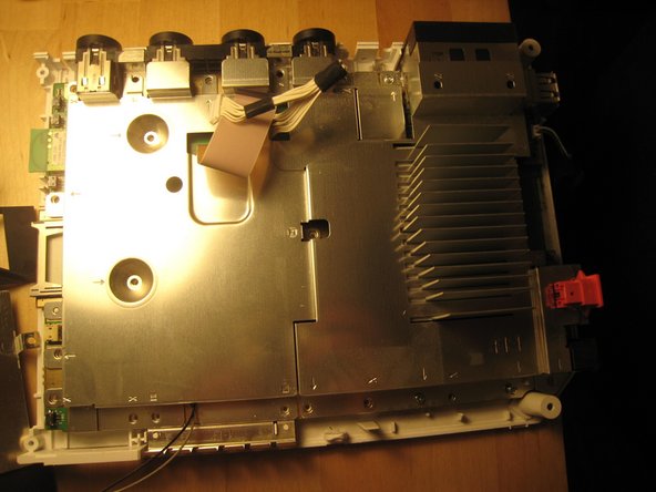

  18. Nintendo Wii Teardown: step 18, image 1 of 3 Nintendo Wii Teardown: step 18, image 2 of 3 Nintendo Wii Teardown: step 18, image 3 of 3

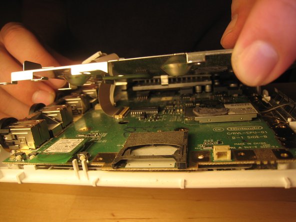

    • Once all screws are removed, lift off the logic board cover.

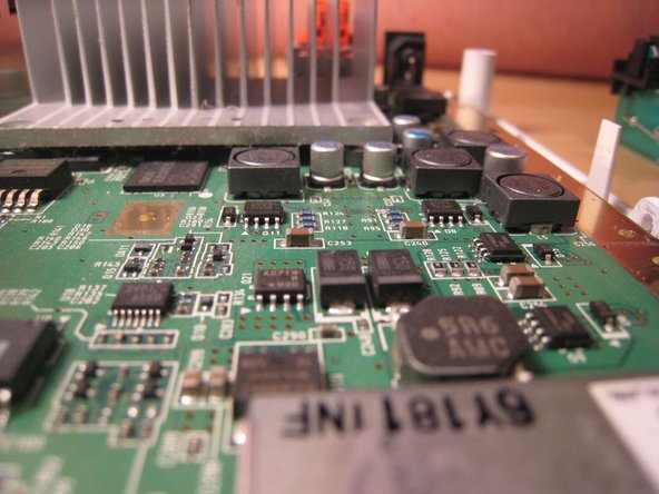

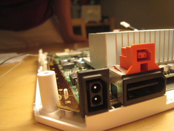

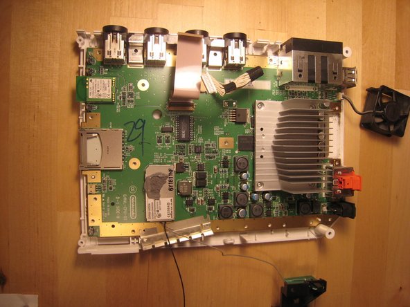

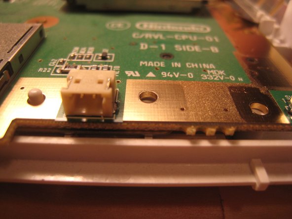

  19. Nintendo Wii Teardown: step 19, image 1 of 3 Nintendo Wii Teardown: step 19, image 2 of 3 Nintendo Wii Teardown: step 19, image 3 of 3

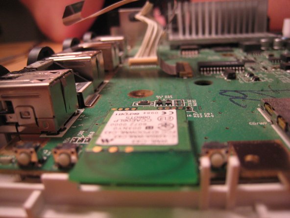

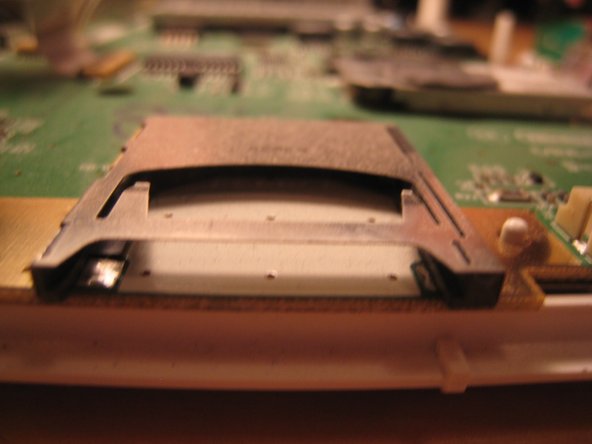

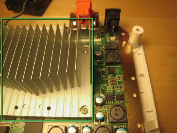

    • Look around.
    • This is the thermal padding.
    • We opted not to remove the heat sink from the logic board, but it certainly could be removed.

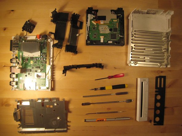

    • We stopped there.

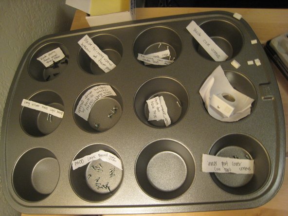

    • A muffin tin worked really well to organize all the screws.
    • Putting the Wii back together took only about half an hour, and it works perfectly. We improved Nintendo's design by three or four screws and one square nut, but worsened their design by one piece of duct tape (to hold in the bios battery).
