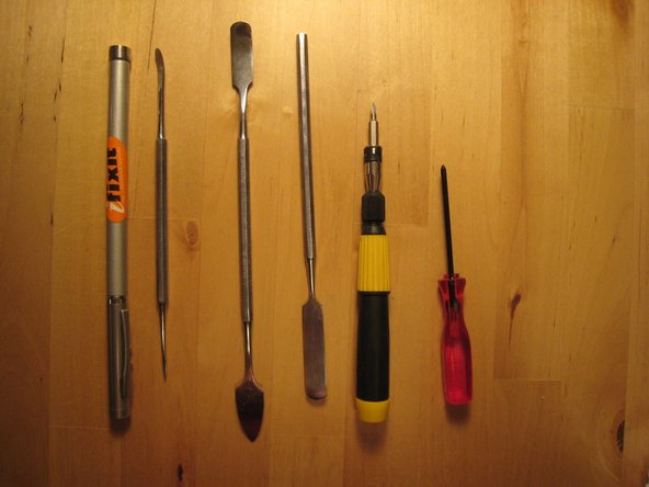

  • Disconnect all external cords from the Wii console.
  • Gather all tools.

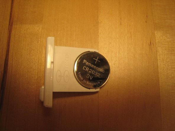

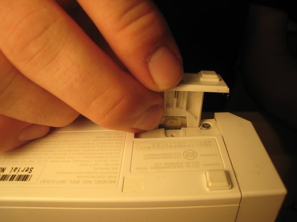

Add Note Edit Step 2  ¶
  • One small screw holds the BIOS memory battery.
  • Once that screw is removed, you can slide out the plastic slot.

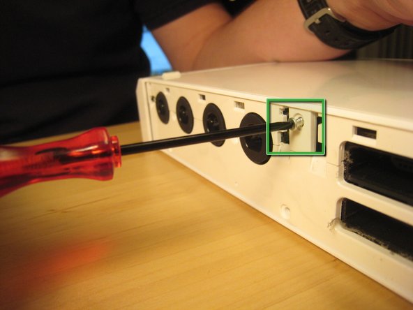

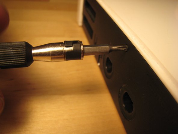

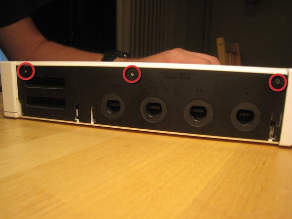

Add Note Edit Step 3  ¶
  • Remove these three black case screws. The one on the right is a few mm longer. These screws hold on the black plastic cover for the GameCube ports.
Image #1 Image #2

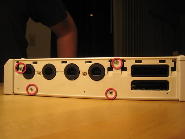

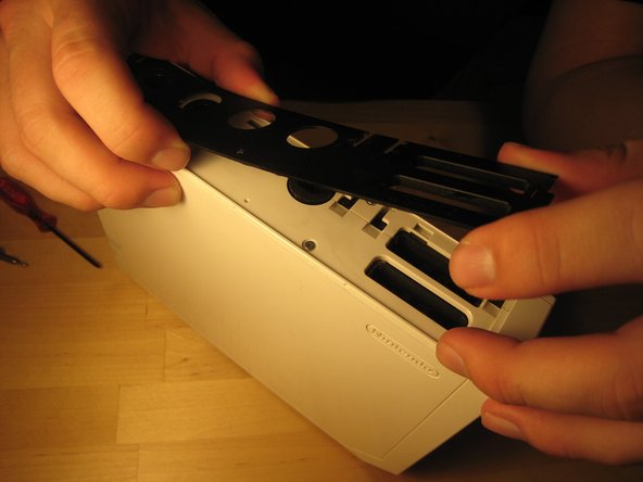

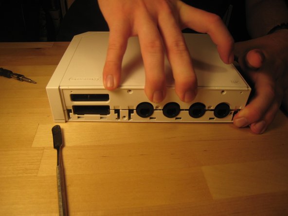

Add Note Edit Step 4  ¶
  • Lift off the black plastic plate.
  • There are four screws: two Phillips #00 and two Tri-Wing.

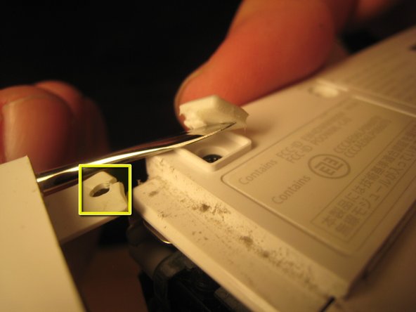

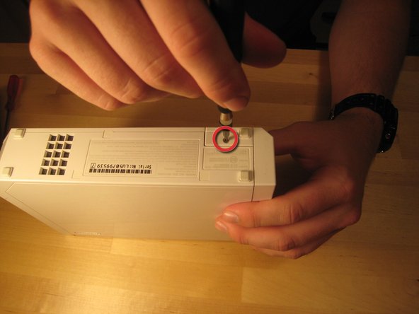

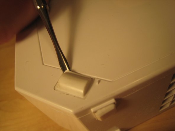

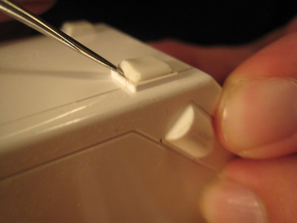

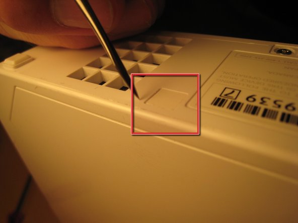

Add Note Edit Step 5  ¶
  • Remove all screws from the case.
    • Some screws are under rubber feet, or small, square paper screw covers (red square). I used a sharp metal tool to get under the screw covers. You could use an X-acto knife.
    • Several case screws require a Tri-Wing screwdriver.
  • The next step has more pictures of removing rubber feet and the screws underneath. The feet and screwcovers are self-adhesive, but not every foot or screwcover has a screw.

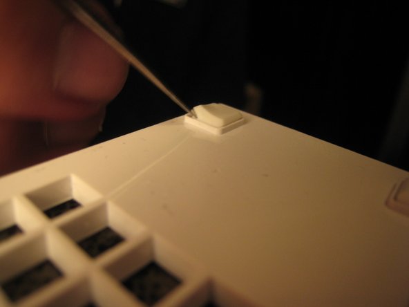

Image #1 Image #2 Image #3

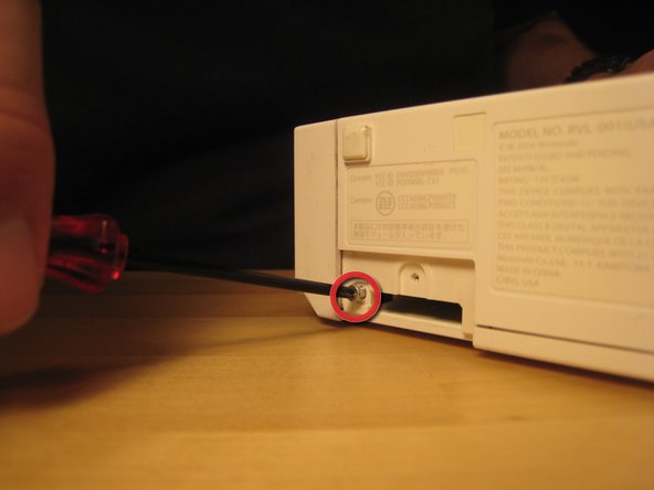

Add Note Edit Step 6  ¶
  • Remove rubber feet and screws underneath.

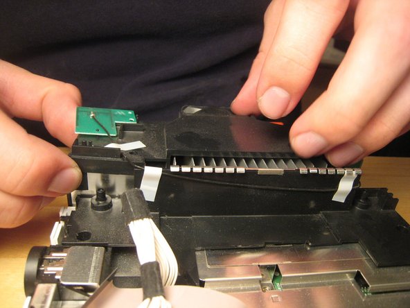

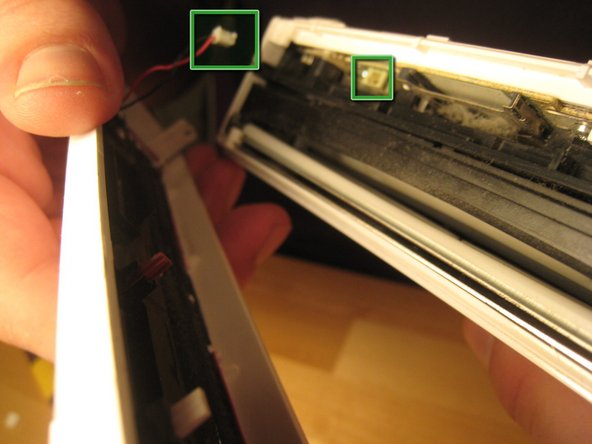

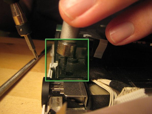

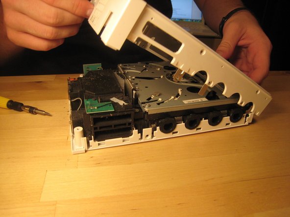

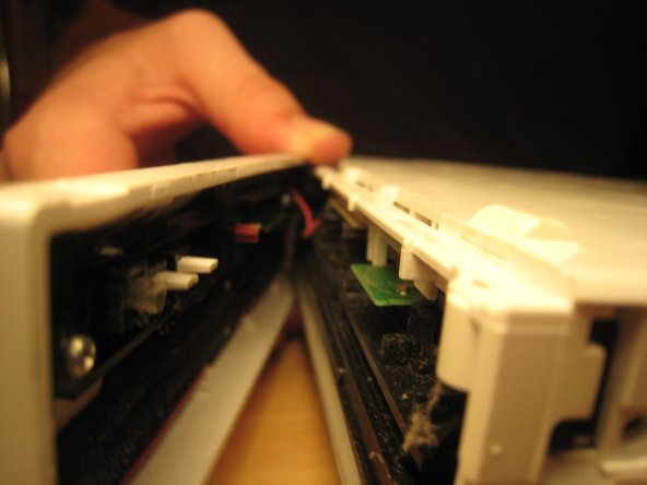

Add Note Edit Step 7  ¶
  • Careful! If you don't remove the feet and the screws underneath before you try to pull off the front panel, the tab can split!
  • Once all screws are removed, you should be able to pull off the front drive panel.
  • The wire connecting the front panel (green squares in the third image) can be pulled out gently by hand or with the help of a spudger.
Add Note Edit Step 8  ¶
  • Now the case can be pulled apart.

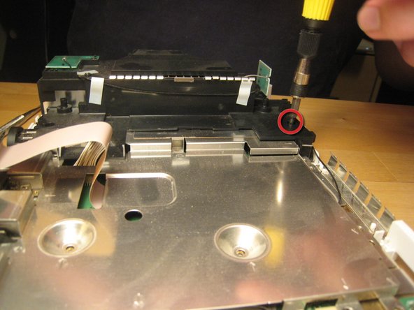

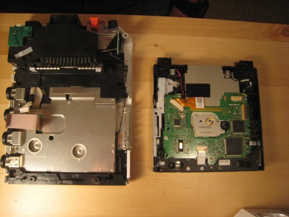

Add Note Edit Step 9  ¶
  • We lifted up the cover of the optical drive by removing the six Phillips #00 screws. These are all labeled on the previous image.
  • Because of a secured wire leading to the drive, we reattached the cover to facilitate the remove of the entire drive assembly without harming any of the electronics.
  • There are a ton of parts in the optical drive, but there is nothing very fancy about this drive compared to other slot-loading drives, so I didn't take it apart completely. There are also a ton of gears and levers that I did not want to deal with.

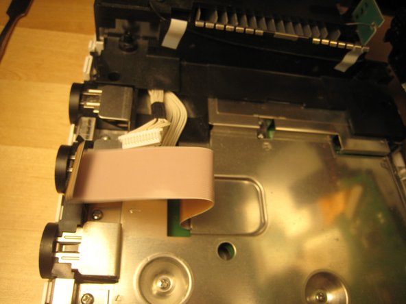

Add Note Edit Step 10  ¶
  • The screws holding in the drive were deep within the casing.
  • Once those screws were removed, the entire case could be lifted off.
  • Don't pull too hard! There are two cables attaching the drive to the logic board underneath.
  • This wire slid out from its horizontal slot. Once it was detached, the ribbon cable came out as well.

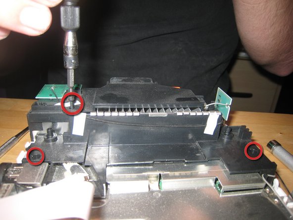

Add Note Edit Step 14  ¶
  • Take out these screws in the black plastic casing.

Required Tools
Phillips #00 Screwdriver
$4.95 · 50+ In stock
Spudger
$2.95 · 50+ In stock
Tri-wing Y1 Screwdriver
$9.95 · 50+ In stock
Magnetic Pickup Tool
