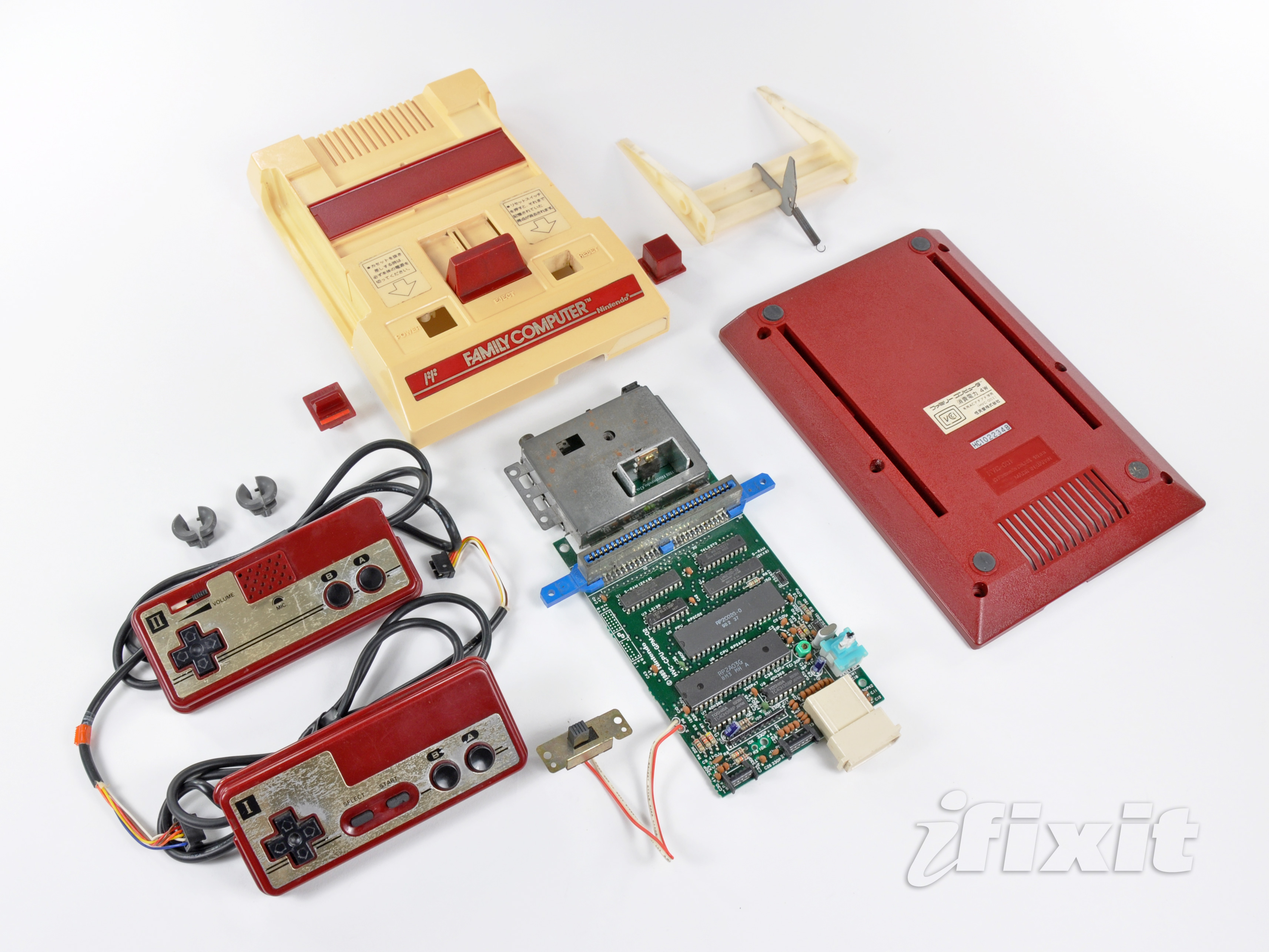

  • The Famicom's miniscule 4W power supply won't be popping fuses anytime soon.
    • That's about 2.5% of the power that the Xbox 360 devours.
  • Nintendo Famicom model number HVC-001, Made in Japan. We wouldn't want our Famicom any other way.
Image #1 Image #2
Add Note Edit Step 5  ¶
  • A quick removal of six Phillips screws and the bottom cover lifts right off.
  • Just like the earlier retro consoles, Fami is super-easy to disassemble.
  • (yes, we named him Fami.)

  • Six Phillips screws secure the motherboard assembly to the outer case.
  • Lifting the assembly out of the case gives us a good look at the archaic silicon that makes this thing tick.
  • Two more Phillips screws secure the hefty power switch to the outer case.
Image #1 Image #2
Add Note Edit Step 8  ¶
  • Notable chips on the board include:
    • Ricoh RP2A03G 8-bit, 1.79 MHz CPU
    • Ricoh RP2C02G-0 8-bit, 5.32 MHz PPU
    • Toshiba TC40H368P hex bus buffers
    • Sharp LH5216D-12 static RAM
    • Hitachi HD74LS139P decoder/demultiplexer
    • Fujitsu MB74LS373
  • Unsurprisingly, lead solder abounds on the bottom of the board. RoHS standards weren't established until 20 years after this puppy was made.

  • After the motherboard assembly is out, the reset and power button covers can easily be removed.
  • Unclipping a spring is all that's needed to remove the eject mechanism from the outer case.
    • Ejecting a cartridge is accomplished by pushing two inclined planes underneath the cartridge until it pops up off the connector attached to the board.
Image #1 Image #2 Image #3
Add Note Edit Step 11  ¶
  • Breaking Gently releasing the retaining clips holding the cartridge together reveals a 60 pin printed circuit board.
  • Front and back sides of the Famicom cartridges:
    • This PCB from a Tennis cartridge has two ROM packages -- totaling 24 KB -- soldered to one side.
    • For comparison, a single layer Blu-ray disc has a 25,000,000 KB capacity.
