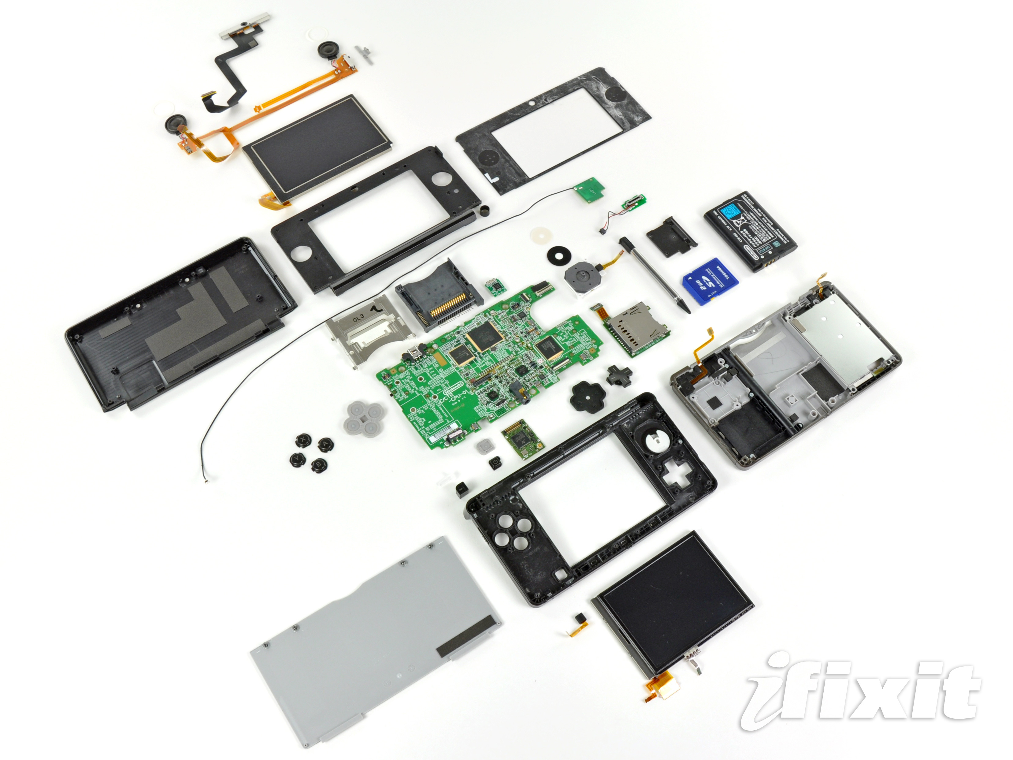

  9. Nintendo 3DS Teardown: step 9, image 1 of 2 Nintendo 3DS Teardown: step 9, image 2 of 2
    • A few Phillips screws are removed with our trusty 54-piece bit kit, and the lower case lifts right off.
    • With the lower case off, we get a good look at the motherboard and its many attached components. Having items like the joystick and SD card reader on separate boards makes their replacement less costly if they are to break in the future.
  10. Nintendo 3DS Teardown: step 10, image 1 of 3 Nintendo 3DS Teardown: step 10, image 2 of 3 Nintendo 3DS Teardown: step 10, image 3 of 3
    • The Wi-Fi board can easily be removed from the motherboard with a plastic opening tool.
    • After disconnecting its singular antenna, it is free from the 3DS.
    • The back of the board has a sticker labeled Mitsumi DWM-W028, but at its heart lies an Atheros AR6014 IC for 802.11 b/g connectivity.

  13. Nintendo 3DS Teardown: step 13, image 1 of 2 Nintendo 3DS Teardown: step 13, image 2 of 2
    • Removing the remaining pesky screws securing the motherboard to the lower case.
    • Motherboard almost out...this looks kinda familiar...
  14. Nintendo 3DS Teardown: step 14, image 1 of 1
    • Chips we've found inside the 3DS motherboard (click here for high-res version):
    • Nintendo 1048 0H ARM CPU
    • Fujitsu MB82M8080-07L 128MB FC-RAM
    • Toshiba THGBM2G3P1FBAI8 2 GB NAND Flash
    • Texas Instruments PAIC3010B 0AA37DW
    • UC CTR 041KM73 KG10
    • Invensense ITG-3270 MEMS Gyroscope
    • ST Micro 2048 33DH X1MAQ Accelerometer Model LIS331DH

  22. Nintendo 3DS Teardown: step 22, image 1 of 2 Nintendo 3DS Teardown: step 22, image 2 of 2
    • Nintendo 3DS Repairability Score: 5 out of 10 (10 is easiest to repair)
    • The battery is easily swappable by removing the back cover.
    • No proprietary Tri-Wing screws were used, just Phillips #00.
    • The top display's cables are routed in such a way that it makes them quite frustrating to remove without ripping them off, and just as difficult to re-seat properly during device reassembly.
    • There's tons of little components inside the 3DS, which may potentially cause problems if you happen to lose one while performing a repair.
    • The majority of connectors are ZIF, and it's difficult to ensure each one is connected properly without reassembling the whole thing and starting up the device.
    • The headphone jack and charging connector are soldered to the motherboard, meaning you need to take out your soldering iron if you accidentally break them.
