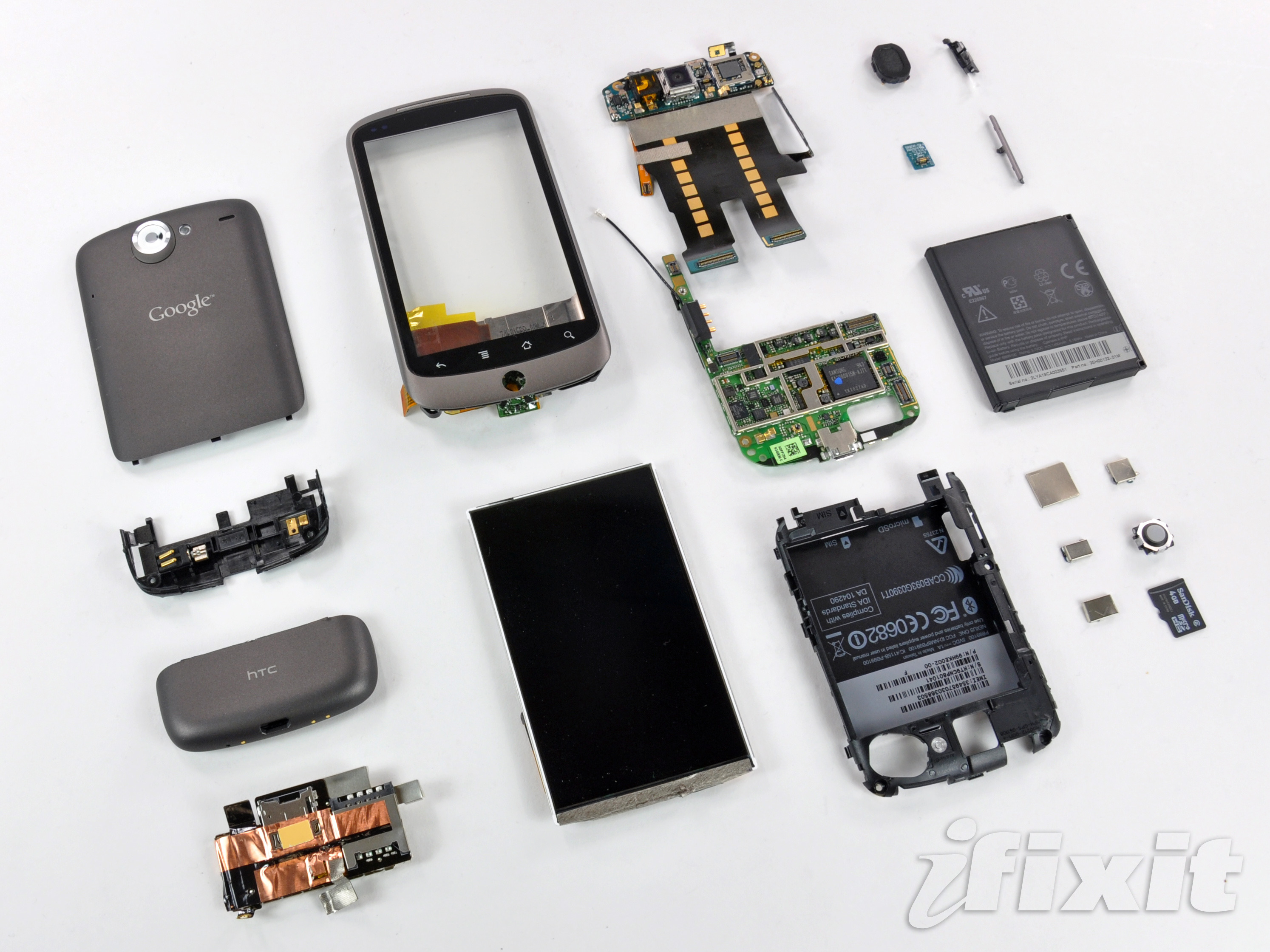

Well, we went for it. After forking out a bank-account-devastating $530, we have the Superphone in hand! Keep your eyes peeled as we tear this baby apart.
After all was said and done, we made a video slideshow of it as well. Enjoy!

  • The unbelievably easy task of removing the plastic rear cover gives access to the replaceable battery. Hey Apple, take notes!
  • Inside the battery compartment you can see:
    • The 5MP camera lens
    • LED flash bulb
    • External speaker
    • The warranty-killing VOID sticker
Image #1 Image #2 Image #3
Add Note Edit Step 4  ¶
  • Warranty = VOID. No turning back now.
  • This phone is very nicely put together. After removing three screws and prying with a plastic opening tool, the battery tray comes right out.
Image #1
Add Note Edit Step 5  ¶
  • The upper circuit board is held in place by another Phillips screw.
  • After removing the screw, maneuver the upper board past the two metal clips holding it in place and lift it out of the phone body.
  • The large black-coated foil section is the data connection between the two main circuit boards.
Image #1 Image #2
Add Note Edit Step 6  ¶
  • After some trying moments with a few tools of destruction, we figured out the bottom cover can simply be popped off with a plastic opening tool.
  • Guess what? We found more screws.
  • This phone uses many foil antennas attached to the several plastic internal frame pieces.
Add Note Edit Step 7  ¶
  • With a quick pry of the plastic opening tool, we found that the black plastic frame slightly envelops the lower side of the logic board.
  • And just like that, the plastic frame snaps off, revealing the lower logic board.
  • It's quite a colorful phone on the inside. We've got oranges, greens, yellows, dark grays, and all sorts of fun stuff!
Add Note Edit Step 8  ¶
  • We had to take care of one more Phillips screw.
  • After that, the logic board assembly slowly-but-surely slid out from the rest of the phone.
