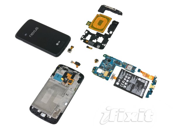

After liberating the two T5 Torx screws from their imprisonment, it took a few minutes of diligent work with a plastic opening tool to remove the back cover.
It wasn't particularly difficult to open this device, but anyone attempting it without the proper prying tool will face a lot of frustration.
Right off the bat we notice that the battery is much harder to replace than in the earlier Galaxy Nexus. This could hurt its repairability score, but it's still early!
The rear cover of most phones is a ho-hum piece of plastic that serves no real purpose other than covering the battery. That is not the case here.
A number of pressure contacts power the NFC antenna and connect the induction coil needed for wireless charging to the motherboard.
With "wireless charging" listed as an official tech spec for the Nexus 4, we were anxious to try it out on our device. Alas, the phone doesn't ship with a wireless charger. Boo.
Two years ago, Google brought NFC to the smartphone realm with the Nexus S. It's been a long road, but the technology seems to finally be catching on.
Eventually, we're able to pull out the 3.8 V, 2100 mAh battery.
Just like Apple did with the iPhone 5, LG is utilizing a 3.8 V battery to power the Nexus 4.
Strangely enough, Google doesn't list any specifications for the battery on their product page. We'll have to rely on real-world tests to see what kind of battery life users can expect to achieve.
Tool used on this step:Magnetic Project Mat$19.95
Next up is the obtrusive plastic frame covering the motherboard.
With the frame screws removed, the Nexus 4 is officially screw-less. That brings us to a total of only 4 different screw lengths, and 15 screws in total. Here's how they break down on our Magnetic Project Mat.
In addition to providing some support and stability, this frame houses the earpiece speaker and vibrator motor, both of which attach to the motherboard via pressure contacts.
The Nexus 4 uses a linear-oscillating vibrator motor as opposed to the counterweighted rotational vibrator in the iPhone 5.
