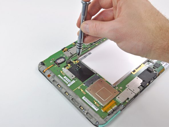

    • At first glance, this appears to be a Wi-Fi board, but wait: there are no chips on it!
    • It appears to be just a mini-PCI interconnect board for the antennas.
    • This board is probably just a place holder for when the 4G upgrade becomes available.

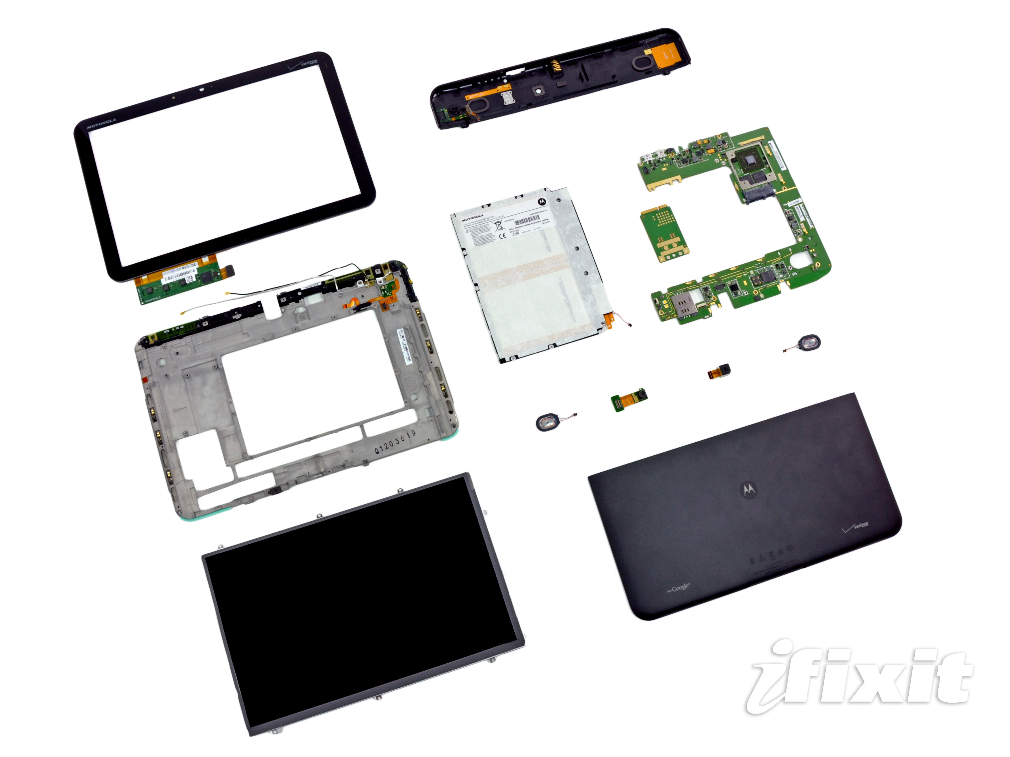

    • Motorola Xoom tablet Repairability Score: 8 out of 10 (10 is easiest to repair)
    • There's no proprietary screws or fasteners in the machine -- everything comes out with a spudger and a couple of Torx screwdrivers.
    • LCD and front panel glass are not fused together. That's great news for folks unfortunate enough to drop their Xooms and crack their glass.
    • Individual components (like the cameras) are separately attached to the motherboard, allowing each component to be replaced on an individual basis.
    • By our count, there are 57 screws in the Xoom, of either the T5 or T6 Torx variety.
    • Everything is accessible but somewhat inconvenient to repair -- there's just a lot of labor involved with removing that many screws.
