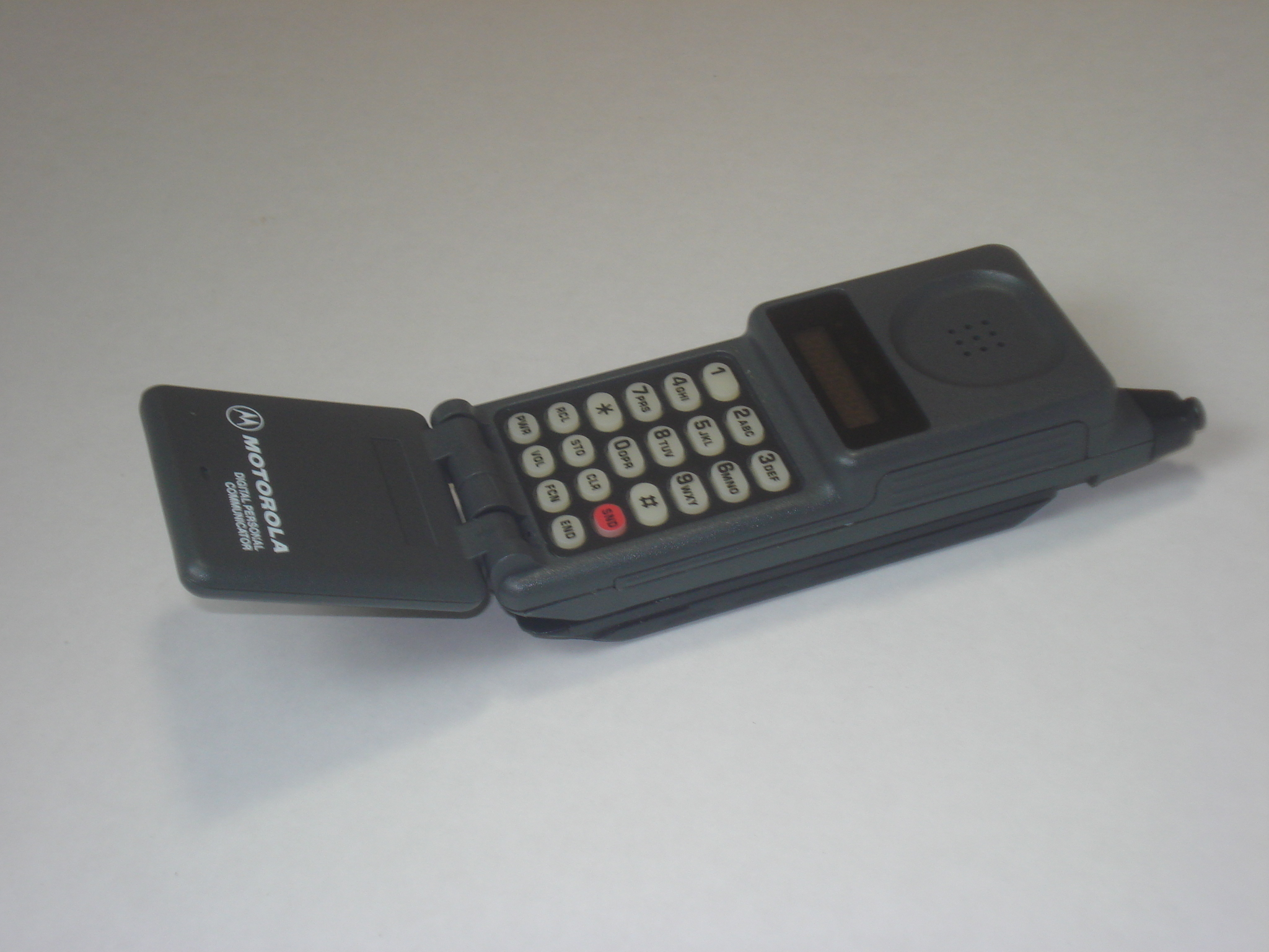

Image #1
Add Note Edit Step 1 — Motorola California Mobile Phone Teardown  ¶
  • Remove the battery by sliding it down the rails to which it is connected.
Image #1
Add Note Edit Step 2  ¶
  • Find a flat head or Phillips head screwdriver.
  • Insert the screwdriver into the holes in the plastic rod connecting the key pad guard to the rear casing.
  • Use the screwdriver to push the rods towards each other until they click out of their locked position.
  • Note: This may require a large amount of force.
Image #1
Add Note Edit Step 3  ¶
  • Slide off the antenna guard and locate the four clips on the exterior of the rear casing.
  • Simultaneously push the clips outward while lifting the rear casing and keyguard away from the front casing.
  • Remove the key guard from the rear casing by taking it out of its position.

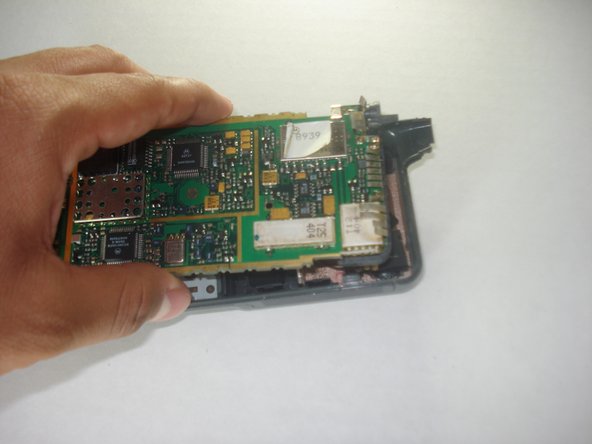

Image #1
Add Note Edit Step 6  ¶
  • Lift the motherboard out of its location in the front casing.
  • Do this slowly and gently so that none of the motherboard's components are damaged.
