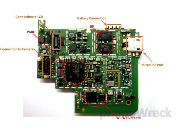

  • Lastly, pry away the black frame that surrounds the keyboad of the device. This will unveil the sliding mechanism.
Image #1 Image #2 Image #3
Add Note Edit Step 10  ¶
  • We removed the Cans (not a recommended step!!!) to see what IC's were on the board.
    • Check out the Block Diagram for full details!
