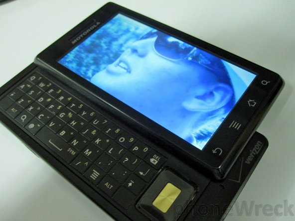

Dr.Wreck has finally worked up the courage to tear apart his Brand New Motorola Droid! What's inside?! Keep it locked to PhoneWreck to see the details as they arrive!
This user-contributed teardown is in response to iFixit's Droid bounty offer.
Image #1 Image #2 Image #3
Add Note Edit Step 1 — Motorola Droid Teardown  ¶
  • Thar she blows! Keep it locked on iFixit and PhoneWreck to see all of the details as they become available!

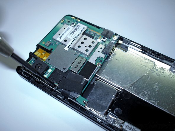

Add Note Edit Step 4  ¶
  • Finding the rest of the fasteners is a royal pain...
    • Did you think to look under the lens cover and google label? Probably not... you should! There's a T5 under there!
      • Try not to mind Dr. Wreck's massive toe thumbs...

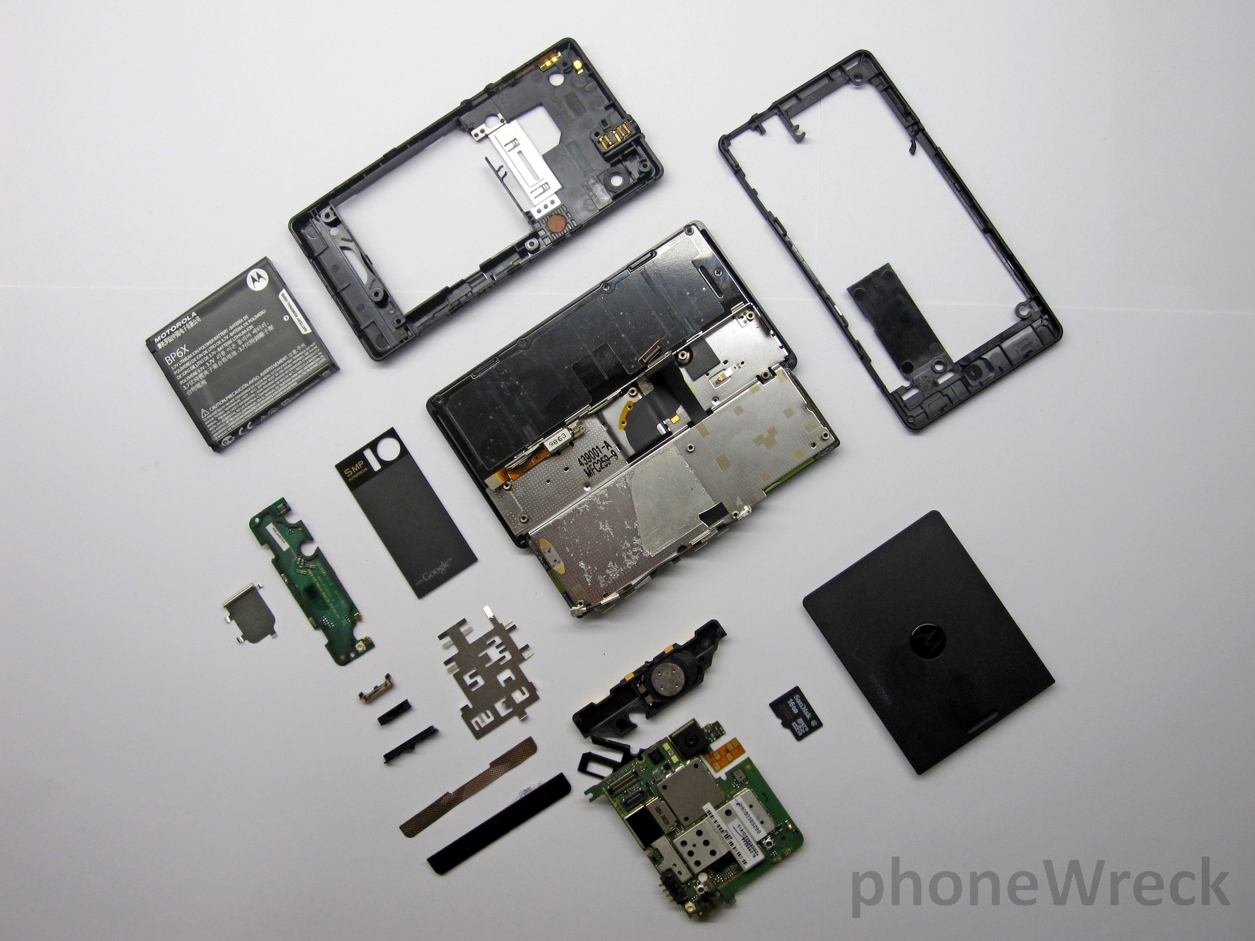

Add Note Edit Step 6  ¶
  • With these screws removed, you can pry away the back part of the chassis.
    • Use a wedge and work it carefully around the outside of the frame.

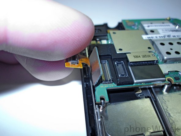

Add Note Edit Step 7  ¶
  • There it is!
    • Use the T5 to remove the last silver PCB screw.
    • Pull off the flex cables that fast the top of the logic board to the screen portion.
Image #1
Add Note Edit Step 8  ¶
  • Now you can flip out the PCB.
    • Remove the flex off of the bottom of the PCB to free it.
