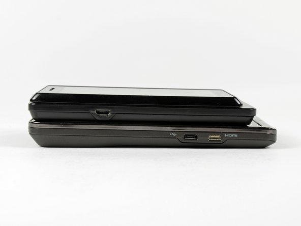

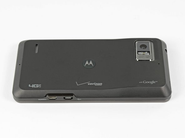

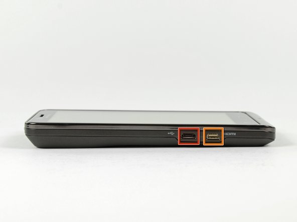

  • The Bionic features two ports on its left side:
    • micro-USB
    • micro-HDMI
  • Verizon advertises the Bionic as the slimmest 4G LTE phone at 0.43 inches thick.
    • We find that the little hump towards the top of the device actually adds to the advertised 0.43" thickness (or thin-ness), making the phone 0.52" at its fattest point.
  • In comparison to the Motorola Droid, the Bionic is definitely thinner and lighter (158 to 169 grams), but also longer and wider.

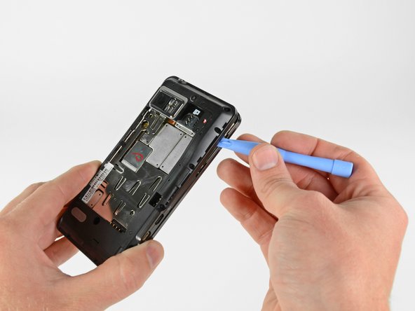

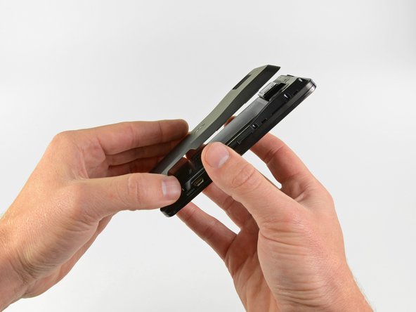

  • The Droid Bionic turns around to give us a peek at its logo-filled back side, including the long-awaited 4G LTE logo.
  • Our eager hands cannot wait to get inside this behemoth bionic-being as we remove the back cover with relative ease. An opening tool comes in handy here, but you can also use your fingers.
  • Our first look inside the Bionic gives us a view of the 16 GB microSD card, the 4G LTE SIM card, and the Li-Ion 1735 mAh battery.

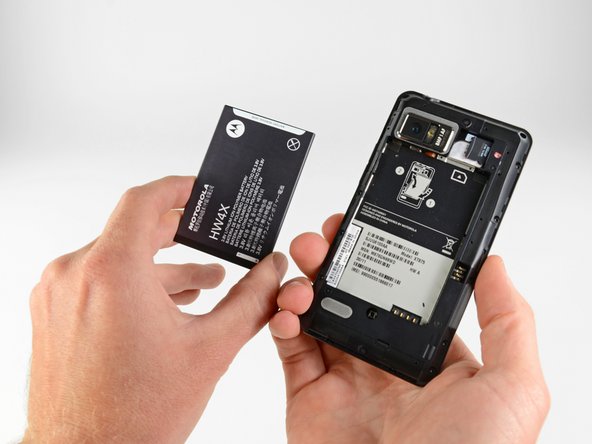

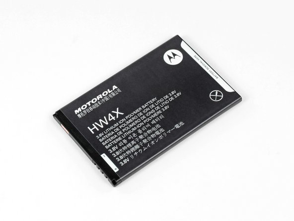

  • To our pleasure as DIY-ers, the battery is easily removable and therefore replaceable.
  • The Bionic's battery boasts nearly 11 hours of continuous talk time and over 240 hours of standby time.

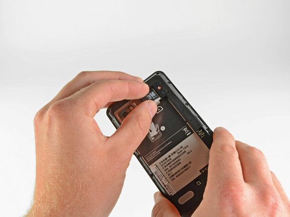

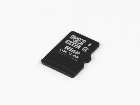

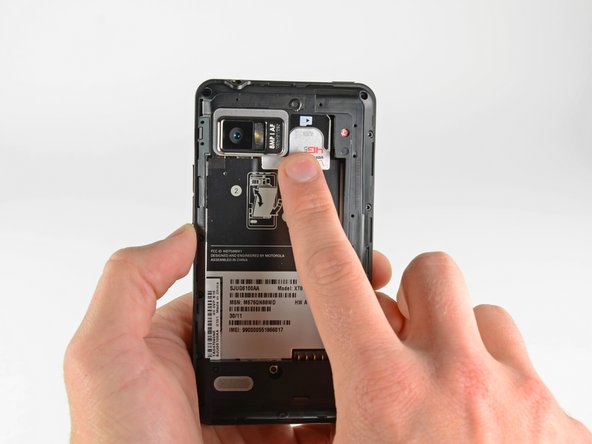

  • Next, we enjoy the pleasure of removing the 16 GB microSD card generously included with the purchase of a Motorola Droid Bionic.
    • CAUTION: Keep this card away from small children and hungry adults. It's easily swallowed, but contains nothing of value to our digestive systems.
  • The Bionic comes with 16 GB internal flash memory and a 16 GB microSD card (with the option to swap in a 32 GB microSD) for a grand total of 32 GB of included storage, or 48 GB expanded storage.
Image #1 Image #2
Add Note Edit Step 6  ¶

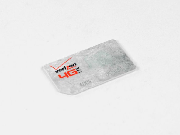

  • We've found the elusive 4G LTE SIM card! Hidden beneath the microSD card, the 4G LTE SIM card sits... and waits.
  • The Verizon LTE network sure is impressive, but high costs of tiered data plans have left many folks wondering if the price of the service is worth the hype.

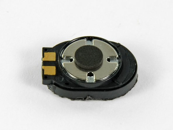

  • We remove the loudspeaker from the otherwise unexciting rear case, a speaker ideal for proclaiming the characteristic Drooooooiiiiid upon powering on the phone.

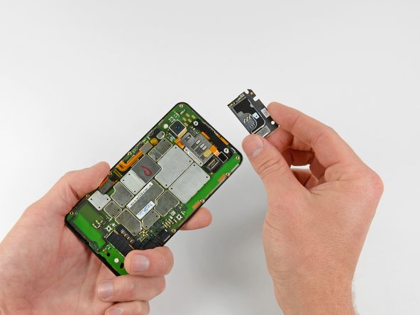

  • The 4G LTE SIM card board is held on by a few screws.
  • Another board bites the dust...good riddance LTE SIM card board...

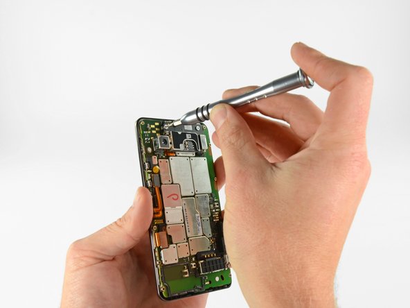

  • The display ribbon cable connector is in the way. Let's find a way to remove it.
  • We continue our quest of ridding the Bionic of its connectors with the help of our trusty spudger.
  • With stickers unstuck, screws unscrewed, and connectors disconnected, we lift the motherboard away from the display assembly.
