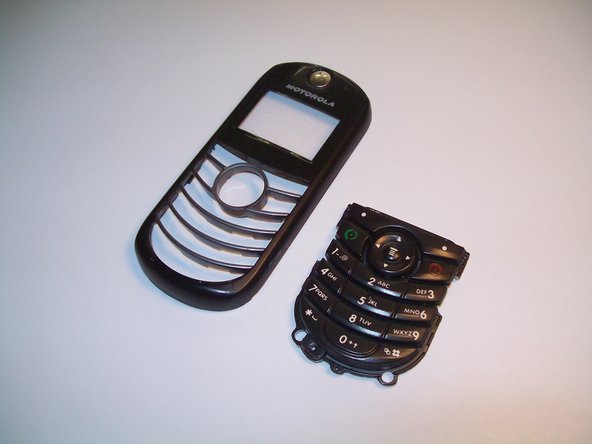

Add Note Edit Step 9 — Keypad & Faceplate  ¶

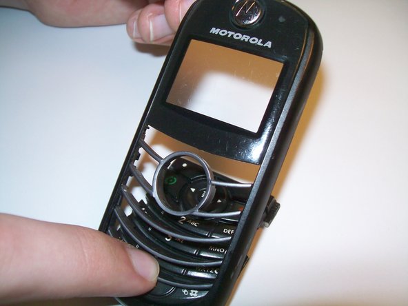

  • On the top half of the phone push downwards on the number keys to free the keypad from the top of the phone.

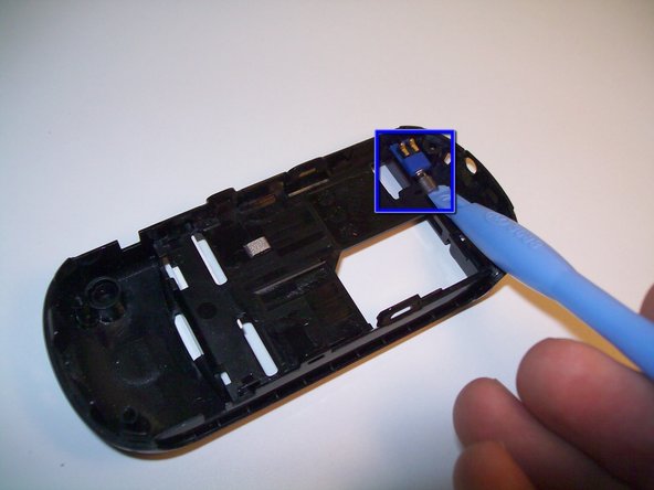

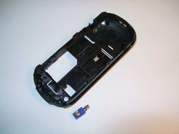

Image #1 Image #2
Add Note Edit Step 11 — Vibration Mechanism  ¶
  • Using your hands or the pry tool, gently lift the vibration mechanism out of the rear casing.

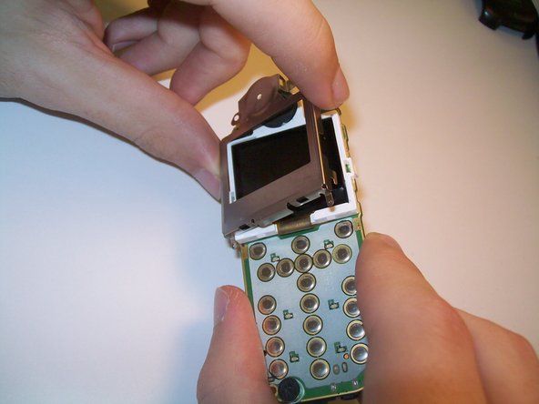

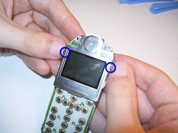

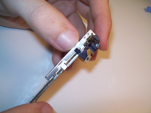

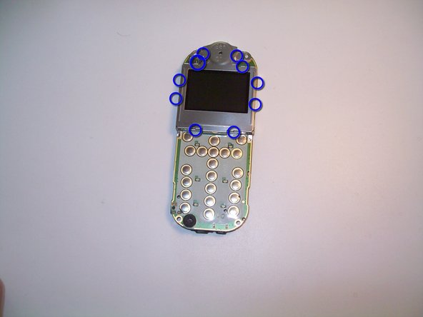

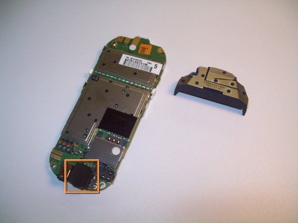

Image #1 Image #2 Image #3
Add Note Edit Step 12 — Speaker  ¶
  • Unhook the 10 clips holding the metal screen cover in place and pull up to detach it from the logic board.
    • There are four clips at the top, two along each side, and two clips at the bottom of the metal cover.

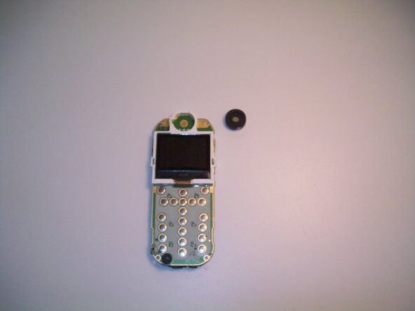

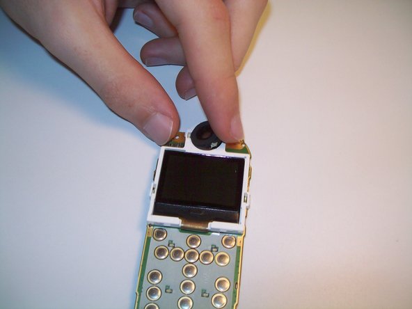

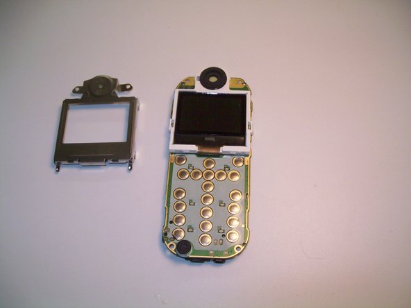

Image #1 Image #2
Add Note Edit Step 13  ¶
  • Lift to remove the speaker from its contact point on the logic board.

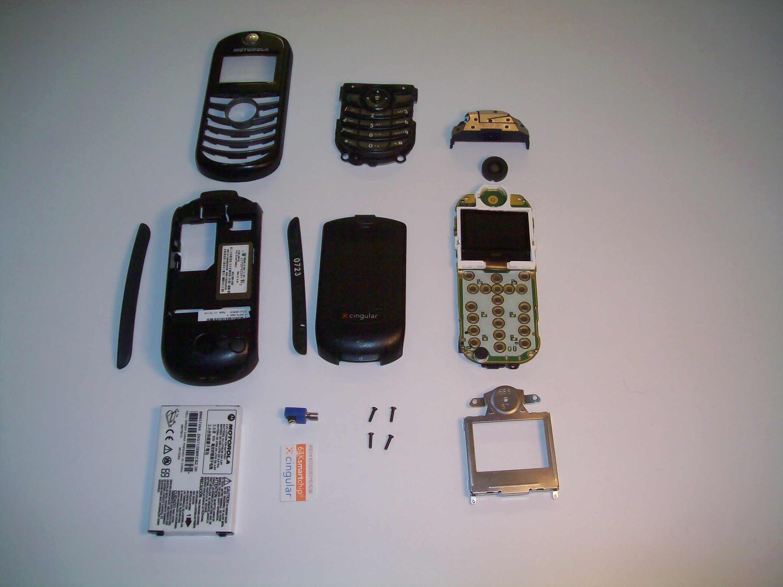

Image #1
Add Note Edit Step 14 — Motorola C139 Phone Teardown  ¶
  • List of Parts: Battery, SIM Card, Vibration mechanism, back cover, Front Case, Back Case, 2x rubber sides, 4x Screws, Antenna, Speaker, Keypad, Metal screen cover.
