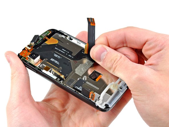

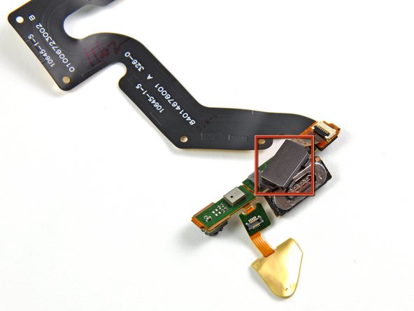

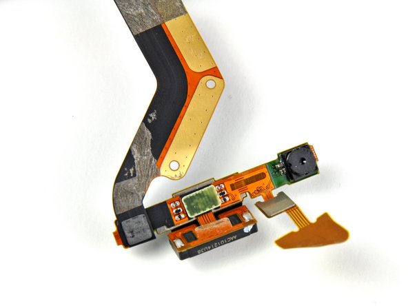

  • Next, the first of the two complex ribbon cables can be peeled off the steel mid-plane.
  • This cable houses the front camera, earpiece speaker, power button assembly, and top microphone. How's that for integration?
  • For enhanced security, the power button has a capacitive fingerprint scanner that can verify your identity from a single swipe of a finger.

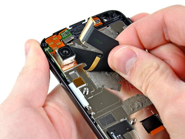

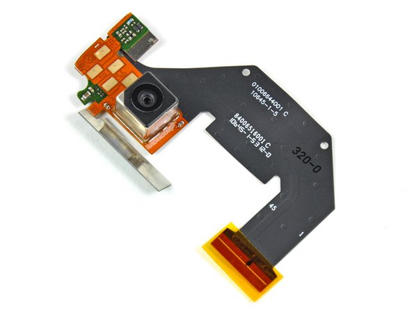

  • We can also remove the rear camera assembly and its cable.
  • One cable to rule them all: the rear camera, proximity sensor, ambient light sensor, pressure contacts for the headphone jack, and side volume buttons all come out as one piece.
  • What a decade can do for cables. Check out the thickness of a Parallel ATA cable compared to the Atrix camera cable. The PATA cable is 0.66 mm thick, while Atrix' camera cable measures 0.17 mm! And they're routing several components through the same cable!

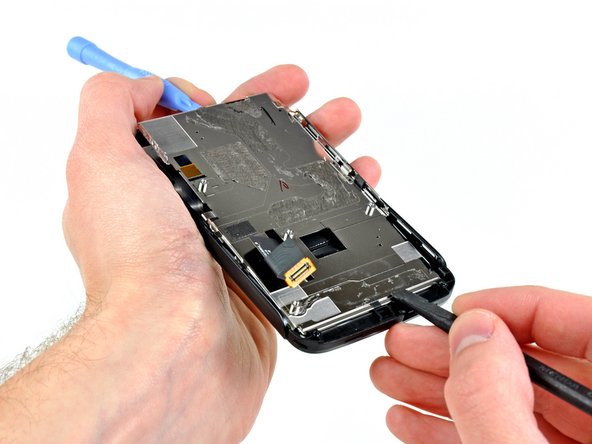

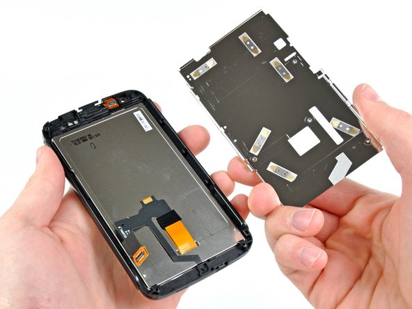

  • To remove the metal plate behind the LCD, simply lift its top edge slightly while pushing it toward the top of the phone.
  • After releasing it from its retaining clips, the LCD is readily accessible.

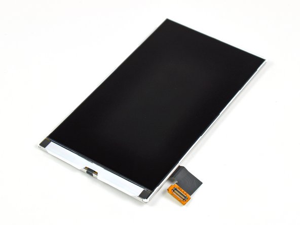

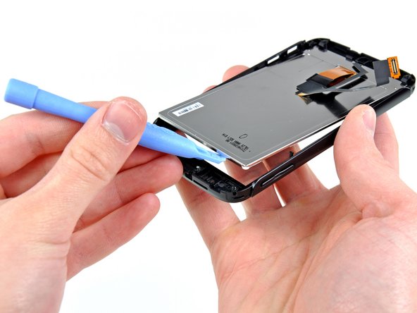

  • And just like that, the LCD can be lifted from the glass front panel.
  • Huzzah! -- the LCD is not glued to the front panel glass!
  • The roughly 80% (this number is a rough estimate and is a calculation deemed accurate by the iFixit statistical department) of people who drop their Atrix now won't have to spend their money on replacing a fully functional LCD in addition to their broken glass!
  • The 960x480 qHD PenTile LCD is aptly named because it is the size of one quarter of a 1080p panel.

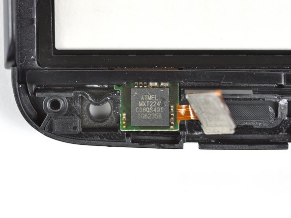

  • The front panel houses an Atmel mXT224 touchscreen controller underneath the LCD connector. It's the same chip we've found on the Samsung Galaxy Tab, Nexus S, and HTC Evo 4G.

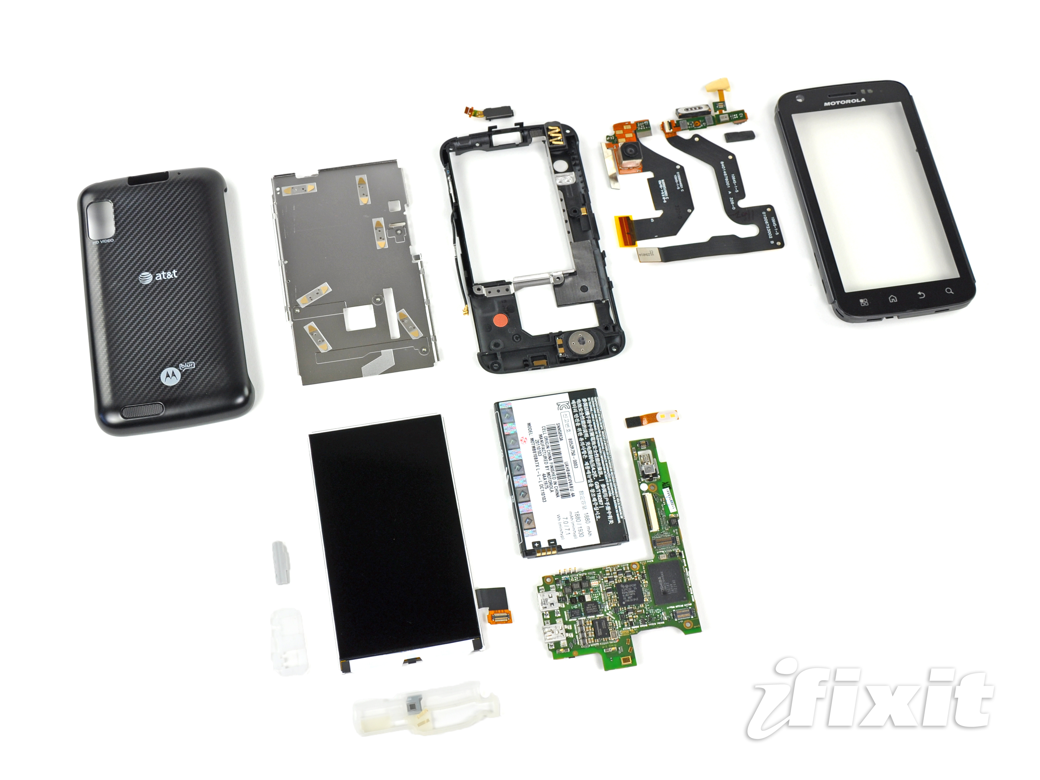

  • Motorola Atrix 4G Repairability Score: 9 out of 10 (10 is easiest to repair)
    • The LCD is separable from the glass front panel, making them independently replaceable.
    • The phone is held together with a limited number of screws and plastic clips. Adhesive is minimally used in its construction.
    • The battery can be removed in seconds.
    • No tools necessary for changing the SIM and microSD cards.
    • The phone feels solid in the hand, but the plastic rear panel is a little chintzy (that's right, chintzy).
    • The two main ribbon cables are soldered to many components (cameras, proximity sensors, etc.), making the cables costly to replace.
