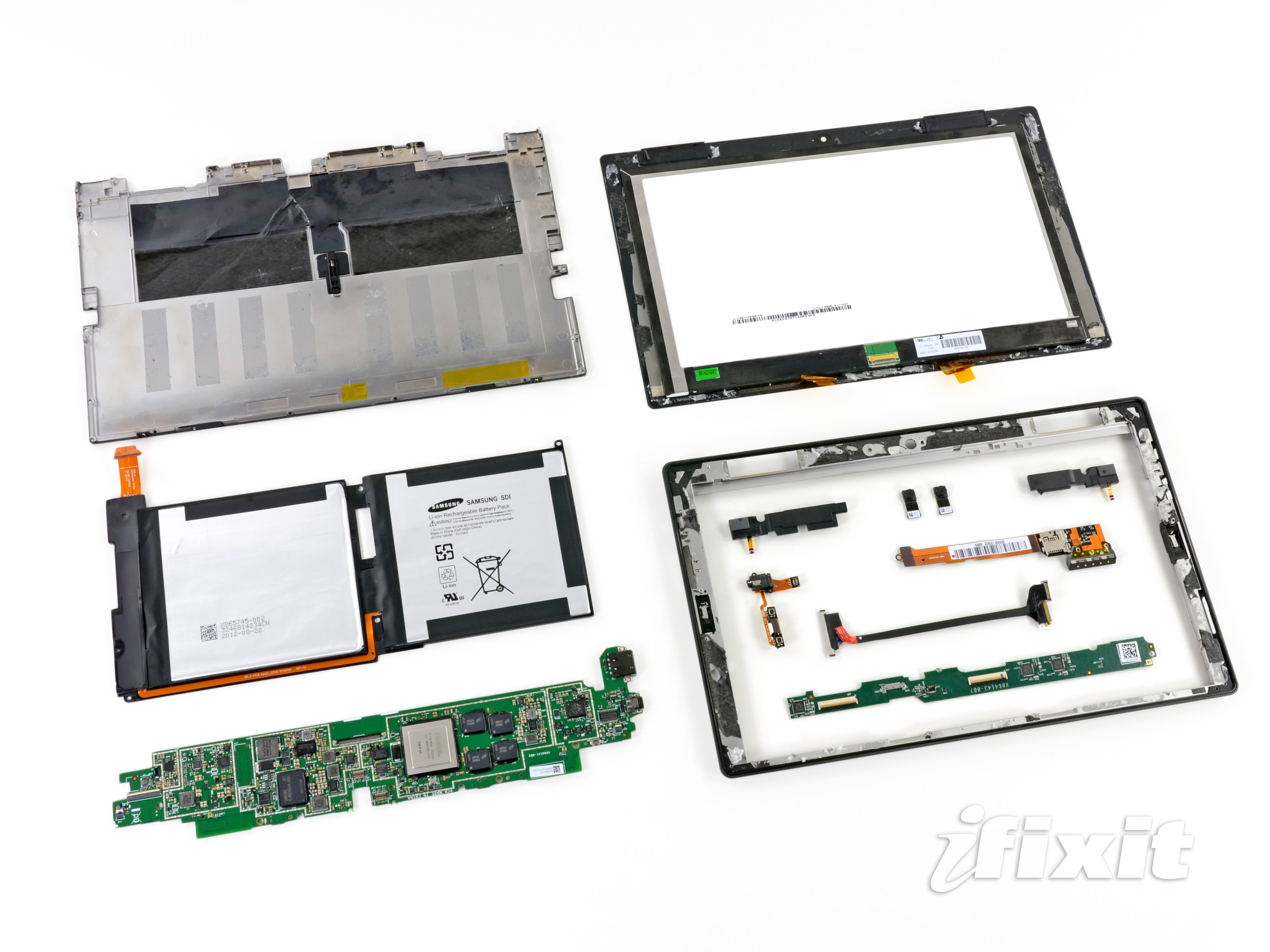

    • After removing a total of 17 T5 Torx screws, (10 under the kickstand and 7 under the camera cover), the rear case comes right off—almost.
    • A lone ribbon cable still tethers the battery to a ZIF connector on the Surface's motherboard, which we make quick work of with the ever-trusty spudger.
  7. Microsoft Surface Teardown: step 7, image 1 of 2 Microsoft Surface Teardown: step 7, image 2 of 2
    • The big question of the day: is the battery easily removed?
    • Answer: Yes. It's glued in, but it's way easier to remove than on the iPad. A couple of minutes of spudging around, and it's out.
    • We get our first look at the battery. As is the norm, the dual battery cell is adhered to the VaporMg rear case.
    • The 7.4 V, 31.5 Wh battery is manufactured by Samsung. It fits right in between the iPad 2's 25 Wh battery, and the iPad 3's 42.5 Wh unit.

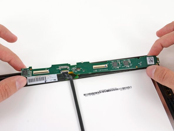

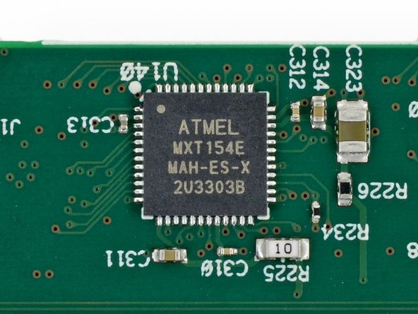

    • Following the mother(board) is the daughter(board) featuring three Atmel MXT154E touchscreen controllers.
    • This board only deals with matters pertaining to the 10.6" touchscreen. Everything else is either located on the motherboard or on its own ribbon cable.

    • Microsoft Surface Repairability: 4 out of 10 (10 is easiest to repair).
    • Several components are modular and replaceable without requiring desoldering.
    • You can remove the battery pretty easily—once you've suffered through the opening procedure.
    • It's pretty difficult to remove the rear panel and gain access to the device.
    • It is impossible to remove the keyboard connector without first removing the display from the frame.
    • LCD and glass are fused together and strongly adhered to the case, increasing cost of replacement.
    • You'll have to use a heat gun and lots of patience to gain access to the glass and LCD.
