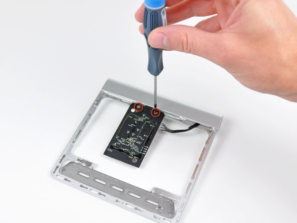

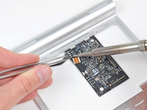

  • To completely remove the logic board, you must first de-solder the four wires leading to the battery connector/status LED.
  • After removing two Phillips screws, the logic board can be separated from the chassis.

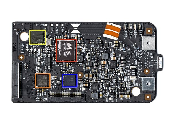

  • At the heart of the Magic Trackpad's logic board lies a Broadcom BCM2042 for Bluetooth connectivity.
    • This is the same chip used by the Magic Mouse for data transmission.
  • We found a Broadcom BCM5974 touch screen controller chip that provides Multi-touch functionality.
    • This is the same chip you'll find in the iPhone, iPod Touch, and MacBook Air.
  • Also, an SST 25WF020 provides 2 Mbit of serial flash memory.
  • This appears to be a TI CD3238, which has been identified by Hearst as a RS232 line driver/receiver. It was also in the original iPhone with a BCM5973A.

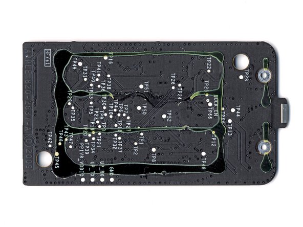

  • The back of the logic board features nothing but blackness and glue.

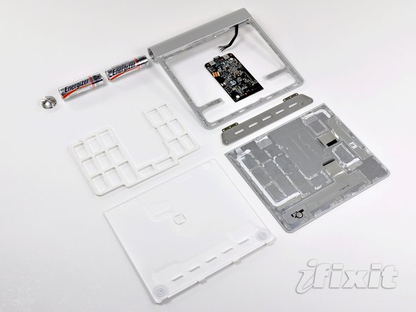

  • And there it lies: the Magic Trackpad in nine difficult-to-disassemble pieces.
