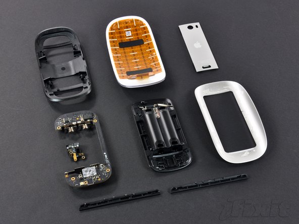

  • Let's get inside and find the magic amulet that gives the Magic Mouse its mighty powers. Not surprisingly, copious amounts of magical glue stand between us and our goal.
  • We used a Plastic Opening Tool to pry the mouse out of its shell.
Image #1 Image #2
Add Note Edit Step 6  ¶
  • The glue didn't want to let go, but we overpowered it with a flick of our magic wand. Screws would have been a lot easier to get apart (and much nicer to put back together).
  • There's not much Aluminum in the mouse, we weighed just 10 grams. That's compared to 37 grams of plastic and 47 grams of batteries. Nearly half the mouse's weight comes from the two AA batteries.

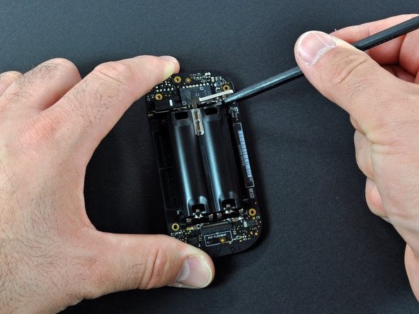

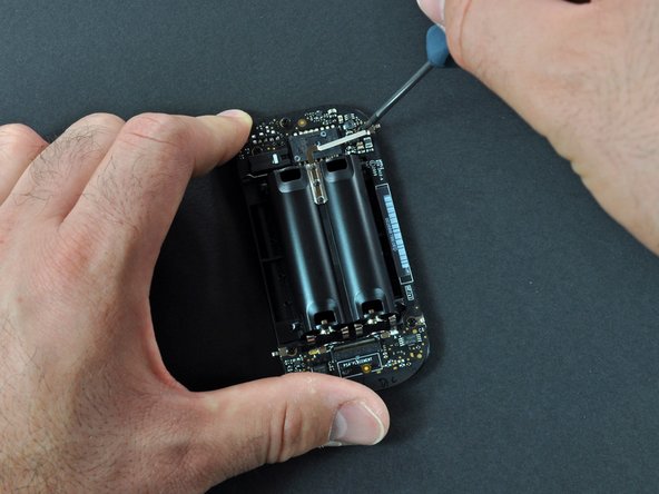

  • Open sarsaparilla! Open Saskatchewan! Open septuagenarian! Open saddle soap! ... OPEN SESAME! Now that was easy enough.
  • Here we receive our first glimpse of magic. (aka orange capacitive touch sensors).
  • The top of the mouse is connected to the main board and power via a single large ribbon cable.

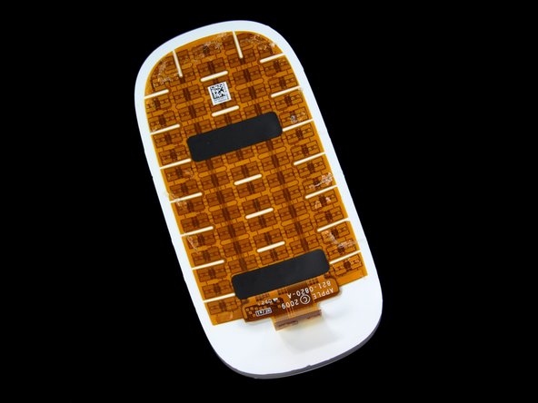

  • After prying up the black plastic internal frame, we finally get an unobstructed view of the sensors.
  • From the Apple logo up, the entire surface of the mouse is covered with capacitive touch sensors.

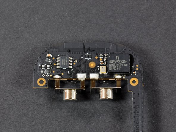

  • Here's the Broadcom BCM2042A4KFBGH chip that allows the Magic Mouse to talk to its host.
  • This is a BCM2042 "Advanced Wireless Keyboard/Mouse Bluetooth Chip."
  • According to Broadcom, "By integrating all components within today's mouse and keyboard into the BCM2042, low system costs can be achieved to approach the price points of legacy-wired mice and keyboards." Apparently Apple missed that memo.
