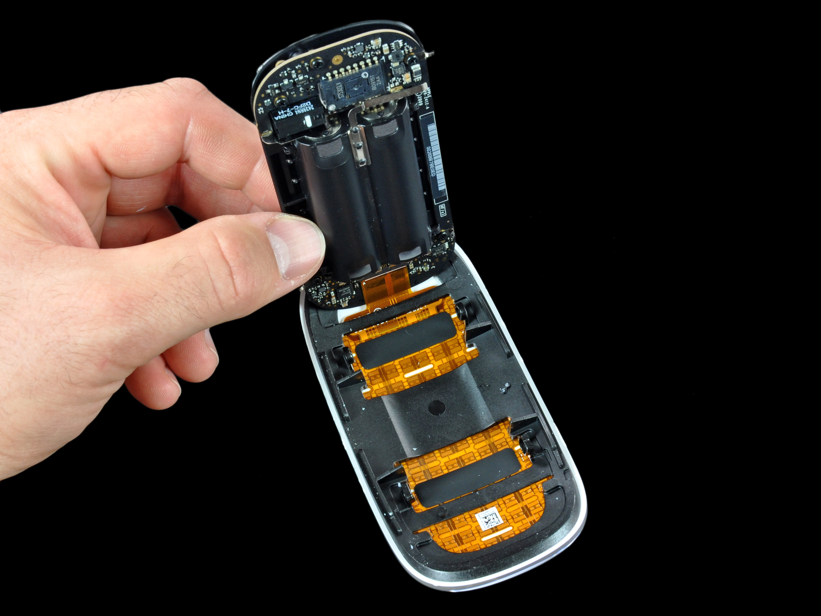

  7. Magic Mouse Teardown: step 7, image 1 of 3 Magic Mouse Teardown: step 7, image 2 of 3 Magic Mouse Teardown: step 7, image 3 of 3
    • Open sarsaparilla! Open Saskatchewan! Open septuagenarian! Open saddle soap! ... OPEN SESAME! Now that was easy enough.
    • Here we receive our first glimpse of magic. (aka orange capacitive touch sensors).
    • The top of the mouse is connected to the main board and power via a single large ribbon cable.

  9. Magic Mouse Teardown: step 9, image 1 of 2 Magic Mouse Teardown: step 9, image 2 of 2
    • After prying up the black plastic internal frame, we finally get an unobstructed view of the sensors.
    • From the Apple logo up, the entire surface of the mouse is covered with capacitive touch sensors.
