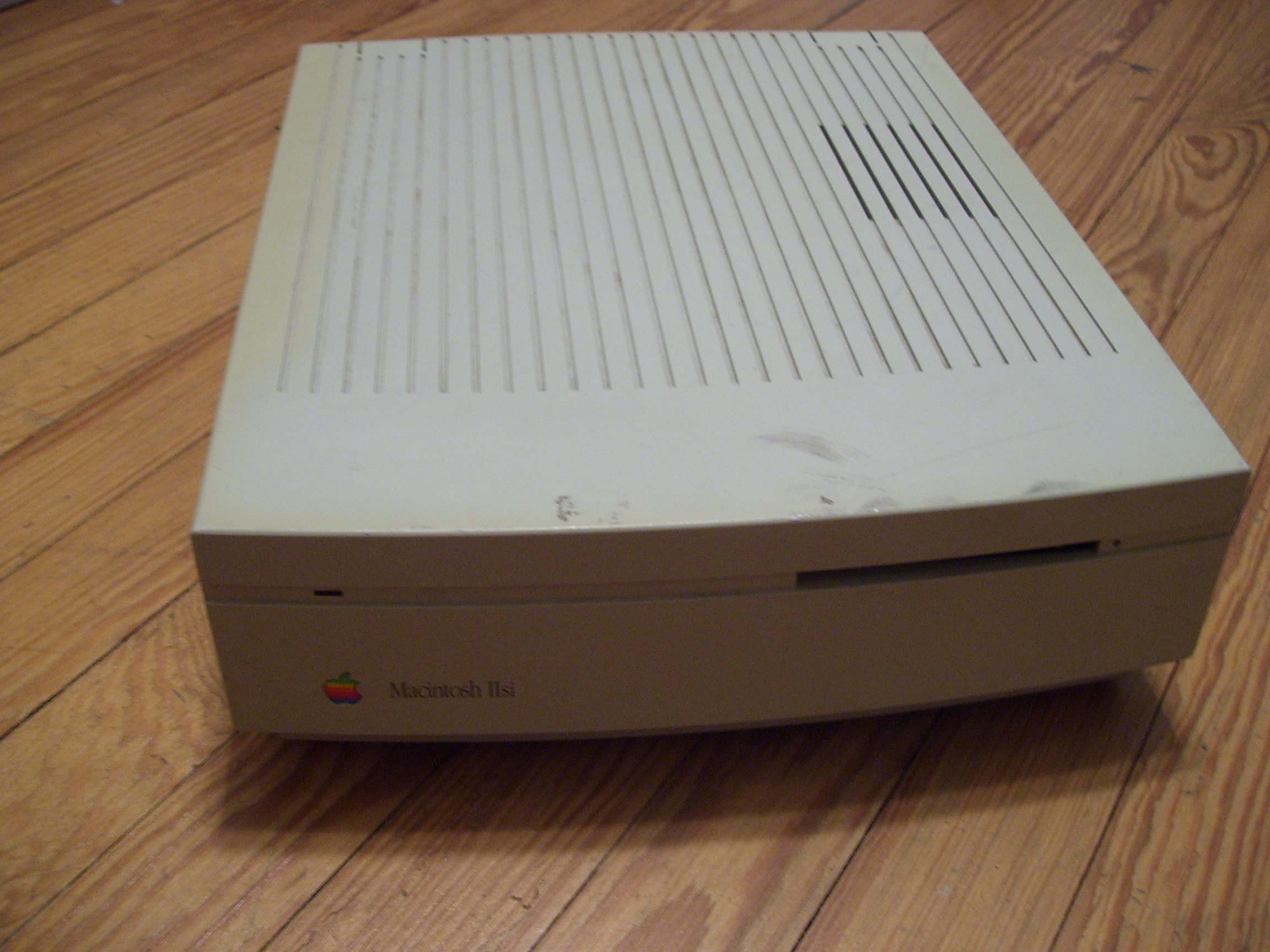

    • Yes, it only has a floppy drive. Its also 20 years old!
    • Lets begin the repair guide!

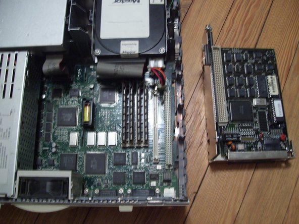

    • Remove these two thumbscrews if you have them. Then remove the PDS bracket by pulling straight up.
    • You should now have access to the RAM and PRAM battery.
    • To remove the hard disk, remove the SCSI cable, Power Cable, and pull on the outermost tab on the drive bracket. Lift the drive beyond this tab. Then do the other tab and the drive should come out.

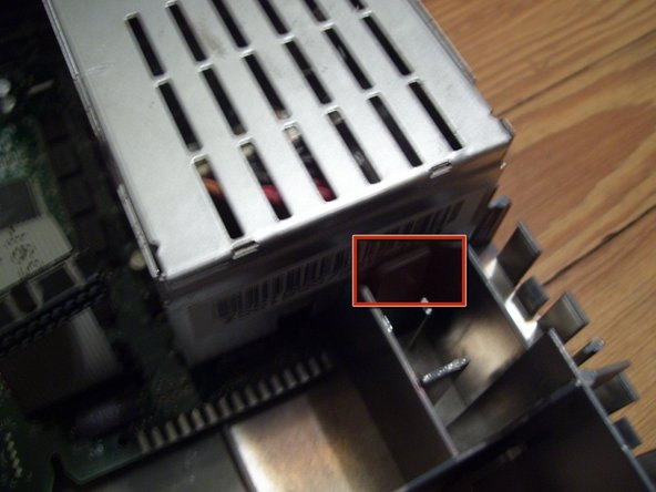

    • To remove the PSU, pull out this clip and pull out on the power supply.
    • Finally, all the components have been removed! This gives you access to clean the motherboard, add RAM or replace the 1/2 Lithium AA PRAM Battery.

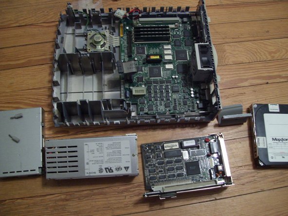

    • The motherboard of the IIsi.
    • CPU is a Motorola 68030 at 20mhz. The CPU can easily be clocked at 25 or 30Mhz by replacing the tin can oscillator to the right of the CPU with ones of a higher value. The system can have a FPU via the PDS to Nubus Adapter.
    • System Chipset, designed by apple and made by VLSI. Condensed version of the IIci system logic.
    • Serial Controllers for the LocalTalk ports.
    • Apple Sound Chip (ASC), custom design by apple. It uses the same sound controller as the LC and Classic. These are the first computers with built in sound input!
    • AMD 53C80 SCSI Controller
    • SIWM (Super Integrated Wozniak Machine) controls floppy and power functions.
    • 100 ns soldered on RAM
