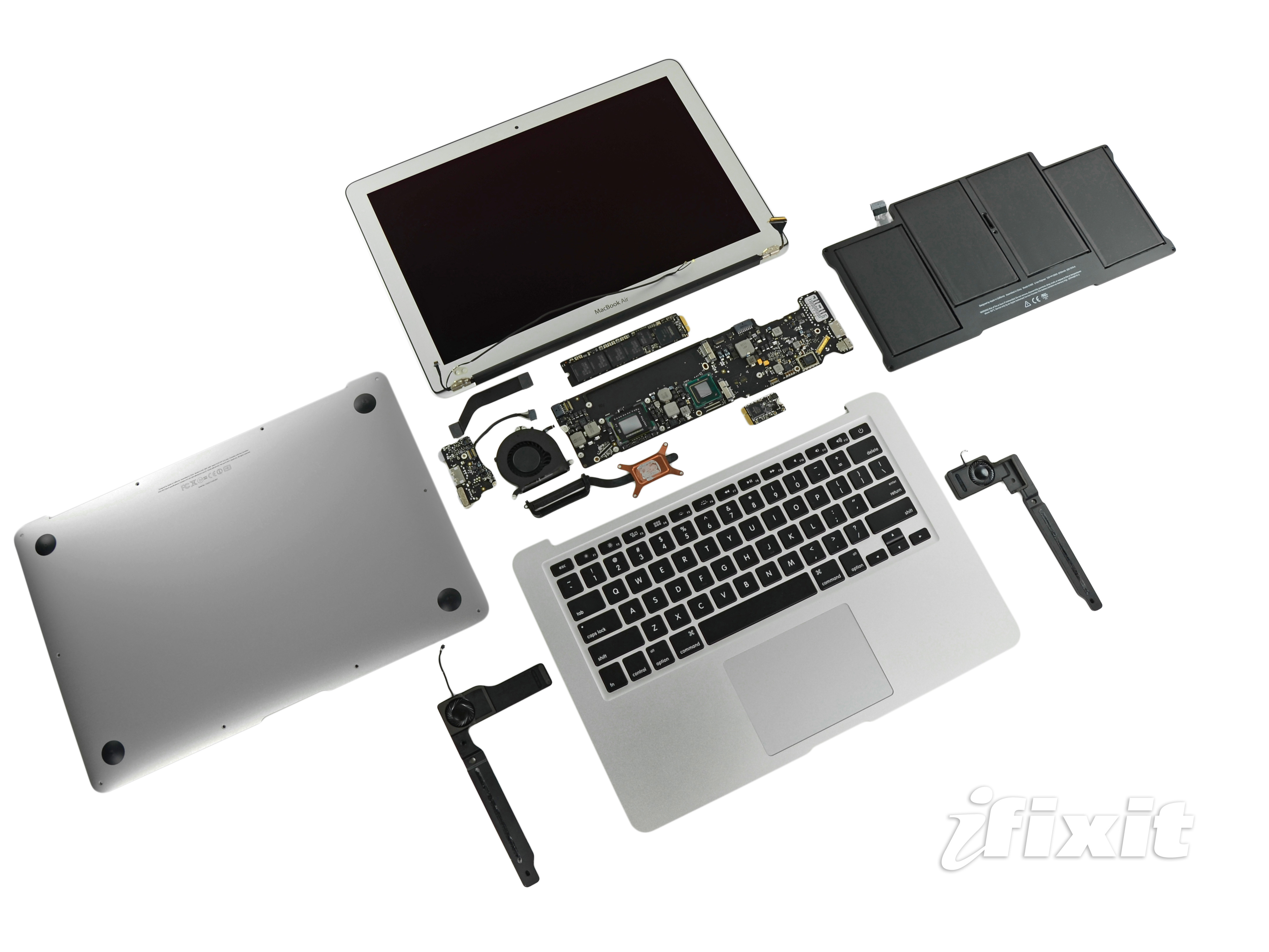

    • Here we have Apple's freshest fruit: the updated MacBook Air!
    • The drool-worthy specs of the 13" Air include:
    • Core i5 or Core i7 Processors
    • 128 or 256 GB Flash Memory
    • 4 GB DDR3 SDRAM
    • Intel HD 3000 Graphics with 384 MB RAM (shared with system RAM)
    • Thunderbolt Port and SD slot
    • The dimensions on this MacBook Air are exactly the same, so if you need to cut some cake, you should be okay.

    • MacBook Air 13" Mid 2011 Repairability: 4 out of 10 (10 is easiest to repair).
    • Once you manage to take off the bottom cover, all the parts are pretty easily replaceable.
    • Opening the bottom cover is quite difficult if you don't have the right screwdriver. It's clear that Apple didn't want people to open their machine.
    • All the components -- including RAM and SSD -- are proprietary, meaning that no off-the-shelf parts will work in it without serious rigging.
