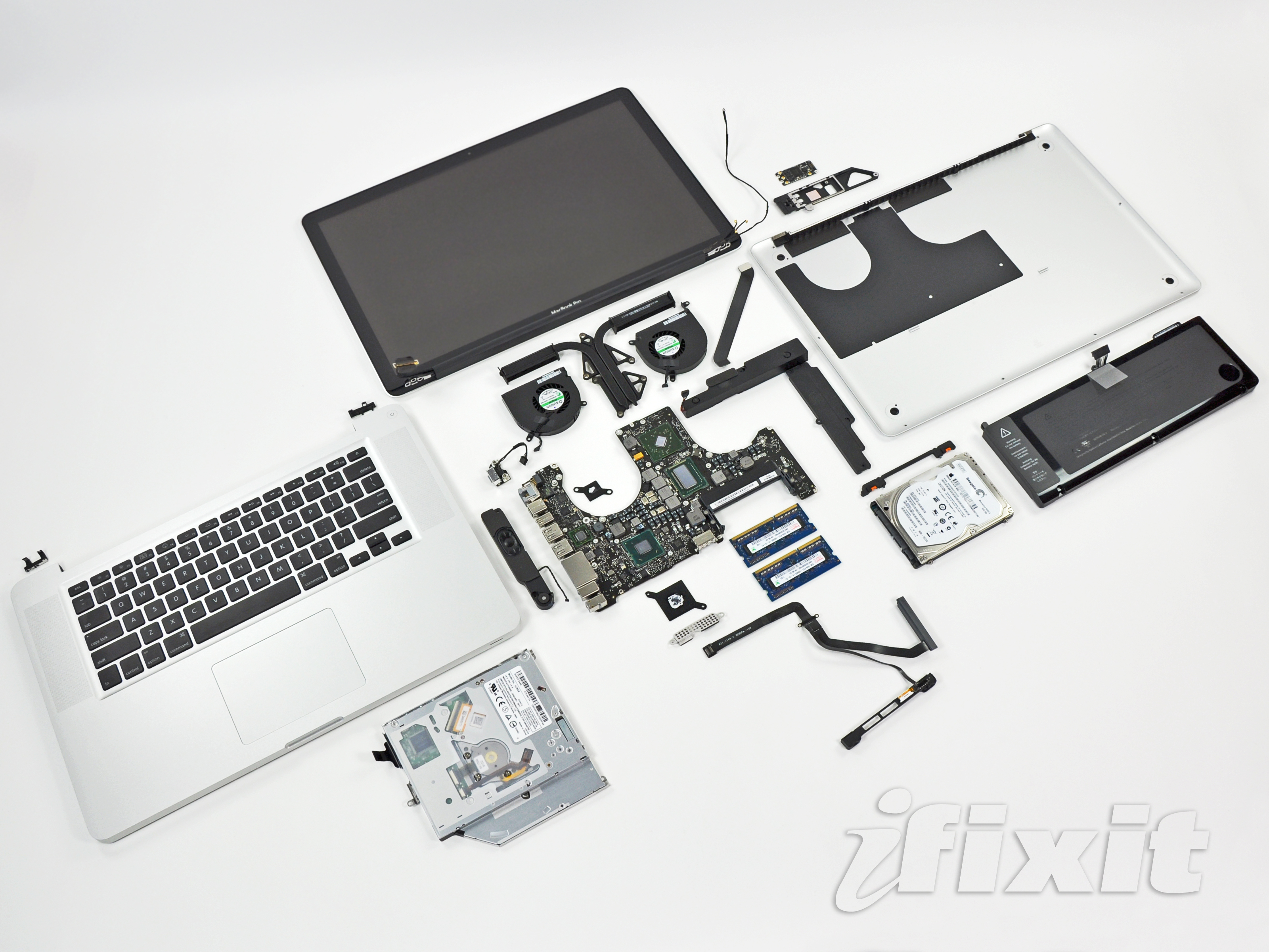

    • We got our hands on Apple's latest Unibody laptop. This is Apple's first portable to sport a quad-core processor: Intel's Core i7.
    • This machine includes Thunderbolt, a new I/O connection that combines PCI Express and DisplayPort into a single connector.
    • Thunderbolt claims to provide 10 Gbps throughput for both input and output. It appears that both PCI Express and DisplayPort receive their own 10 Gbps data channel. That's nice, as you don't want your display competing with your external hard drive for bandwidth.
    • You can chain up to 6 Thunderbolt devices including up to 2 HD displays. That's not a problem today as we're not even aware of 6 products that support Thunderbolt yet. If the connection becomes widespread, the 6 device limit might be a problem for some people.
    • In comparison, FireWire supports up to 63 devices in a daisy-chain, while USB does not support daisy-chaining.

    • Like most 15" Unibody laptops, there are two fans. To make sure things stay cool, there's a plethora of temperature sensors scattered throughout the machine, including near the trackpad, in the battery, and on the logic board.
  9. MacBook Pro 15" Unibody Early 2011 Teardown: step 9, image 1 of 3 MacBook Pro 15" Unibody Early 2011 Teardown: step 9, image 2 of 3 MacBook Pro 15" Unibody Early 2011 Teardown: step 9, image 3 of 3
    • The main board lifts out along with the heat sink still attached. This is a nice feature, as this way you have to remove the heat sink and reapply thermal paste only if you're completely replacing the logic board.
  10. MacBook Pro 15" Unibody Early 2011 Teardown: step 10, image 1 of 3 MacBook Pro 15" Unibody Early 2011 Teardown: step 10, image 2 of 3 MacBook Pro 15" Unibody Early 2011 Teardown: step 10, image 3 of 3
    • This machine features not only the large primary heat sink, but also two smaller heat sinks.
    • Holy thermal paste! Time will tell if the gobs of thermal paste applied to the CPU and GPU will cause overheating issues down the road.
    • The Mid 2010 15" Unibody was equipped with only one large heat sink to cool just the CPU and GPU. Also for that revision, the graphics switching chip seen in the second image was present, but didn't receive a heat sink.
    • The chip under the heat sink in the third image is a new chip that is most likely the Thunderbolt controller.

    • Aside from the logic board differences, there really isn't much else that makes this machine different from its 15" Unibody ancestors.
    • Small plastic plates adhered near the display hinges seem to keep the display data cable and antenna cable bundle stationary while the display is opened and closed.
    • The SuperDrive used on this machine has the model number UJ8A8, making it presumably different from the model UJ898 used in the Mid 2010 15" Unibody.
  15. MacBook Pro 15" Unibody Early 2011 Teardown: step 15, image 1 of 2 MacBook Pro 15" Unibody Early 2011 Teardown: step 15, image 2 of 2
    • One thing that has us a little concerned about the new models is their quality control.
    • A stripped screw near the subwoofer enclosure and an unlocked ZIF socket for the IR sensor should not be things found inside a completely unmolested computer with an $1800 base price.
  16. MacBook Pro 15" Unibody Early 2011 Teardown: step 16, image 1 of 2 MacBook Pro 15" Unibody Early 2011 Teardown: step 16, image 2 of 2
    • MacBook Pro Unibody 15" Early 2011 Repairability Score: 7 out of 10 (10 is easiest to repair).
    • Easily removable bottom panel and readily accessible battery connector allow for easy repair of most components without touching the battery screws.
    • Unibody design allows for easy access of most components with minimal amounts of extra work needed to get to them.
    • Absurd amounts of pre-applied thermal paste may cause problems down the road.
    • Tri-wing screws limit the average person from replacing their own battery.
    • LCD replacement is still very tricky, which could easily result in shattering the front glass panel.
