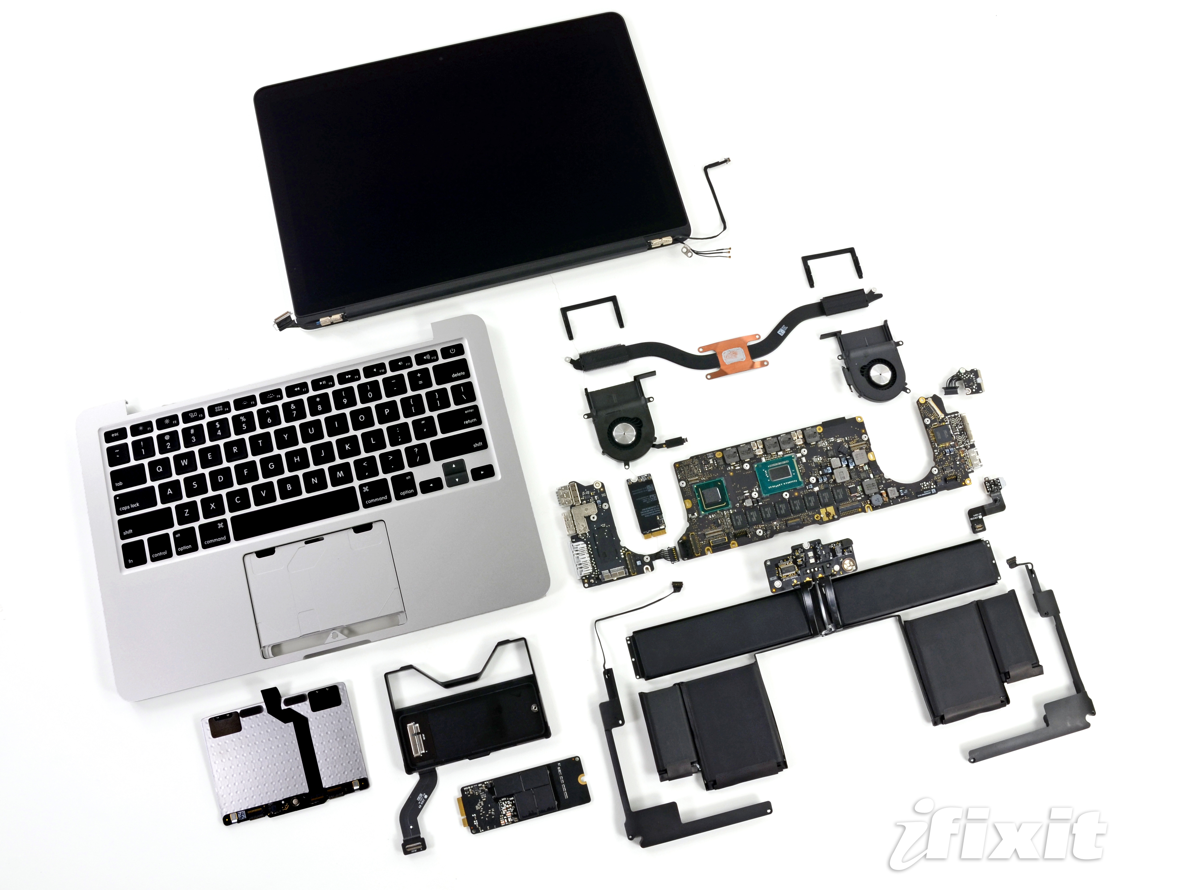

    • The 13" MacBook Pro has received the Retina display treatment! Let's see what it's packing.
    • 13.3" 2560x1600 pixel (227 ppi) Retina display
    • 2.5 GHz Intel Core i5 processor
    • 128 or 256 GB flash storage
    • 8 GB DDR3L onboard RAM
    • Thunderbolt, USB 3.0, and HDMI I/O
    • Intel HD Graphics 4000

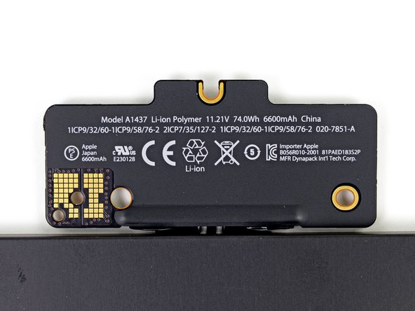

    • As always, we start by disconnecting the battery, a simple task that requires no more than releasing a conn—wait, what is this?
    • Instead of the good ol' run-of-the-mill battery connector that we've seen in most other Apple laptops, the battery is connected using several screws that hold a connector board in place.
    • This little PCB serves only as a bridge between the battery control board and the logic board.
    • …weird?

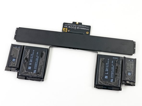

    • Okay, deep breath. We are going to attempt to remove the battery.
    • Six cells stand between us and the upper case.
    • Despite what happened last time, we are determined to get the battery out.
    • This time we're excited to find two of the six cells in a metal tray held in with screws and no adhesive. Barely started and already 1/3 done!
    • Things slow down when we get to the outer cells and start slowly spudgering under the edges. Listening for the snap crackle & pop of breaking adhesive, we cautiously push forward until all six cells are free.
  17. MacBook Pro 13" Retina Display Late 2012 Teardown: step 17, image 1 of 3 MacBook Pro 13" Retina Display Late 2012 Teardown: step 17, image 2 of 3 MacBook Pro 13" Retina Display Late 2012 Teardown: step 17, image 3 of 3
    • It was a slow and tedious process, but we removed the battery—sans puncture.
    • The task took us roughly 15 minutes to complete, without the use of a heat gun. All we needed was a Torx screwdriver and three spudgers.
    • In contrast, it took us three attempts to successfully remove the 15" Retina's battery without puncturing it, and the third attempt took over half an hour to perform.
    • Yet, EPEAT lab investigators reported the time required for the MacBook Pro 15" Retina battery removal was under 2.5 minutes, cited that the operation could be conducted “easily and safely,” and gave the laptop its Gold rating.
    • We certainly disagreed with that notion, given it was the least repairable computer we've ever encountered.
    • The 13" Retina battery is a step in the right direction towards recyclability and repairability, but it's still a far cry from the no-adhesive MacBook Pro batteries of yesteryear.

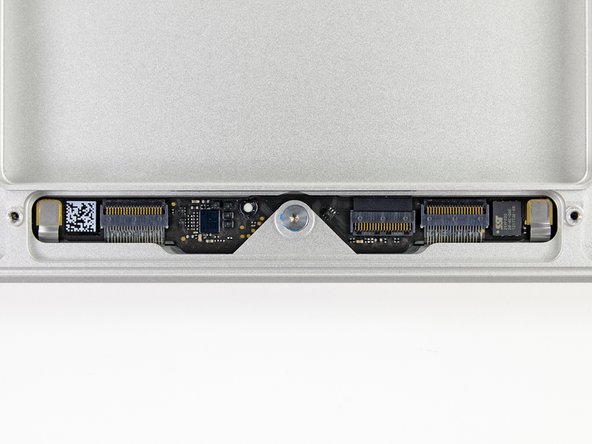

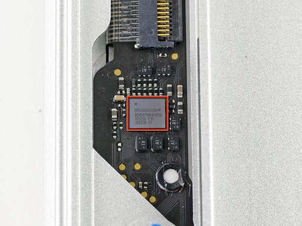

    • The trackpad board contains several connectors and two prominent ICs:
    • Silicon Storage Technology SST25VF020 2 Mbit SPI Serial Flash
    • Up until now, we haven't noticed the inclusion of flash memory on the trackpad. We don't know why a trackpad would require flash memory. However it seems that it was also included in the MacBook Pro 15" Retina display trackpad.
    • Broadcom BCM5976 touchscreen controller (as found in the iPhone 5.)

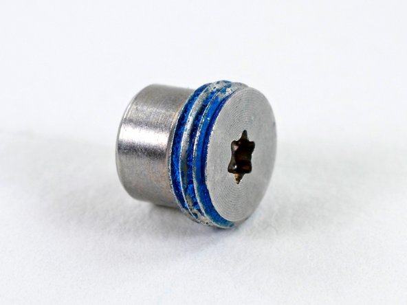

    • What a funky looking trackpad set screw. This standoff screw is much bigger than those found in previous generations, and is held in with threadlocker.

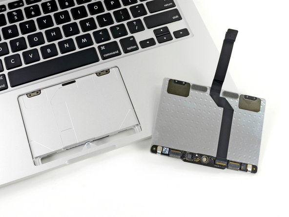

    • We are so excited to see the trackpad come out, and you should be too!
    • Just five screws keep the trackpad in place. You can actually replace it if it breaks, which is pretty much impossible on the 15" model—it's covered by the battery.

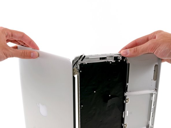

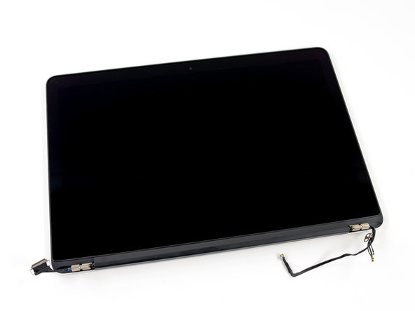

    • The Retina display comes out after removing a few Torx screws.

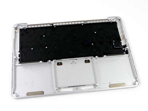

    • We did not attempt to separate the display from the glass, seeing as how the whole enchilada is fused together. But if you are curious, take a look at our Retina display teardown for the full rundown.
    • After all is said and done, the only thing that remains is the upper case.
