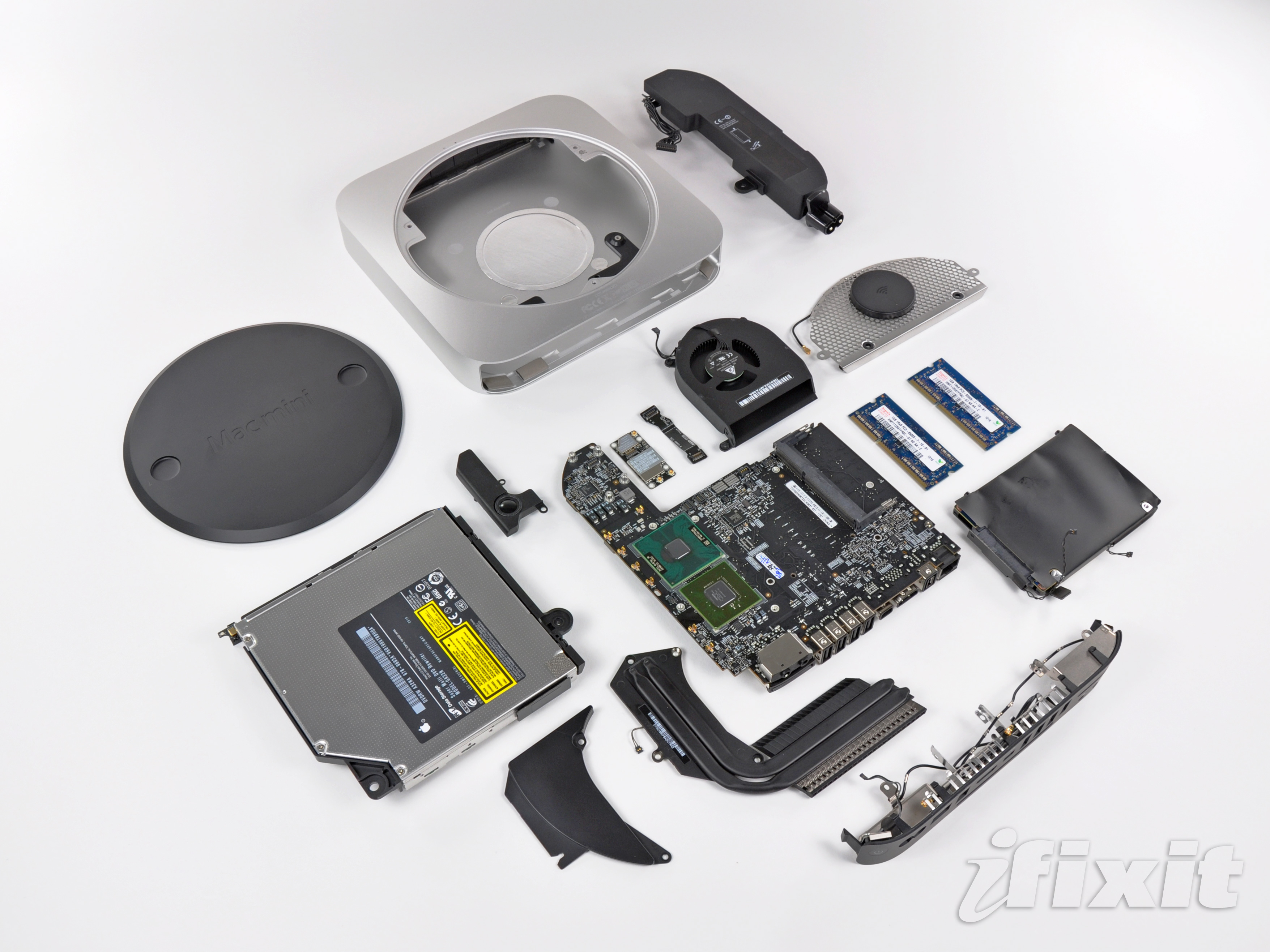

  1. Mac Mini Mid 2010 Teardown, Mac Mini Mid 2010 Teardown: step 1, image 1 of 1
    • Well folks, after much clamor, it seems the engineers at Apple have finally included an HDMI port in an actual Apple product.
    • Notable Tech Specs:
    • 2.4 or 2.66 GHz Intel Core 2 Duo processor
    • 2 GB of RAM (expandable up to 8 GB)
    • NVIDIA GeForce 320M graphics processor with 256MB of shared DDR3 SDRAM (the same as the most recent MacBook)
    • HDMI port with support for up to 1920-by-1200 resolution
    • AirPort Extreme 802.11n Wi-Fi wireless networking
    • SD card slot

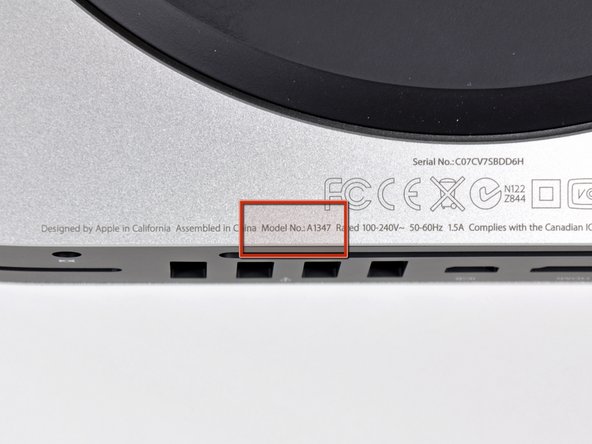

    • Departing from previous generations, the Mini's unibody top enclosure is machined from a single block of aluminum.
    • Measuring 1.4 x 7.7 x 7.7 inches and weighing only 3 lbs, this is truly one for the books.
    • The black logo and other accents match quite nicely with the styling of Apple's iPad and recent iMacs. Congrats, Mini, you're no longer the black sheep of the family!
    • The model number for this new unit is A1347.

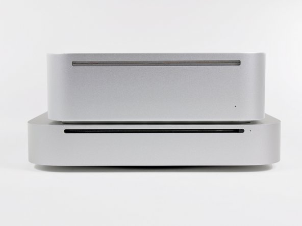

    • In comparison to the Mac Mini model A1176, the Mid 2010 is thinner and wider.
    • There is a definite difference in height between the Mid 2010 and previous iterations.

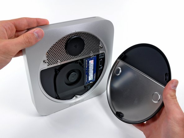

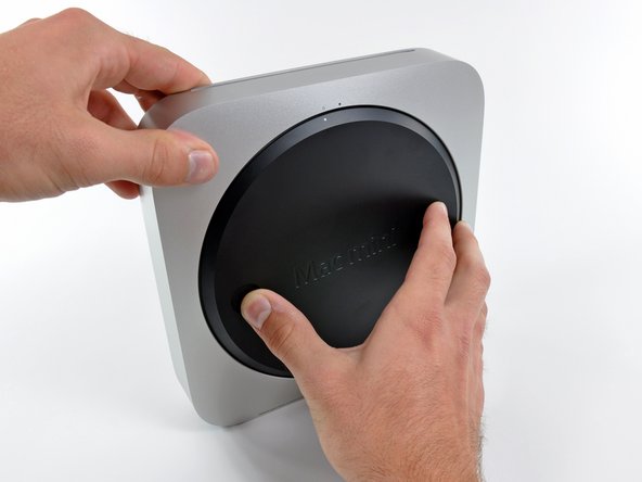

  6. Mac Mini Mid 2010 Teardown: step 6, image 1 of 2 Mac Mini Mid 2010 Teardown: step 6, image 2 of 2
    • With a simple counter-clockwise twist, the black access plate can be removed for easy RAM and fan access.
    • Gone are the days of the putty knife...you will be missed old friend...

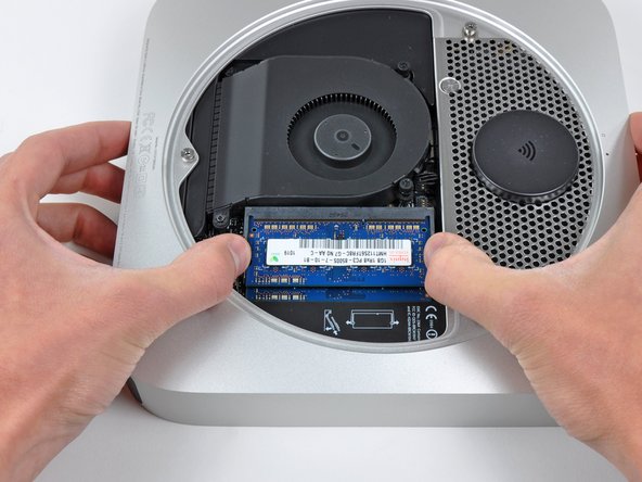

  7. Mac Mini Mid 2010 Teardown: step 7, image 1 of 1
    • Much like many other new Apple products, removing the RAM is quite feasible this time around.
    • This little guy comes with two SO-DIMM slots capable of supporting up to 8GB of RAM.
    • Our base unit came strapped with two gigs of RAM.

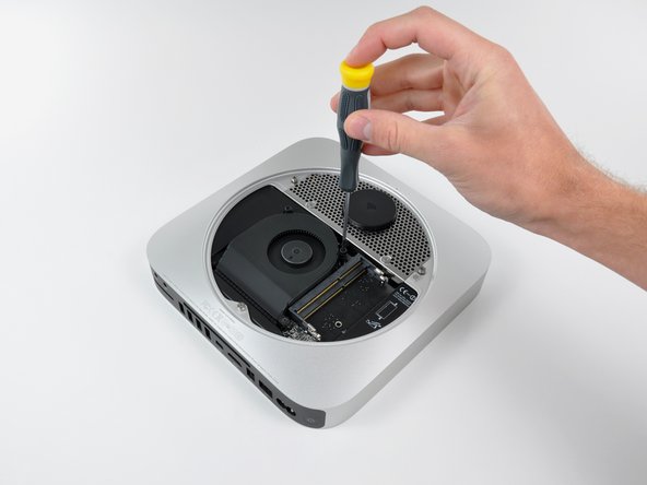

  8. Mac Mini Mid 2010 Teardown: step 8, image 1 of 2 Mac Mini Mid 2010 Teardown: step 8, image 2 of 2
    • After removing two screws, the fan can be lifted out to access its power connector.
    • The connectors inside this machine look pretty consistent with those found in Apple's current product lineup. Nothing too new here.
    • All three fan screws are isolated with rubber dampers; a feature not seen on older apple machines. Low noise and vibration are big selling points for Apple these days, and the new Mini's idle emission of 14 dB is a testament to those design goals.

    • The remainders of the Mac Mini Mid 2010.
    • Macminicolo took apart the server version of the new Mini. Check it out if you want to see how Apple stashed the second hard drive.
    • Thanks for following iFixit during this historic moment. Until next time!
