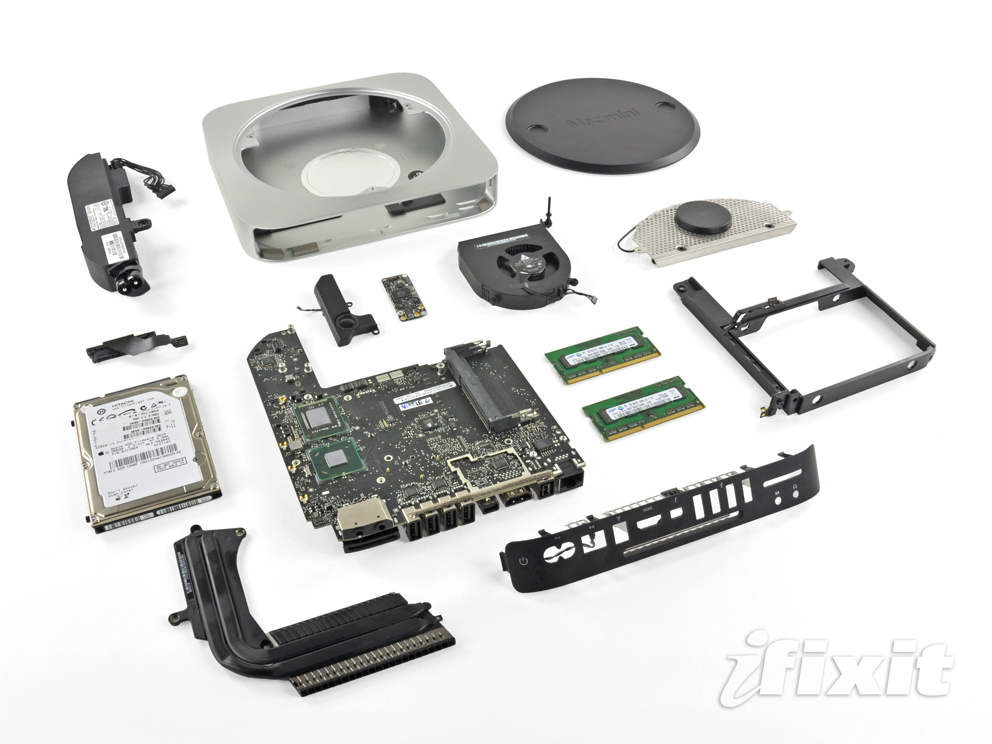

    • After a few finger pushups and a firm twist, we get our first glimpse of the innards.
    • They look rather identical to the previous model...

    • The big question with this unibody mac Mini: "Can I install a second hard drive myself?" The centimeter and a half of extra space seem to imply so.
    • There is definitely plenty of room for a second hard drive underneath the first. The only deterrent is the availability of a second, longer SATA hard drive-to-logic board cable.
    • Update: We include that cable in our Mac mini Mid 2011 Dual Hard Drive Kit.
    • Let's get the logic board out so we can get a better look.

    • The release of the new Mac mini means the return of our favorite tool: the Mac mini Logic Board Removal Tool! Luckily, we have come prepared this time.
    • No longer forced to use two screwdrivers, we insert our Mac mini Logic Board Removal tool, and it does the trick. The logic board assembly slides right out of the aluminum unibody.
    • With the logic board removed, we see how a second hard drive could be installed.

    • Mac mini Mid 2011 Repairability: 8 out of 10 (10 is easiest to repair).
    • No proprietary screws are found within the device.
    • You can easily upgrade your RAM and hard drive, as well as add a secondary drive.
    • There's no glue anywhere inside that needs to be removed while disassembling the mini.
    • The CPU is soldered to the logic board and not user-upgradeable.
    • While not difficult to do, you still have to remove almost all the internals in order to replace the power supply.
