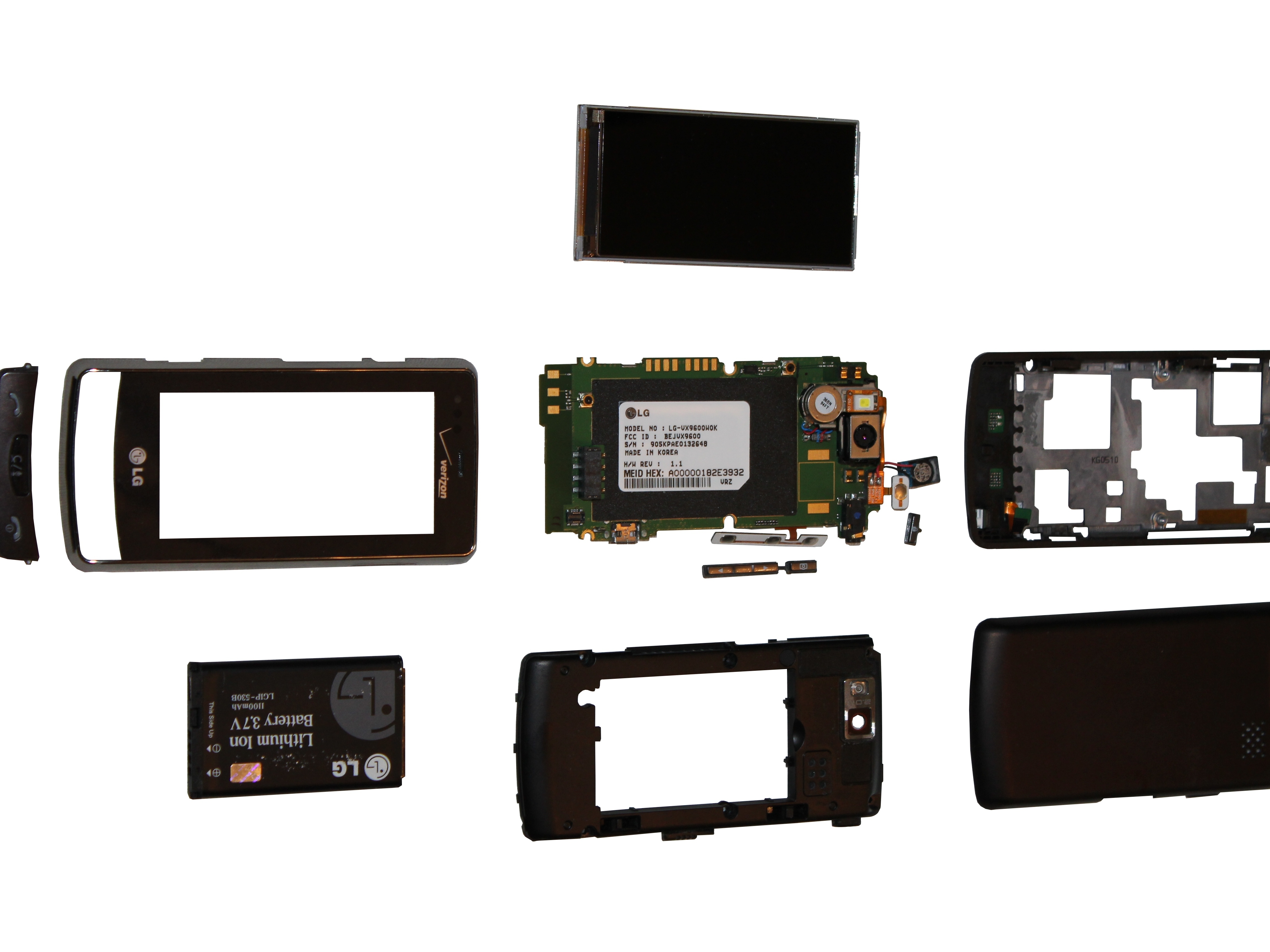

LG Versa is one of the first all touchscreen cell phones that Verizon Wireless sells. The Versa is the sister phone to the LG Dare. The phone comes with a 2.0 megapixel camera with a flash. The Versa has a 3" touchscreen and a 3D graphic interface.

Add Note Edit Step 4  ¶
  • On the right hand side of the LG Versa there is a latch to open up the back of the cell phone. Push the latch up and lift off the back of the phone exposing the battery.
Image #1 Image #2
Add Note Edit Step 5  ¶
  • Simply insert your finger in between the slot and the battery and push down and up to remove the battery.
Image #1
Add Note Edit Step 6  ¶
  • Six Phillips screws holding down the battery housing (Circled in the picture). Unscrew the six screws and put them aside.
Image #1 Image #2
Add Note Edit Step 7  ¶
  • Insert a safe prying tool between the slot between the front screen housing and the battery housing to remove the battery housing.
Image #1
Add Note Edit Step 8  ¶
  • In the bottom right corner of the logic board, disconnect the button connector with tweezers or a prying tool.
