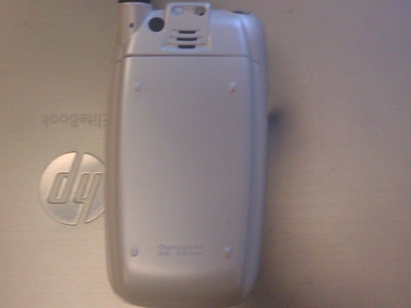

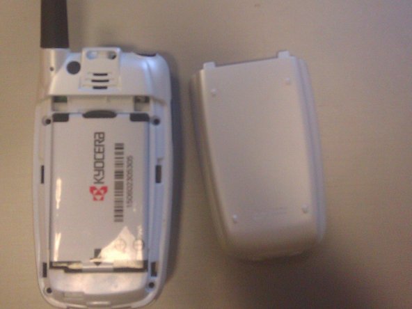

  • Step One
    • Remove back cover
    • Remove battery

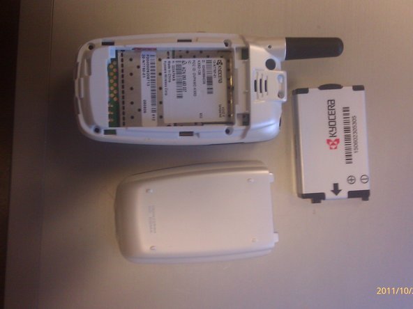

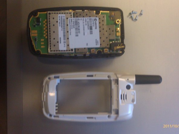

Add Note Edit Step 2  ¶
  • Using a Phillips #1 Screwdriver, remove the 4 screws from back of phone
  • Snap off plastic housing
Image #1 Image #2

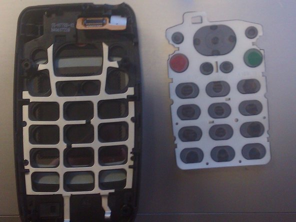

Add Note Edit Step 3  ¶
  • SLOWLY remove motherboard
  • Unsnapping the wire that go to the screen while removing
  • Pull out keypad

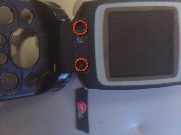

Add Note Edit Step 4  ¶
  • With phone open remove virgin mobile sticker to expose screw heads
  • Remove screws

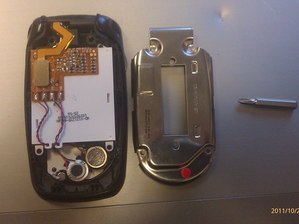

Add Note Edit Step 6  ¶
  • Remove metal cover
Image #1

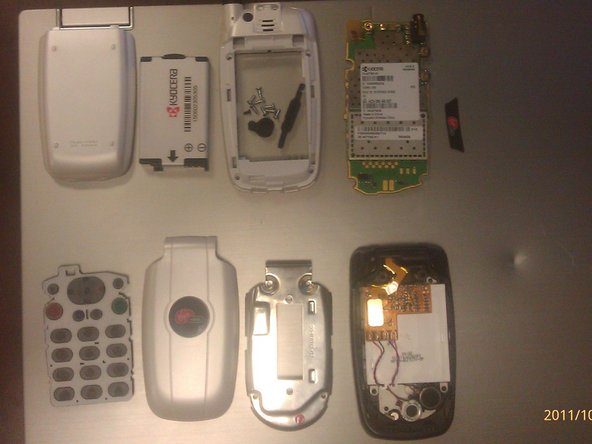

Add Note Edit Step 7  ¶
  • Final outcome
