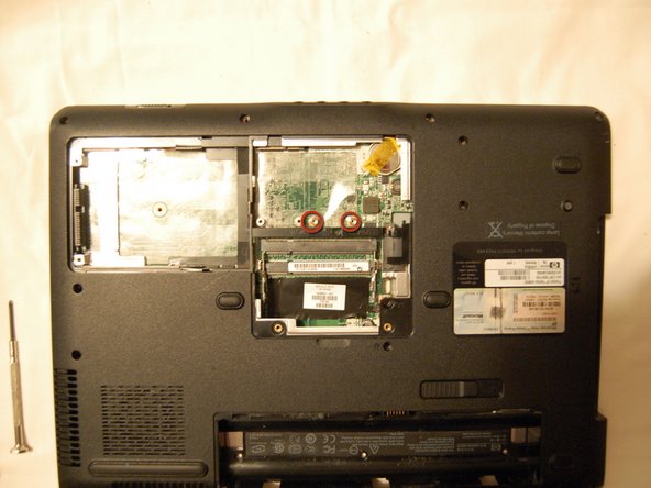

Add Note Edit Step 3  ¶
  • Loosen the two screws from the memory shield and lift off
    • Remove the mini-pci wireless card and memory, place in an anti-static bag.

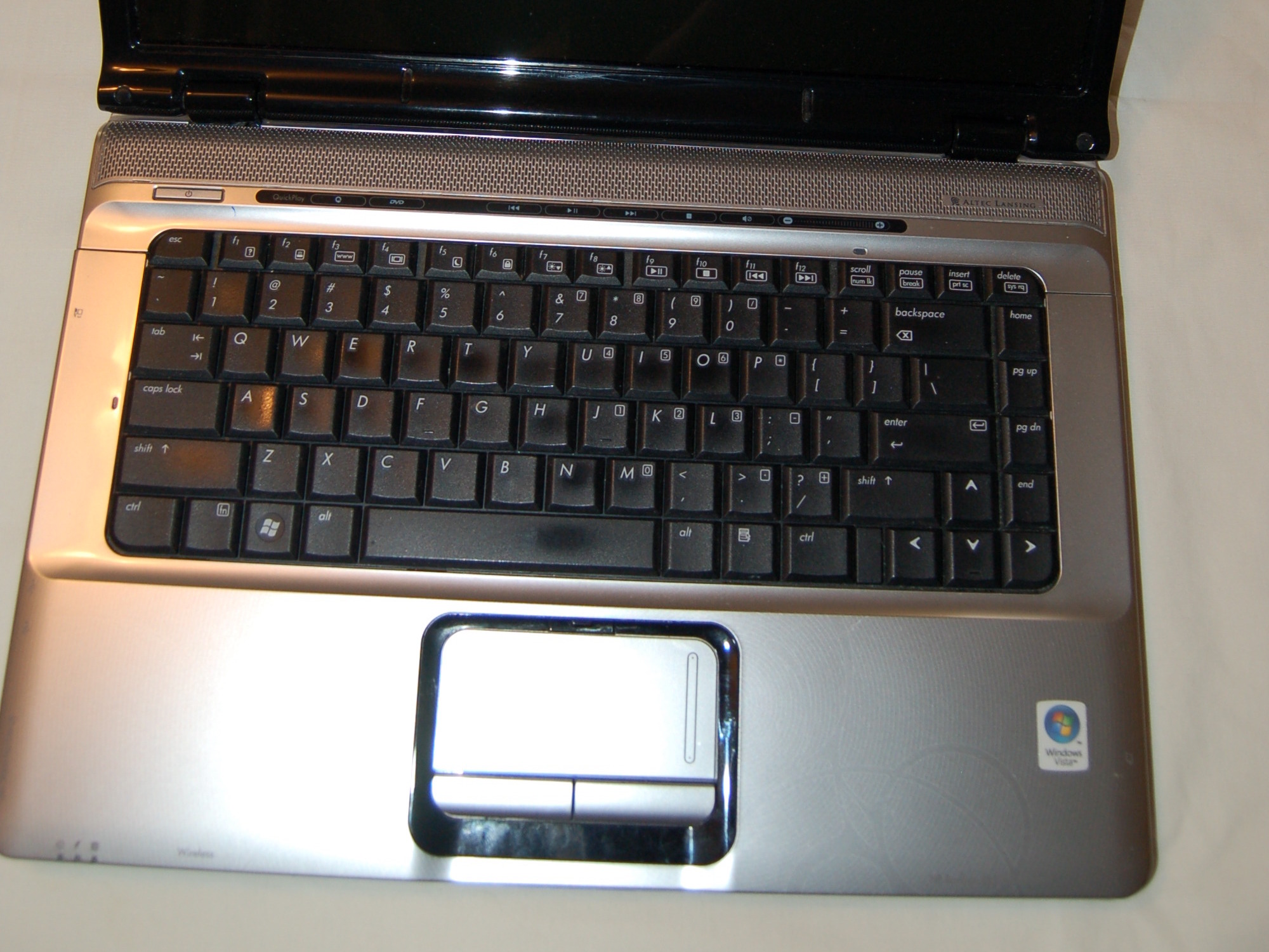

Add Note Edit Step 8  ¶
  • Lift up the back of the keyboard and slide it slowly towards the screen. Unclip the ribbon cable near the touchpad. Set the keyboard aside.

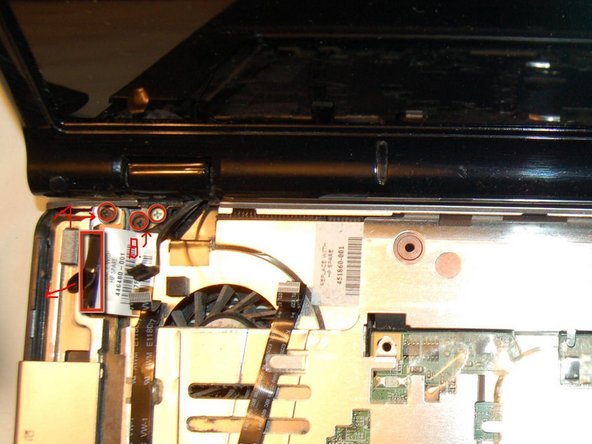

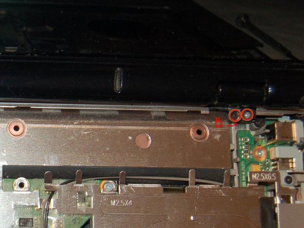

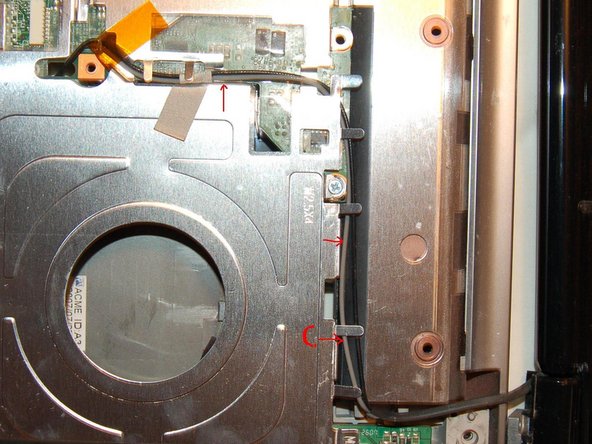

Add Note Edit Step 9  ¶
  • Time to take off the screen.
    • A. Remove the screw on the left that holds the clip down, unclip it.
    • B. Remove the four screws at the base of the screen, and lift out, taking care with the antenna wires on the right.
    • C. Thread them out of the clips, towards the touchpad. You can then pull them through the board, checking on the bottom to make sure they’re free.

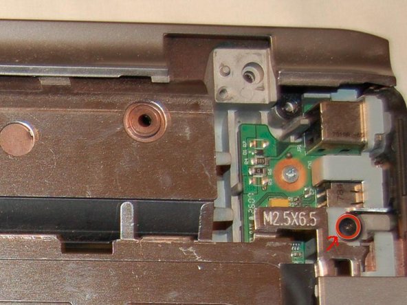

Add Note Edit Step 10  ¶
  • Remove the screw on the right, and remove the back bezel.
  • Remove the three screws from the top of the touchpad bezel.

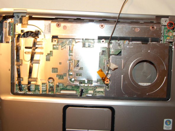

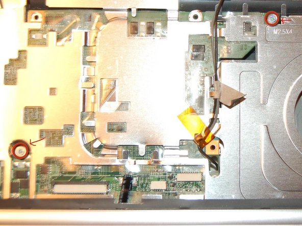

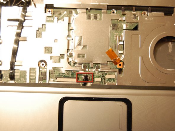

Add Note Edit Step 11  ¶
  • Remove the two standoffs on the bottom (5mm socket)
  • Unclip this clip and lift off the touchpad bezel
  • The two ribbon cables in the third image (one I took out before taking the picture) are simply seated in their clips, you will need to apply some force to get them out, just be careful to apply it straight away from the clips.

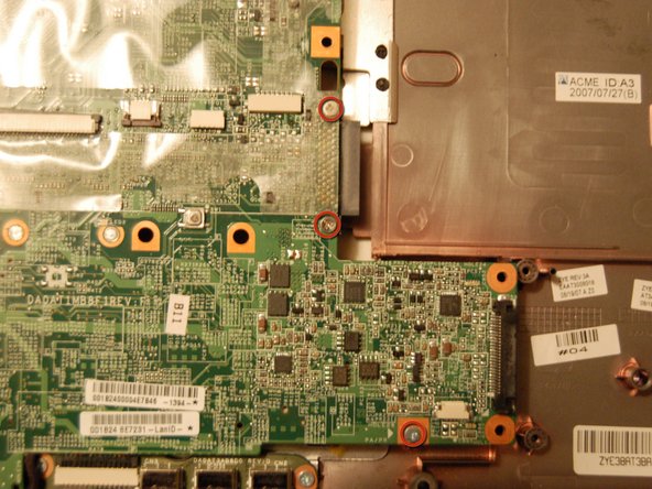

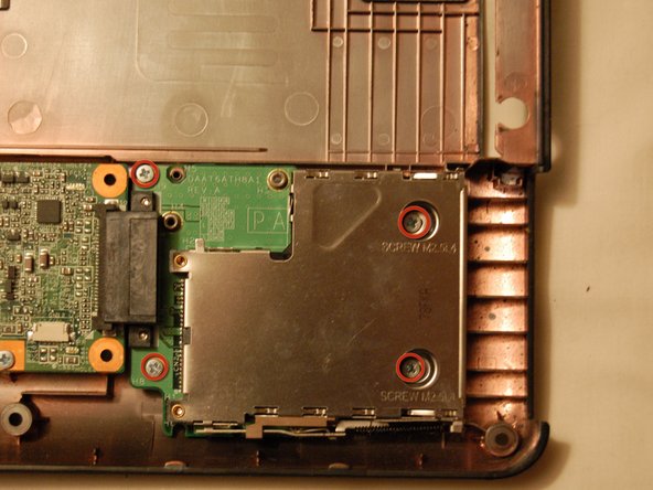

Add Note Edit Step 12  ¶

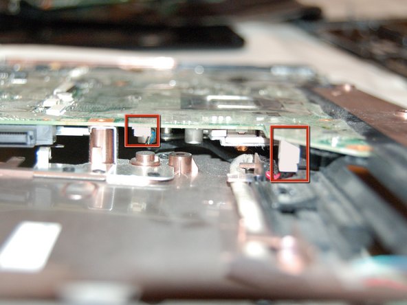

  • Remove these four screws, and pull the express card module away from the motherboard.
  • Remove these three screws, and then these clips, (you can get at them better after you remove the screws, and the larger of the two should come apart first) and lift the board away from the shell, taking care with the audio jack cable.

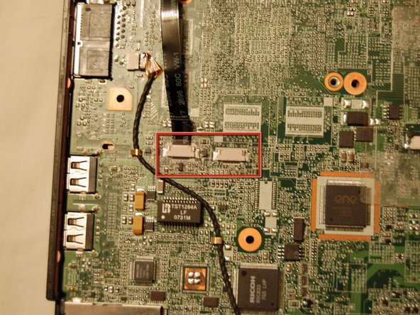

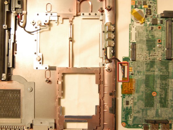

Add Note Edit Step 13  ¶

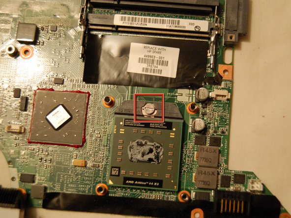

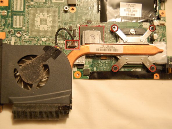

  • You can now unclip the audio jack cable.
  • Heatsink-there are four screws to remove and the clip, and it simply lifts off. The processor comes out by turning this switch to the unlock position. Quite an easy last step.
first image

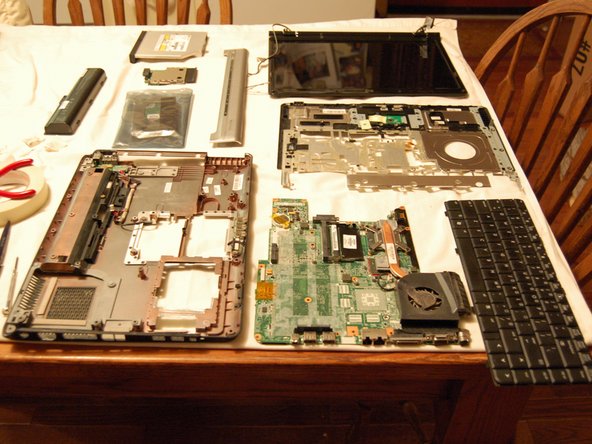

Add Note Edit Step 14  ¶
  • Voila! This layout is without disassembling the heat sink, but I feel it’s adequate. To reassemble, simply reverse the steps in this guide. Good luck!
