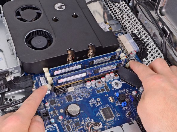

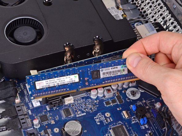

  • The RAM replacement requires flexing a couple of fingers.
  • We would praise the Z1 for having easy-to-remove RAM modules, but then we remembered that most computers have easy-to-remove RAM modules.
  • The Z1 is capable of supporting up to 32 GB of DDR3 RAM. If you have to ask why you need 32 GB, then you clearly don't need it.

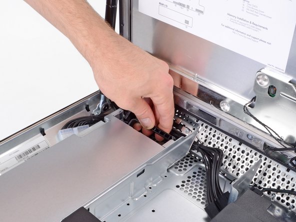

  • Next out is the grab-and-go power supply — 400 watts of "that was easy."
  • We're not nearly as worried about zapping ourselves on this power supply as we are with other, more naked versions.
  • Hopefully, the ease of replacement of the power supply does not fortell an ease of failure.

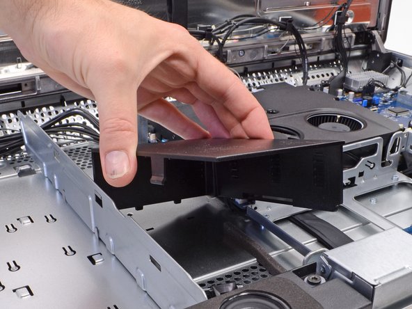

  • If you shell out a few more clams for your Z1, you'll find a fancy schmancy NVIDIA Quadro graphics card here, as seen by HP's artistic rendering in the second image.

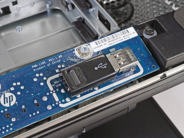

  • The internal USB is a great place to hide the wireless mouse dongle.
    • We would like to take a second to reflect on how awesome this is. Imagine being able to plug in that annoying wireless dongle and never think about it again. Incredible!

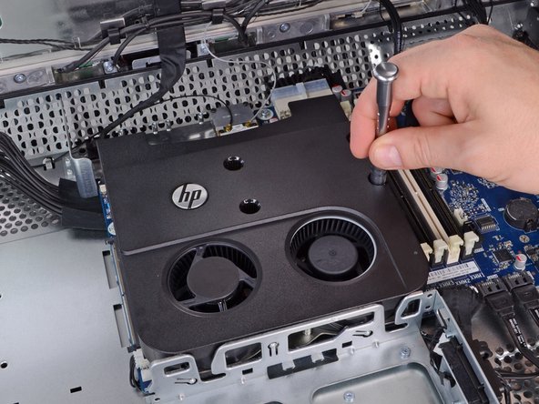

  • Finally! Our first screws. We were beginning to worry there would be no use for our 54 Bit Driver Kit.
  • But even with pesky Torx T15 screws, removing the fans and heatsink from the top of the CPU is super-simple.

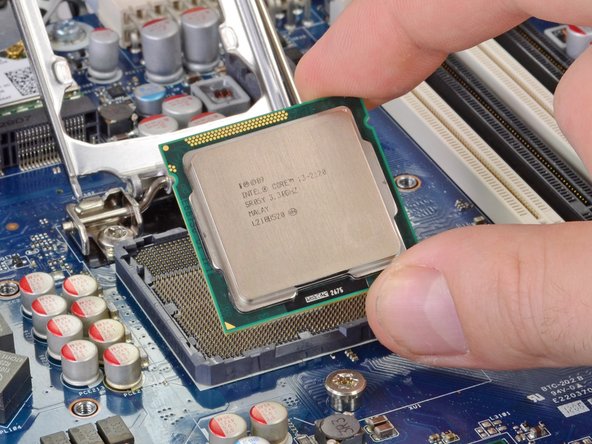

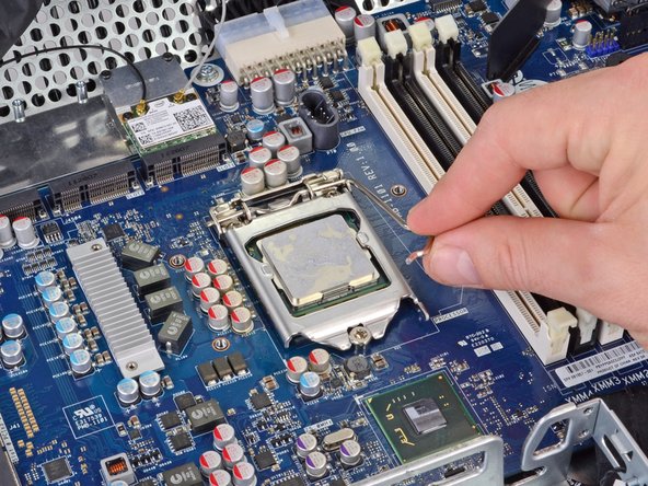

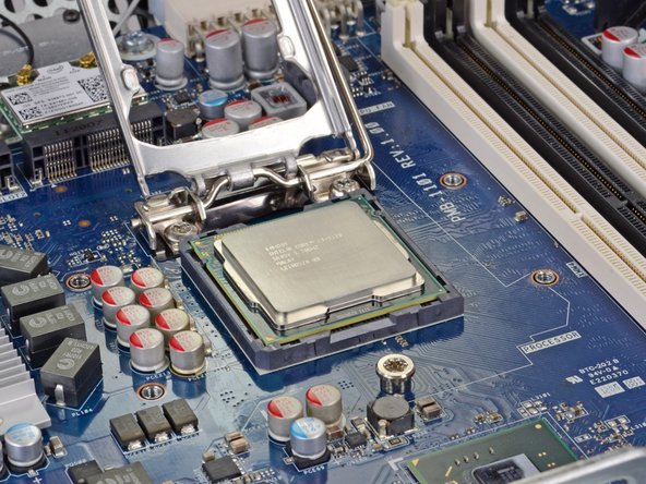

  • This is almost too easy! A simple flip of a lever and the Intel processor practically jumps off the motherboard.
  • These days we mostly encounter soldered-on CPUs on laptops and smartphones, so it's a bit refreshing to touch and feel a nice hunk of CPU silicon in one's hand. Even though this machine is nothing like the PC beige-boxes some of us built back in the day, there's something comforting about holding a can-be-upgraded CPU and inspecting it up close.
  • Fake rumor confirmed: our Z1 did, in fact, come with an Intel Core i3 2120 processor, running at 3.30 GHz.

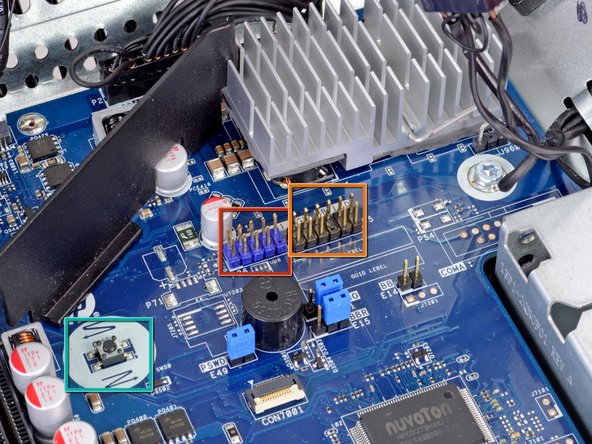

  • According to the Z1 treasure map, this little button is for resetting the CMOS. No more jumpers to short out. Cool.
  • This connector is where the power button plugs into the motherboard.
  • And, according to the same treasure map, this connector allows you to plug in a second internal USB port, should you need another one inside the device.

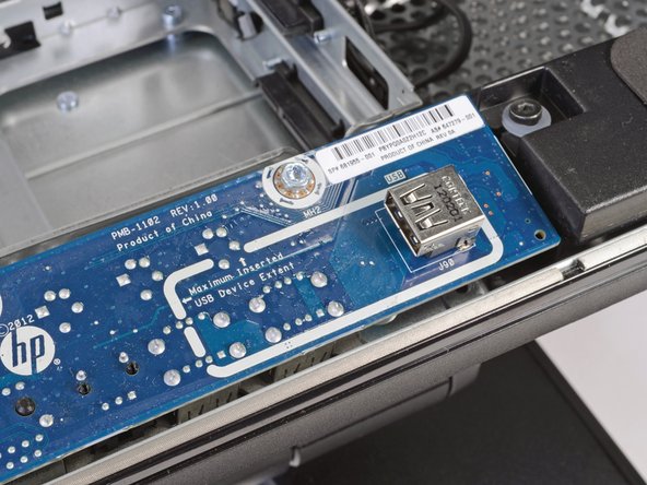

  • Removing the screws around the internal USB port frees the rear I/O board, on which we found:
    • Display In/Out
    • Ethernet Port
    • S/PDIF
    • Four USB 2.0
    • Audio Ports and Subwoofer

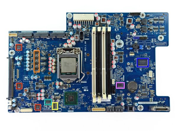

  • We told HP that we were hosting a party, so they brought the chips:
    • Intel Core i3-2120 Processor with Intel HD Graphics 2000
    • Intel BD82C206 Platform Controller Hub
    • ON NCP6151 CPU & GPU Controller
    • Texas Instruments TUSB7320 SuperSpeed USB xHCI Host Controller
    • IDT 92HD91B Audio Codec
    • Texas Instruments DRV604 Line Driver & Headphone Amp
    • MPS MP3399 LED Drivers
Image #1 Image #2
Add Note Edit Step 25  ¶
  • We're going to have to buy some more guacamole to go with all these chips:
    • Parade PS8321 DisplayPort Source 2:1 Multiplexers
    • Alpha & Omega AOZ5006Q1 Synchronous Buck Power Stage Modules
    • Infineon SLB9635TT1.2 TPM Embedded Security Controller
    • NXP 74LVC14AD Hex Inverting Schmitt Trigger
    • Nuvoton NPCD379HAKFX
    • Winbond 250128BVFG

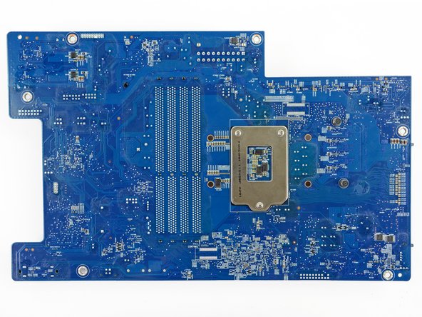

  • Nothing to see on the back of the board. Whew!

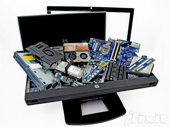

  • The HP Z1 sets an unprecedented Repairability Score: 10 out of 10! (10 is easiest to repair)
  • Modular construction allows the user to replace most major components in five minutes.
  • Non-modular components inside are held in place by T15 or T6 Torx screws, or by plastic fasteners. No glue or other funny business is used inside, aside from a taped-down thermal sensor.
  • HP offers the user a host of options on how to fix/troubleshoot the device: a helpful diagram on the inside of the machine, a set of PDF manuals on how to service the machine, and even videos for the major repair procedures!
  • The glass and LCD are the hardest to replace, but still not supremely difficult -- just a bit bulky to move around. They're not fused together, and are instead held in place by those wonderful T15 Torx screws. The most difficult repair in this machine should take under an hour to complete.
