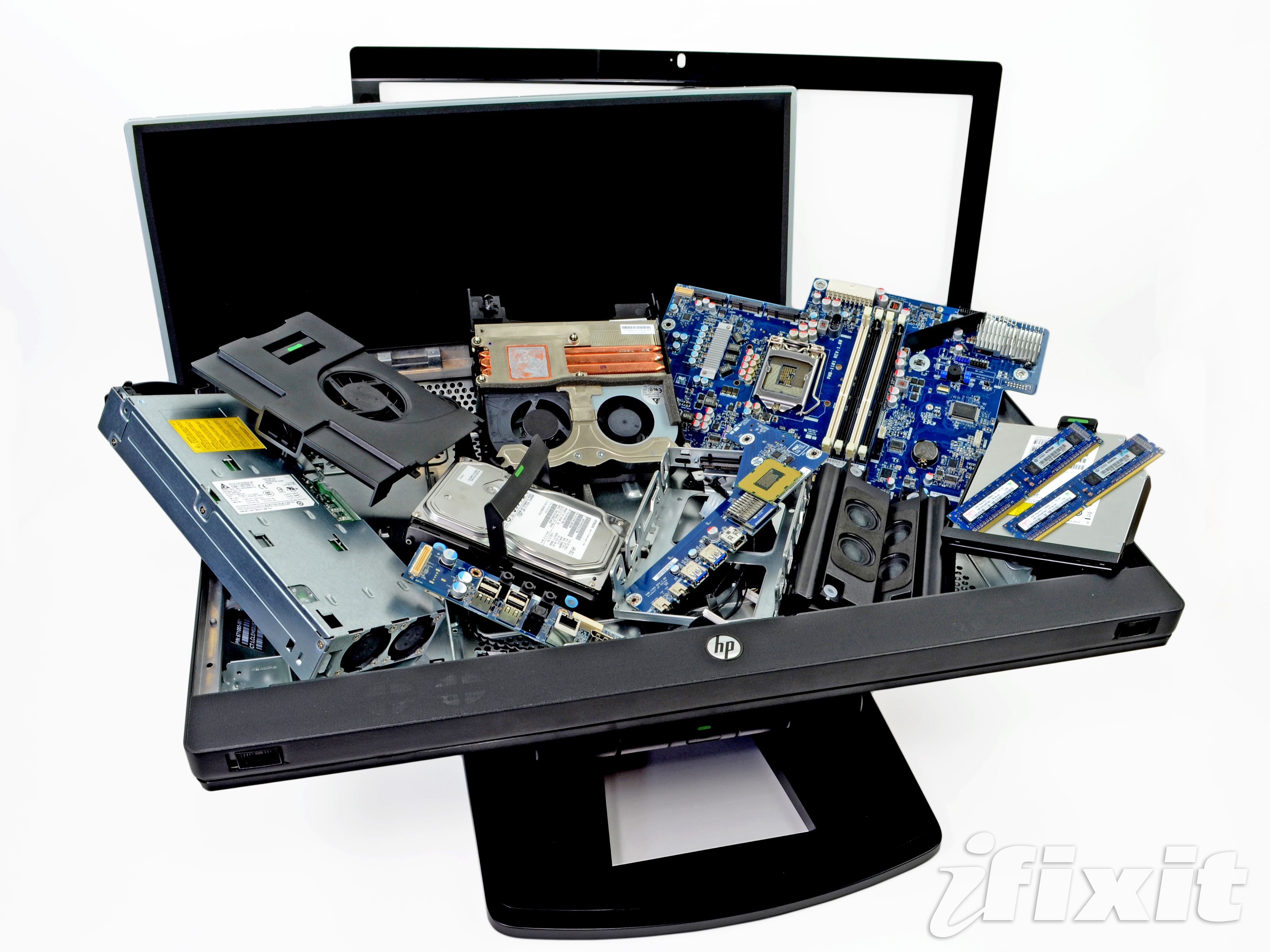

We figured this machine was right up our alley. How could we resist a device with this kind of introduction: "Introducing the HP Z1, the world's first all-in-one workstation with a 27” (diagonal) display that snaps open to let you swap out parts and make upgrades. No tools required."
So how repairable/upgradeable is the Z1? Join us in this journey as we take apart HP's newest innovation in PCs, the HP Z1 Workstation.

  • Here it is, the HP Z1 workstation. Collapsed down, the Z1 folds flat for easy-to-access component repairs.
  • Under the hood the Z1 houses:
    • Dual-core Intel® Core™ i3-2120 Processor
    • 27" 2560x1440 pixel, diagonal LED-backlit IPS display
    • Four memory slots for up to 32 GB DDR3 RAM
    • SATA 7200 RPM, 500 GB Hard Drive
    • An internal USB port
