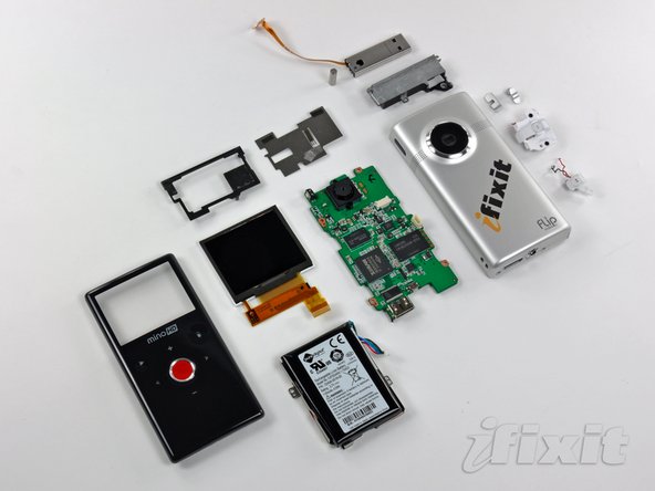

We got our hands on the fun Flip MinoHD digital video recorder and decided to take a peek inside. We were curious to see what kind of electronics were packed into this simplistic half-aluminum, half-plastic device.

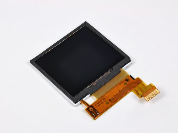

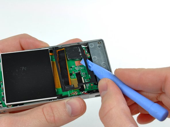

  • Use a plastic opening tool to carefully lift the top edge of the display out of its bracket.
  • It may be necessary to use a metal spudger to release a small piece of film stuck between the LCD and the display bracket.
Image #1 Image #2 Image #3
Add Note Edit Step 9  ¶

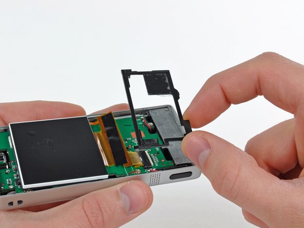

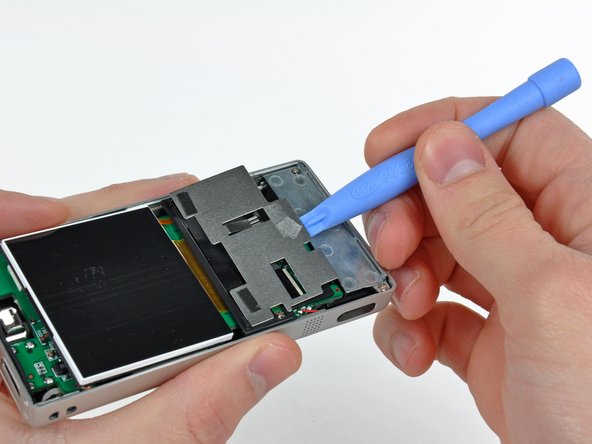

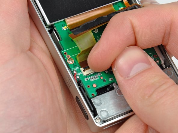

  • To access the display data cable, use a plastic opening tool to pry the metal and plastic display brackets off the logic board.
Image #1 Image #2
Add Note Edit Step 10  ¶
  • Carefully use your fingernail to flip up the retaining flap on the display data cable ZIF socket.
  • Pull the display data cable out of its socket and remove the display.
  • Interesting note: On-board video playback is provided by a 2" 960x240 transflective TFT LCD display.

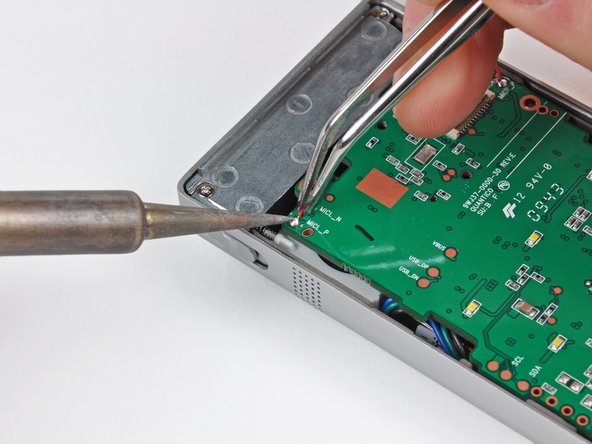

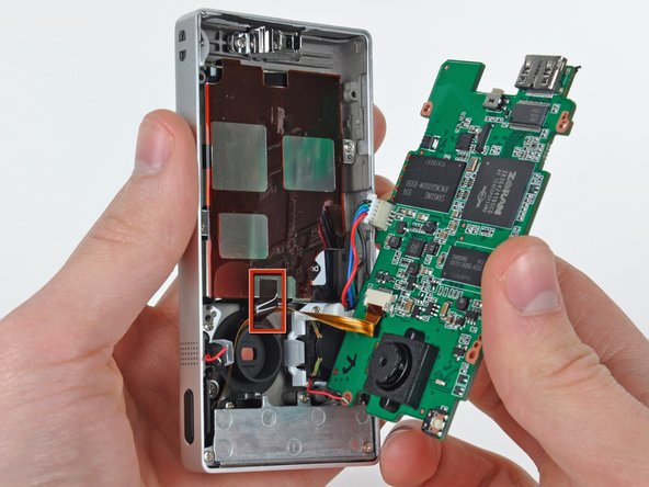

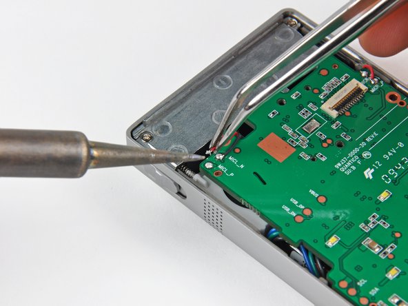

  • Remove the four silver Phillips screws attaching the logic board to the outer case.
  • To remove the logic board, you must first de-solder the leads of both microphones from the logic board. When soldering on a circuit board, be sure not to heat up the connection excessively.
  • Use a pair of tweezers to gently pull each lead as you heat up the joint with the tip of a soldering iron.
  • Repeat this process to remove all four microphone leads. Their locations are boxed in orange on the first picture.
Add Note Edit Step 12  ¶

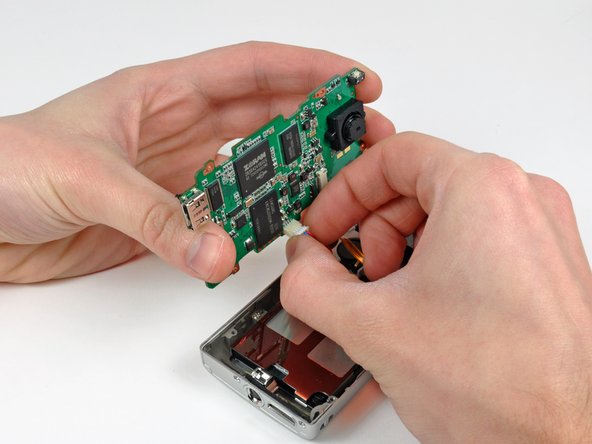

  • Carefully maneuver the logic board out of the outer case, minding the cables still connecting the two components.
  • To gain more clearance, remove the small strip of black tape securing the USB ribbon cable to the battery bracket.
  • Use a pair of tweezers to pull the USB ribbon cable connector away from its socket.
  • Pull the battery connector out of its socket on the logic board.

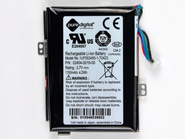

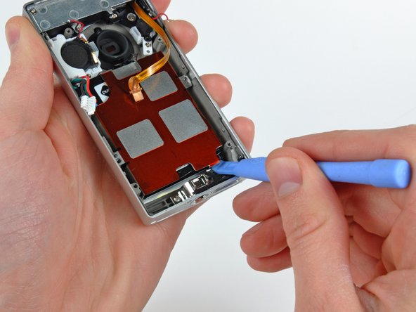

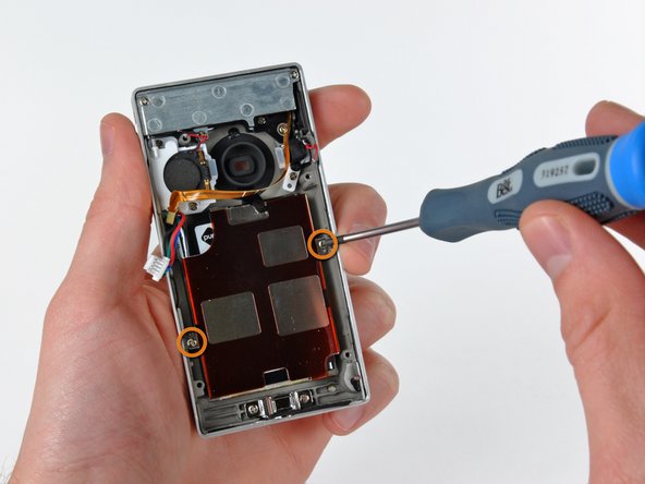

  • Remove the two small silver Phillips screws securing the battery to the outer case.
  • Use a plastic opening tool to pry the battery up off the outer case.
  • The MinoHD sips two hours worth of power from the internal 3.7V, 1150 mAh Li-ion battery weighing in at 30 grams (including bracket).
  • Coincidentally, that's the same battery capacity as the iPhone 3G.

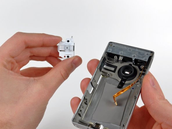

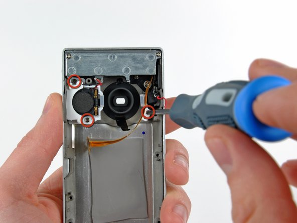

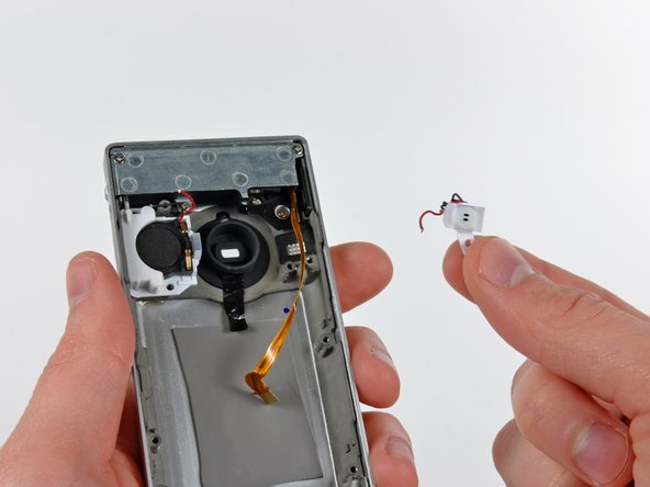

  • Remove the three Phillips screws securing both microphones to the outer case.
  • The microphone assembly on the left also houses a small speaker for audio during video playback. It connects to the board via two spring-loaded pressure contacts.
  • Lift both microphones off the inner surface of the outer case.

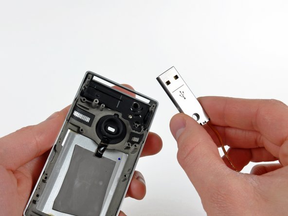

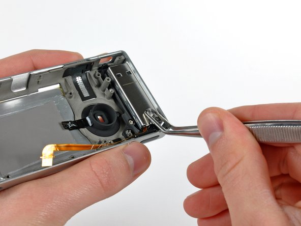

  • Remove the four Phillips screws securing the aluminum USB bracket to the outer case.
  • Use a pair of tweezers to pull the flip-up USB axle away from the outer case.
  • Once the axle clears the outer case, the flip-up USB connector may be ejected at high speed. Wear safety glasses.

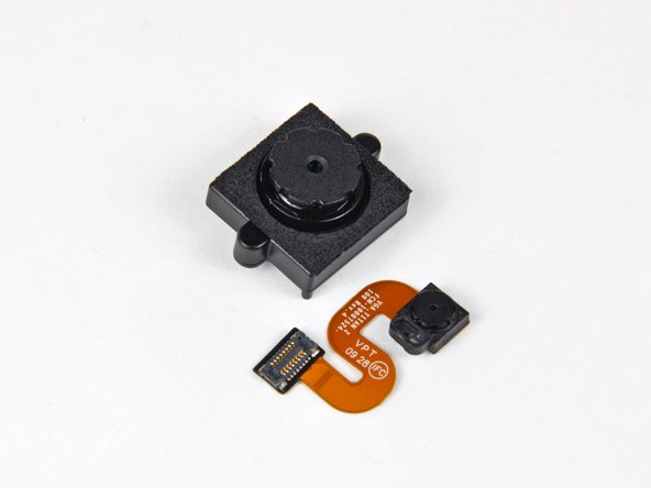

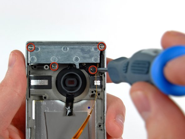

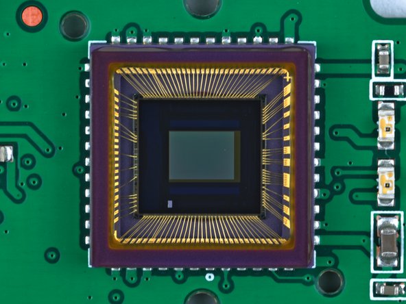

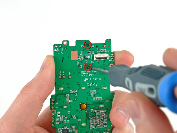

  • Remove the two Phillips screws securing the camera lens to the logic board.
  • Lift the camera lens off the board to reveal the CMOS sensor.
  • The high definition CMOS sensor has .0000022 meter wide pixels to capture clear 720p video.

  • Side-by-side comparison shot:
    • Flip MinoHD camera lens.
    • iPod nano 5th Generation camera assembly.
  • The MinoHD has a fixed focus lens that ranges from 0.8 m to infinity.

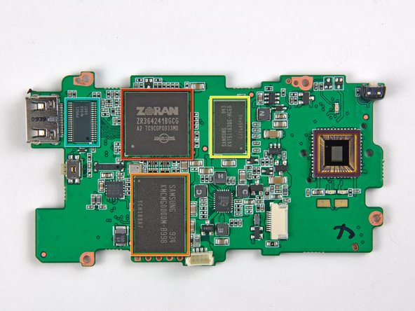

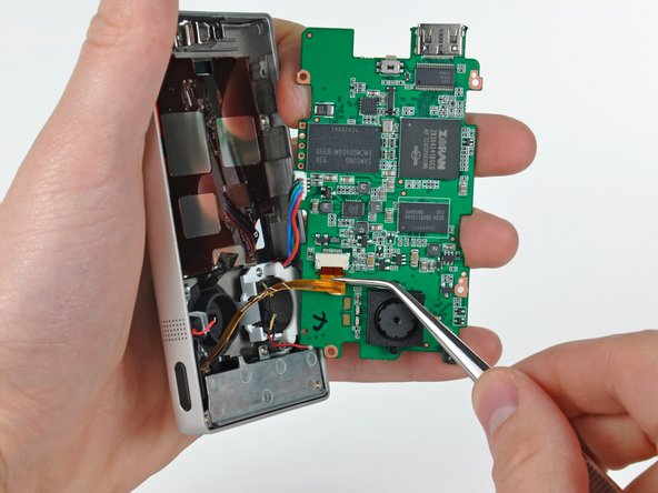

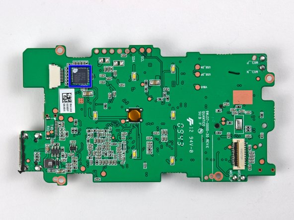

  • The big players on the logic board include:
    • A Zoran COACH (camera on a chip) 12 processor featuring real-time lens distortion compensation and noise reduction.
    • Samsung's 934 KMCMG0000M-B998 8 GB NAND flash memory for video storage.
    • One Samsung K4T51163QG 512 Mb DDR2 SDRAM chip.
    • Texas Instruments' TPD12S521 to protect the board from electrostatic discharge through the HDMI port.
    • Cypress' CY821434-24LXTI PSoC presumably for encoding signals received from the capacitive touch controls.
  • High-Res versions of the logic board pictures can be seen here and here.
