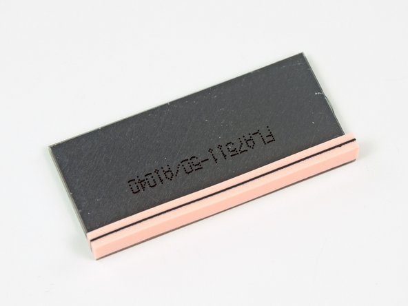

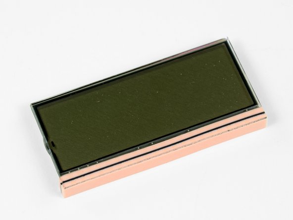

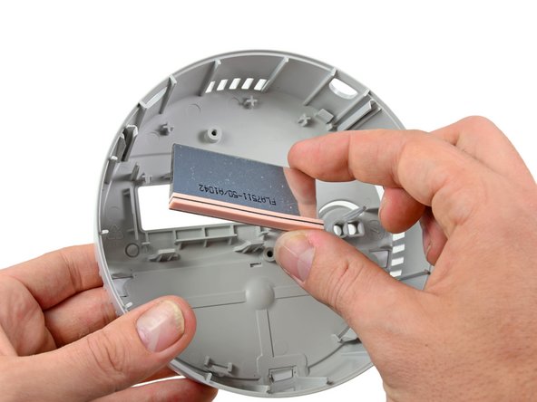

    • Lastly, we can remove the LCD.
    • As you can see, the monochrome LCD does not have any ribbon cables connecting it to the motherboard.
    • It seems to work via a method of conduction, where the bottom black strip comes into contact with pads on the motherboard, thus producing an image.
    • This method of LCD connection is very common, and the black and pink strip is called a "zebra connector."

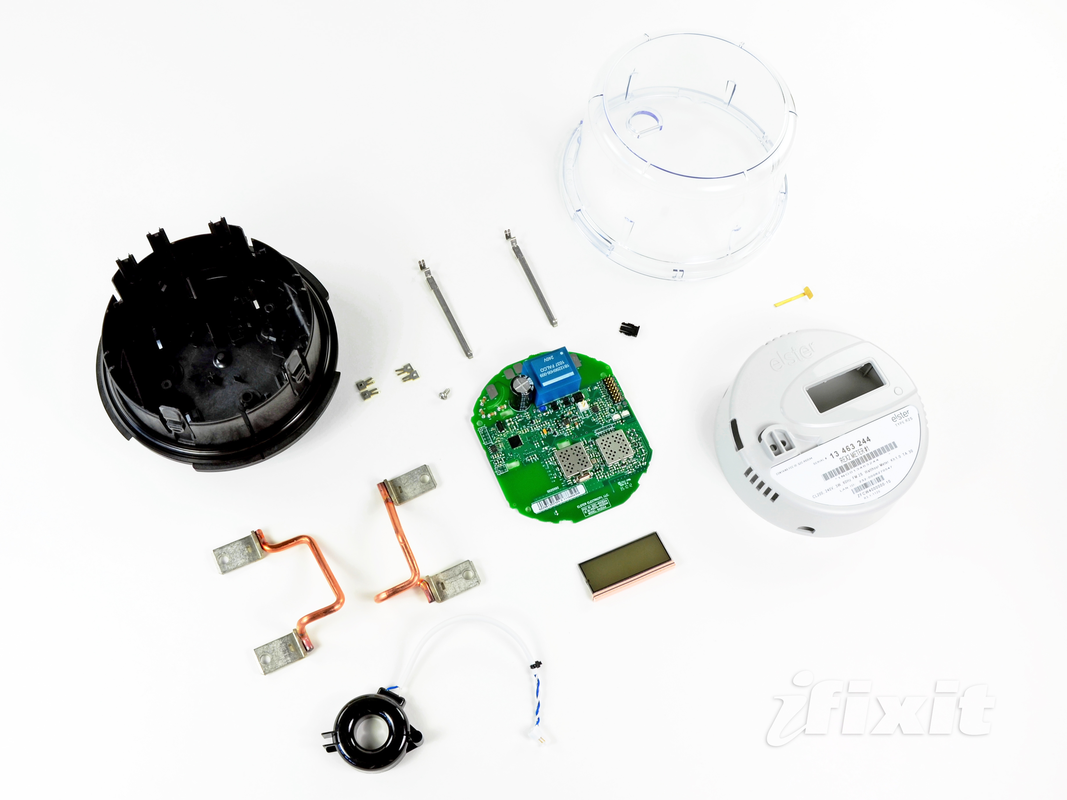

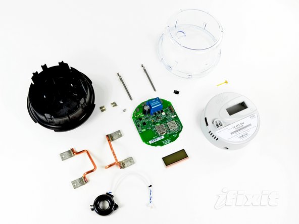

    • Normally we'd assign a Repairability Score on the last step, but we don't feel it's appropriate for this device. After all, there's a tamper-evident security seal for a reason.
    • Even so, we're glad to know that the smart meter doesn't have easily-breakable internal components, and can be serviced without difficulty by an authorized service technician.
    • A big thanks to Elster for providing us one of these meters! We certainly didn't want to take ours off the grid in order to mess around with it.
