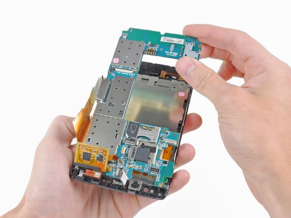

Add Note Edit Step 9  ¶

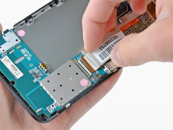

  • Before lifting out the motherboard, the touchscreen, LCD, and control button ribbon cables must be disconnected.
first image
thumb image 1
thumb image 2
thumb image 3

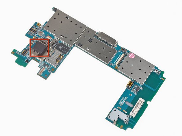

Add Note Edit Step 10  ¶

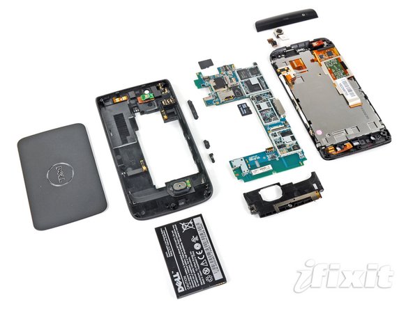

  • The "C"-shaped motherboard comes out easily. Rather than using daughterboards like the Droid 2, the Streak has all components attached to this singular motherboard.
    • This is most likely due to the extra space afforded by designing the Streak around its 5" LCD.
  • A 2 GB non-user accessible microSD card can be seen near the top of the motherboard.
    • This card is used to house system & applications files only, and Dell doesn't want you to remove it.

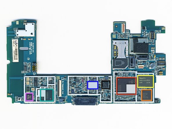

Add Note Edit Step 11  ¶

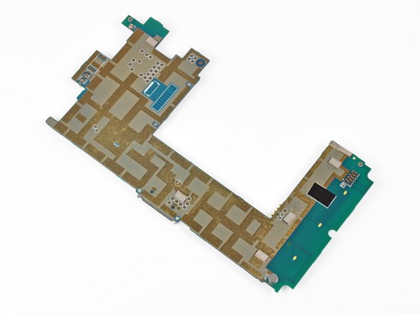

  • Big players on the motherboard include:
    • Qualcomm QSD8250 Snapdragon processor
    • Analog Devices ADV7520 Low Power HDMI™/DVI Transmitter
    • Hynix H8BES0UU0MCR NAND-based MCP
    • Qualcomm MXU6219 RF Transceiver
    • Qualcomm PM7540 Power Management chip
    • TriQuint Semiconductor TQS 7M5012 Power Amp (Quad-band GSM)
    • Texas Instruments TPS 65023 Integrated Power Management IC

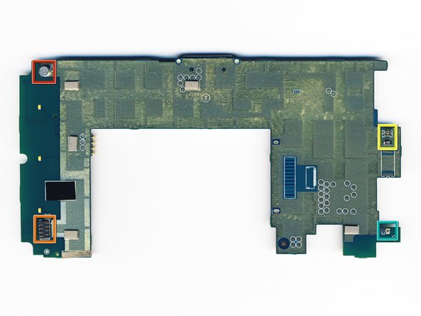

  • The back of the motherboard is relatively featureless, with a few notable exceptions:
    • Microphone
    • Pressure contacts for the capacitive controls on the lower bezel
    • Proximity sensors to tell the touchscreen when your face is pressed against it
    • Ambient light sensor for the front-facing camera.

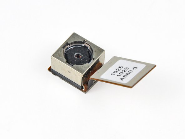

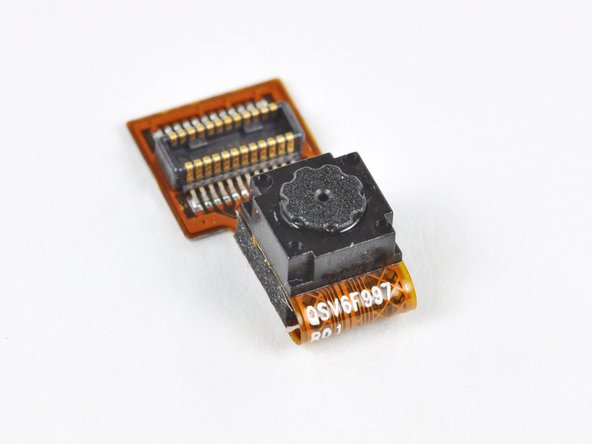

Add Note Edit Step 13  ¶

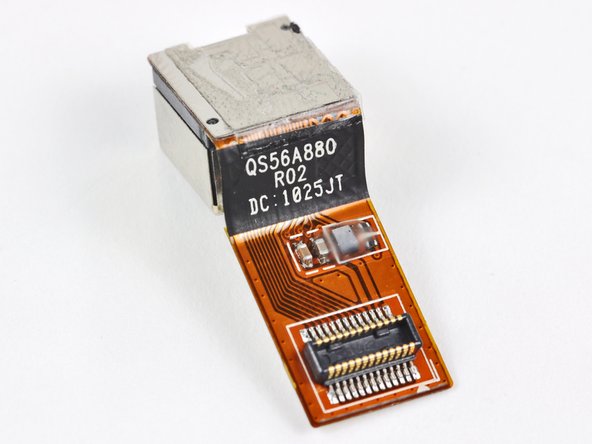

  • The Streak's cameras pretty closely resemble the iPhone 4's front and rear facing cameras.
  • The auto-focus rear-facing camera is good for 5 MP still images, while the front-facing camera shoots at VGA quality.

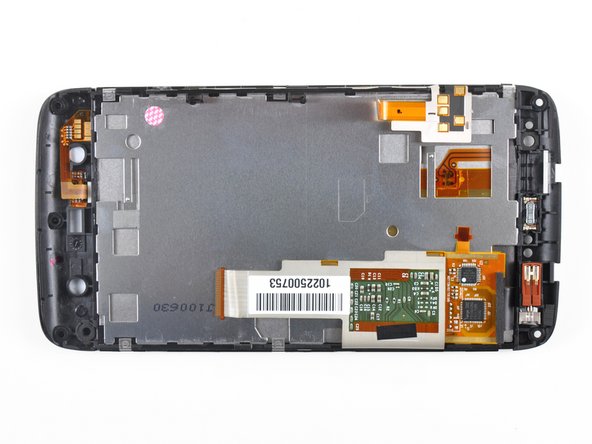

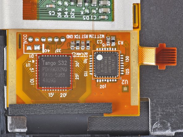

Add Note Edit Step 14  ¶

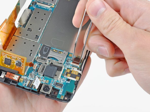

  • Sadly, the Streak's LCD is permanently adhered to the front panel glass. However, that LCD/glass subassembly is held in the front panel with very strong 3M adhesive, and could be removed with enough careful prying.
    • The LCD is bonded to the front panel glass to increase the strength of the device and sensitivity of the capacitive touch panel.
  • The inner face of the front panel assembly isn't all that exciting. The ear speaker and vibrator motor can be seen near its top edge.
  • The touchscreen ribbon cable houses:
    • Pixcir's controversial Tango S32 Touchscreen controller
    • Atmel's ATmega168P 8-bit AVR microcontroller
