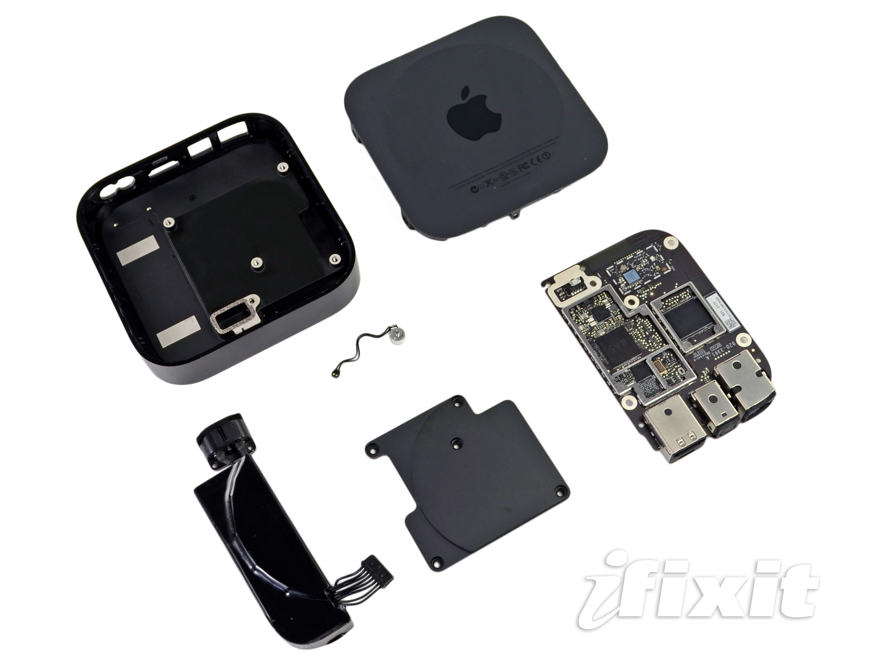

  • Looking closely it appears that there is another difference from the Apple TV 2nd Generation, two antennas!
  • While it is unclear where the two antennas terminate, we suspect Apple added the second antenna to address some complaints about range and signal strength in the previous model.
  • According to Broadcom, the BCM4330 can either function with a single-band 2.4 GHz 802.11 b/g/n (single shared 2.4 GHz antenna for Bluetooth and WLAN) or a dual-band 2.4 GHz and 5GHz 802.11 a/b/g/n antenna.
    • We're suspecting that this Apple TV is preserving the 2.4GHz shared antenna, but has also added a second antenna for 5 GHz connectivity.
Image #1 Image #2
Add Note Edit Step 11  ¶
  • Apple TV (3rd Generation) Repairability: 8 out of 10 (10 is easiest to repair).
    • Only six parts in a very easy-to-dissemble case.
    • Separate power supply, which is easy to get to and replace in case your old one ever decides to jump off a cliff.
    • No glue, thermal paste, gum, peanut butter holding things in place...
    • Standard screws, no endangered species screwdrivers necessary.
    • The logic board contains all the components, which means if something breaks, it could be expensive to replace -- unless you prefer to do board-level soldering.
