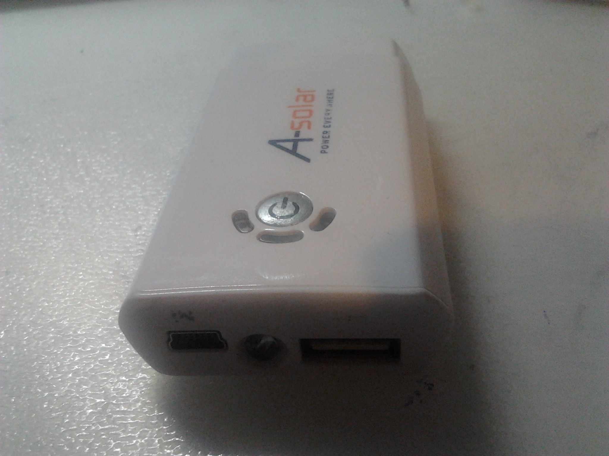

  • There are three blue LEDs to show you the power in the battery.
  • There is also a handy LED to see what you are doing in the dark.

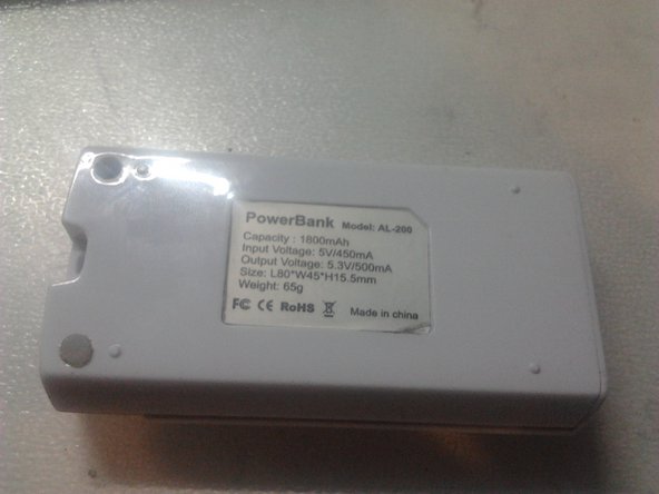

  • The bottom of the device.

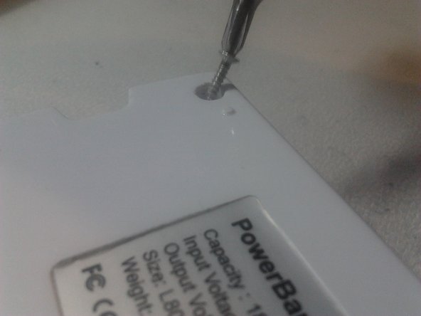

  • It's time for some prying. Take out the rubber plugs at the bottom of the device.
  • Remove the screws which are underneath the plugs.

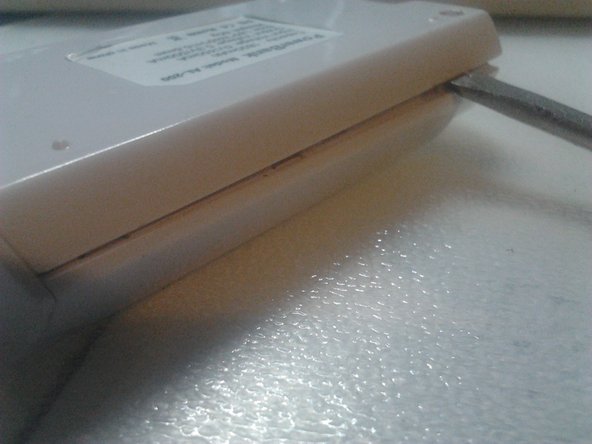

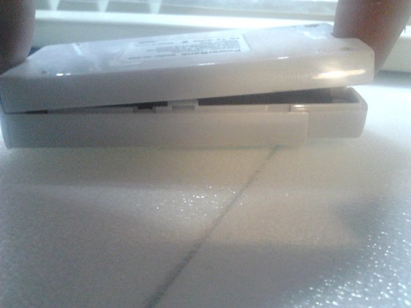

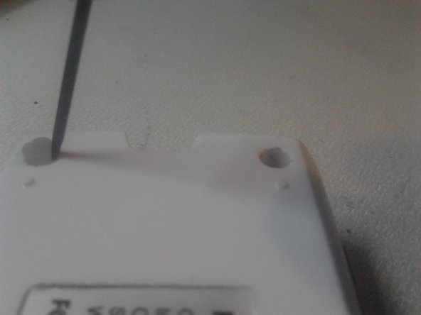

  • use a flathead screwdriver or a spudger to pry open the device.
  • Don't pry at the front of the device - there are a few hooks and you do not want to break them.

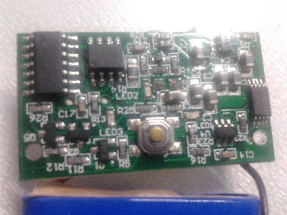

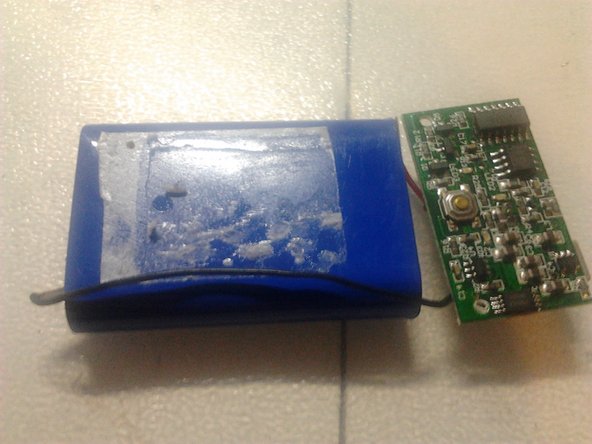

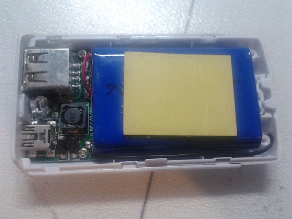

  • A first glance at the inside: a big battery and the logic board.
  • There is a 1800 mAh battery in it.
  • There are two screws in the logic board, the battery is glued to the casing.

  • The other side of the electronics.
  • And the logic board.

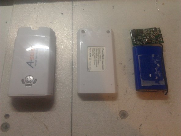

  • And there it is: the A-Solar PowerBank AL-200 torn down.
  • It was easy to do.
