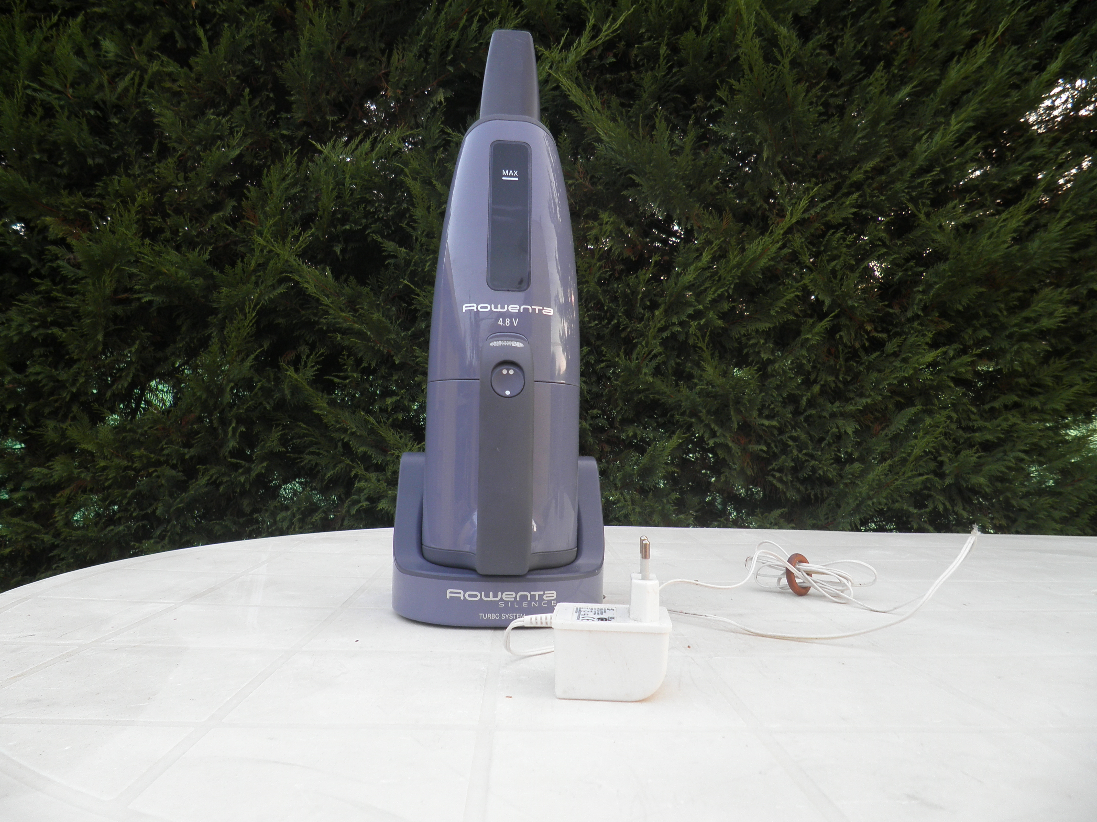

  • So, here is it: a 4.8V Rowenta vacuum. Useful if you want to clean your car or something else, it can be recharged with its pedestal.
  • If you are interested in the power of the pedestal, it reads:
    • Input: 230V - 50 Hz - 7W (AC)
    • Output: 7.5V - 300 mA (DC)

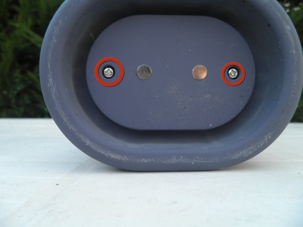

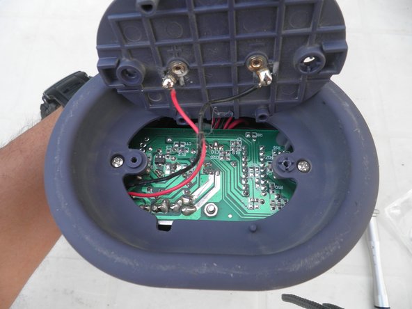

  • Let's go (let's start with the engine): with our beloved screwdriver, remove these 2 Philips #00 screws.
  • After that, we can see the back of the motherboard.

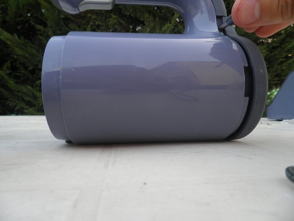

  • Now, remove these 2 screws (Philips #00 again).

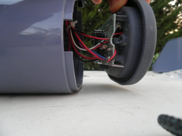

  • Then, with a flat screwdriver (put the screwdriver between the both parts and turn it), remove the back and let's take a look inside.
Image #1 Image #2
Add Note Edit Step 5  ¶

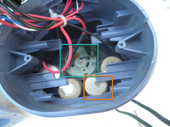

  • Now, here is the innards of our lovely vacuum.
  • More precisely, we can see several wires (to connect the charger light (2), the switch (3), the engine (2), the power wires (2)).
  • In green: the engine, very noisy but it's the core of the machine.
  • And in orange: one of the 4 batteries (4*1.2V). They look like C batteries...

  • The motherboard: the top contains 2 capacitors, one chip, several wires and several resistors.
  • But the bottom is not interesting (there's just a lot of resistors).

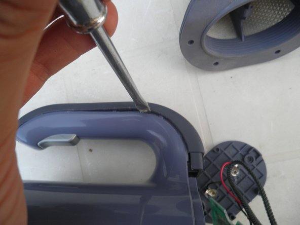

  • With the same screwdriver, remove the only screw which secures the handle.
  • But to have access in the handle, you'll have to use a flat screwdriver because it's difficult to open it.
  • However, I wanted it to still works. So, I didn't go further in the teardown. Sorry...
