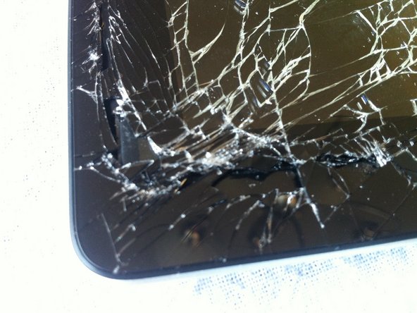

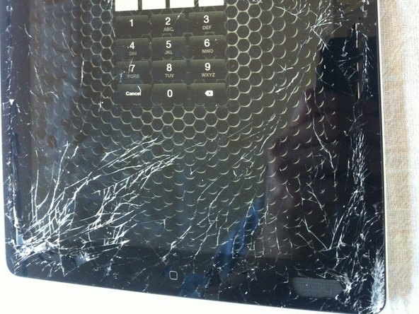

Accidentally snagged my headphone cord on my foot while climbing over my kid's baby gate. Yanked iPad out of my hand slapping it down on my ceramic tile floor screen first. Completely shattered the glass all the way around. Think "BELLY FLOP"!
