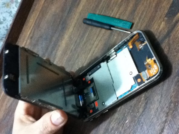

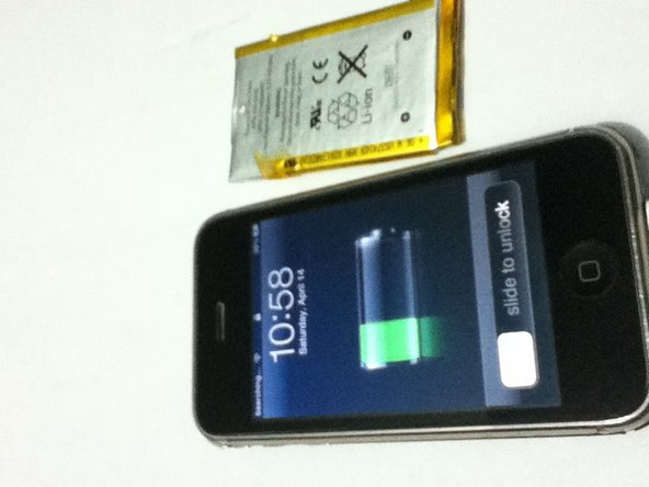

My iPhone 3gs started acting crazy, it would shut down randomly, even if it was 100% charged, except when it was connected to the power.
Since I consider myself "The geek of the family" I decided to risk $20 bucks plus my iPhone and decided to do it by myself. I ended up saving $30 bucks if I had taken it to a cellphone repair place, and I learned more about iPhone.
My Fix

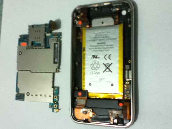

Everything went smooth until I got to the battery, it grave me some troubles to take it off, but finally everything went perfectly.
My Advice
Always have the installing directions on hand.
Print out or draw a layout of your device to place the screws where the belong to, so that they will not mix out. DON'T make lever from the top of your iPhone/pod when taking the battery out, mine made a crack sound, I thought it was broken but everything turned out great.
