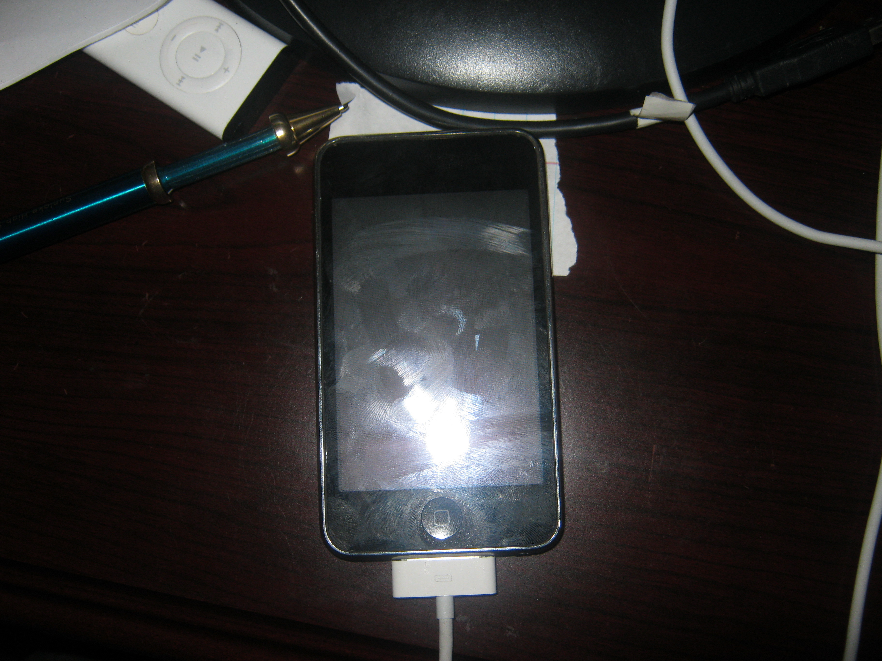

Image #1
Add Note Edit Step 1 — Downgrade  ¶
  • You will need to know your firmware to be able to get a correct, down gradable firmware in some cases. it is recommended that you know it anyway.
  • http://www.felixbruns.de/iPod/firmware/
  • Put the .ipsw file somewhere easily accessible, like on your desktop.

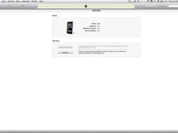

Add Note Edit Step 4  ¶
  • Open up iTunes, then iTunes will say that your iPod is in recovery mode.
