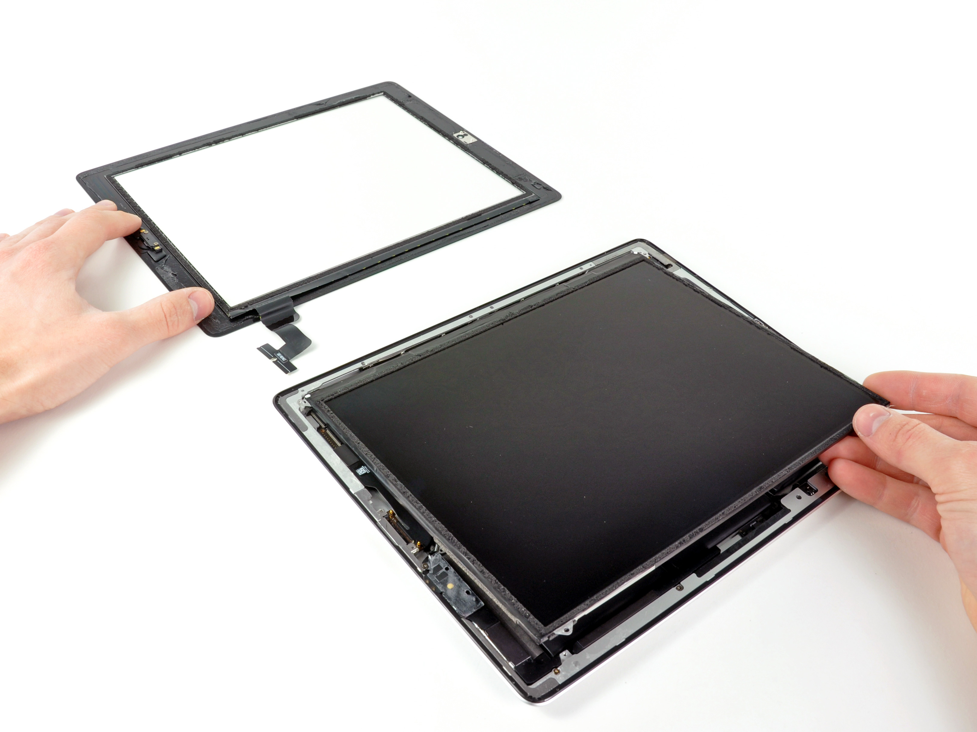

  28. iPad 2 Wi-Fi EMC 2415 Front Panel Assembly Replacement, LCD: step 28, image 1 of 1
    • Remove the four 2.0 mm Phillips screws securing the LCD to the rear case.
  29. iPad 2 Wi-Fi EMC 2415 Front Panel Assembly Replacement: step 29, image 1 of 2 iPad 2 Wi-Fi EMC 2415 Front Panel Assembly Replacement: step 29, image 2 of 2
    • The front panel ribbon cables are connected beneath the LCD. To access them, you'll need to temporarily flip the LCD over and out of the way.
    • Be very careful when moving the LCD, and do not attempt to remove it from the iPad—its display data cable will remain connected while it is rotated over.
    • Lift the LCD from its long edge closest to the volume buttons and gently flip it out of the rear case—like turning the page in a book.
    • Set the LCD face down on the front panel.
  30. iPad 2 Wi-Fi EMC 2415 Front Panel Assembly Replacement, Front Panel Assembly: step 30, image 1 of 2 iPad 2 Wi-Fi EMC 2415 Front Panel Assembly Replacement, Front Panel Assembly: step 30, image 2 of 2
    • Use the edge of a plastic opening tool to carefully flip up the retaining flaps on the two digitizer ribbon cable ZIF sockets.
    • Be sure you are prying up on the hinged retaining flaps, not the sockets themselves.
    • The retaining flaps are highlighted in red in the second picture.
  31. iPad 2 Wi-Fi EMC 2415 Front Panel Assembly Replacement: step 31, image 1 of 2 iPad 2 Wi-Fi EMC 2415 Front Panel Assembly Replacement: step 31, image 2 of 2
    • Use the edge of a plastic opening tool to peel the digitizer cable off the shields on the logic board.
    • Carefully pull the digitizer cable off the adhesive securing it to the side of the rear case.
  32. iPad 2 Wi-Fi EMC 2415 Front Panel Assembly Replacement: step 32, image 1 of 1
    • Pull the digitizer ribbon cable straight out of its two sockets on the logic board.
  33. iPad 2 Wi-Fi EMC 2415 Front Panel Assembly Replacement: step 33, image 1 of 2 iPad 2 Wi-Fi EMC 2415 Front Panel Assembly Replacement: step 33, image 2 of 2
    • In order to remove the front panel assembly, the ribbon cable needs to slide out between the case and the LCD. You'll need to move the LCD to make some room.
    • Be very careful when moving the LCD, and do not attempt to remove it from the iPad—its cable will remain connected while it is rotated over.
    • Lift the LCD from its long edge farthest from the digitizer cable and gently flip it toward the rear case—like closing a book.
    • While holding the LCD up, gently slide the front panel away from the iPad. Be careful not to snag the digitizer cable on the rear case or LCD.
    • Set the LCD back into the body for safekeeping.
To reassemble your device, follow these directions in reverse and use our iPad 2 Wi-Fi Front Panel Adhesive strips guide to reattach the front panel.
