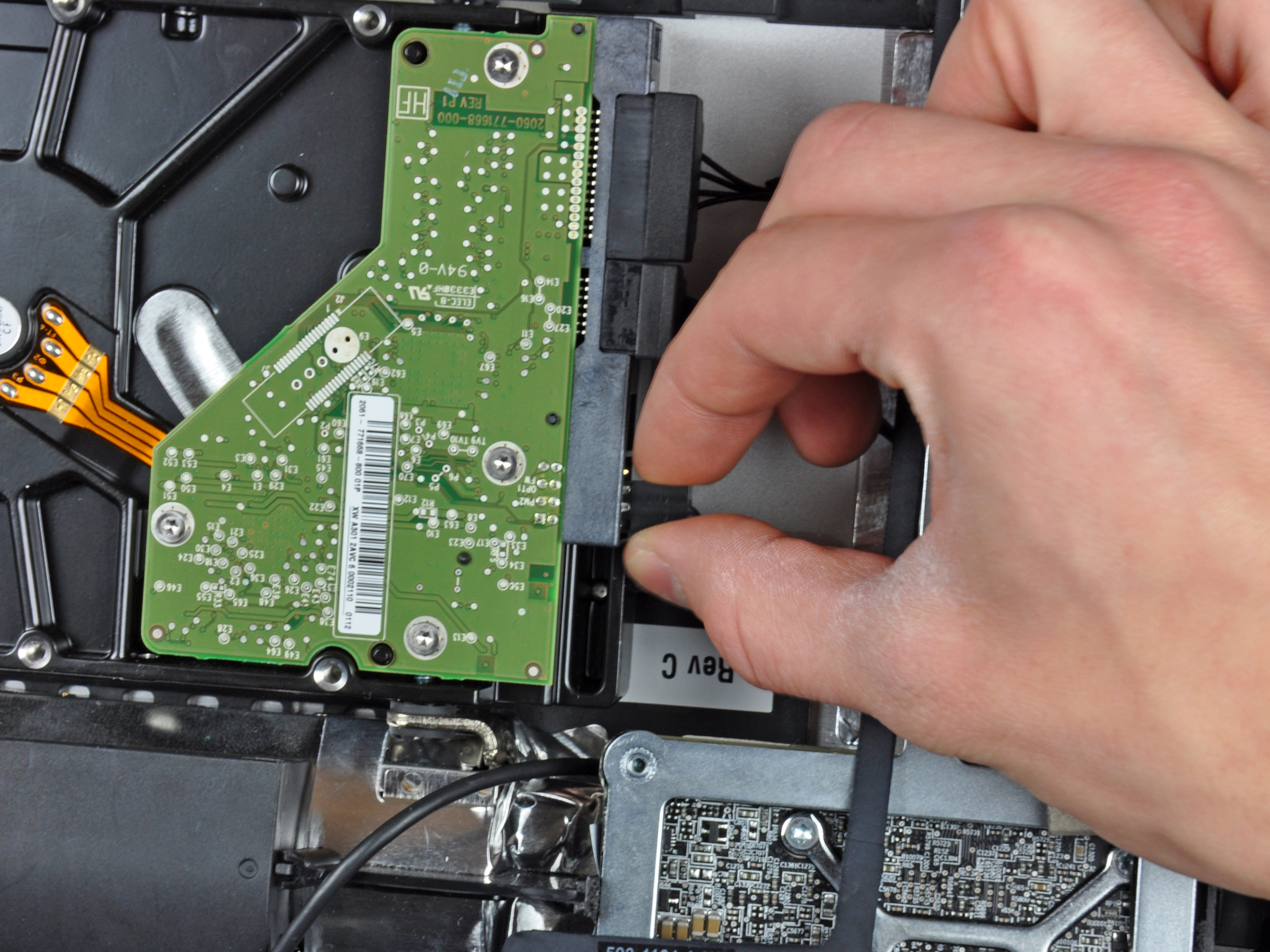

Add Note Edit Step 10 — Hard Drive Replacement  ¶
  • Disconnect the thermal sensor, SATA power, and SATA data cables by pulling their connectors away from the sockets on the hard drive.
  • When plugging the thermal sensor connector back into the hard drive, be sure it is inserted onto the set of pins closest to the SATA connectors and that the black wire of that connector is closest to the LCD.
