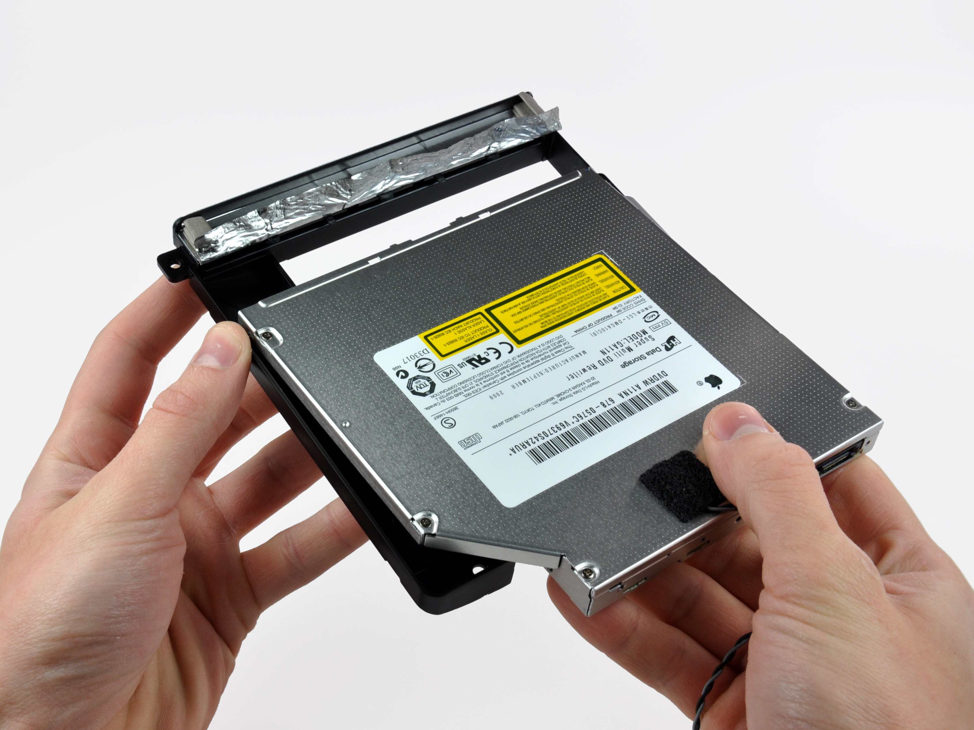

iMac Intel 21.5" EMC 2389 Optical Drive Replacement
Replace the optical drive in your iMac Intel 21.5" EMC 2389.
Use this guide to replace a burned-out optical drive.
