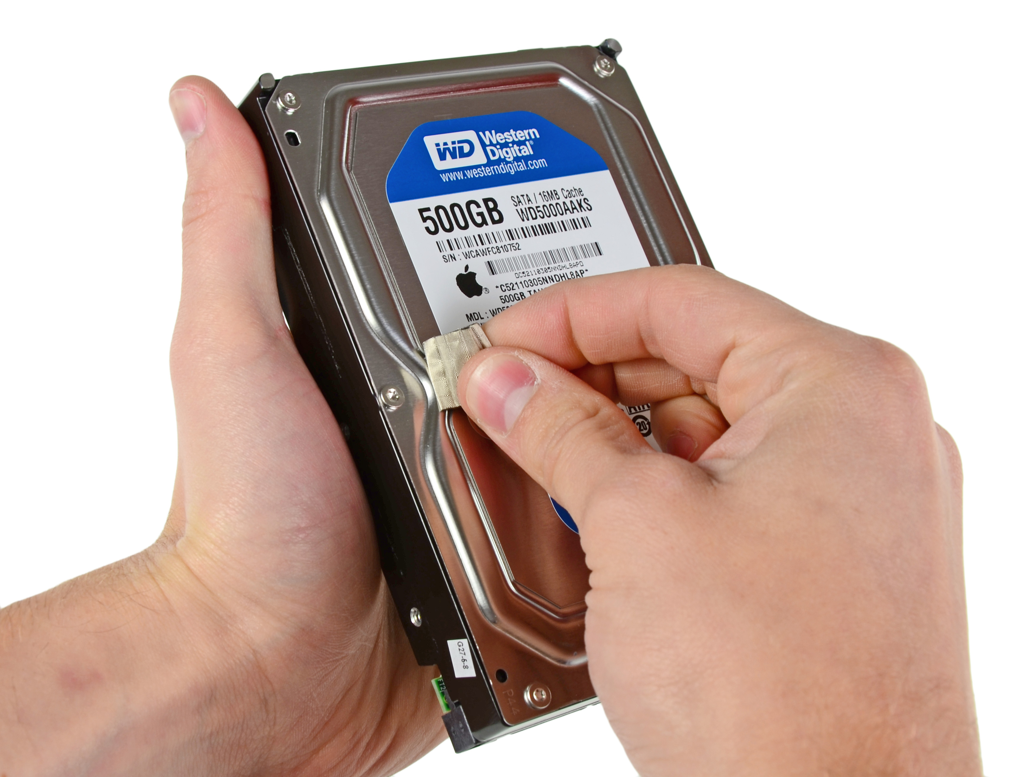

Add Note Edit Step 17  ¶
  • Carefully peel off the piece of EMI foam attached to the front of the hard drive.
  • Don't forget to transfer this to your new hard drive.
