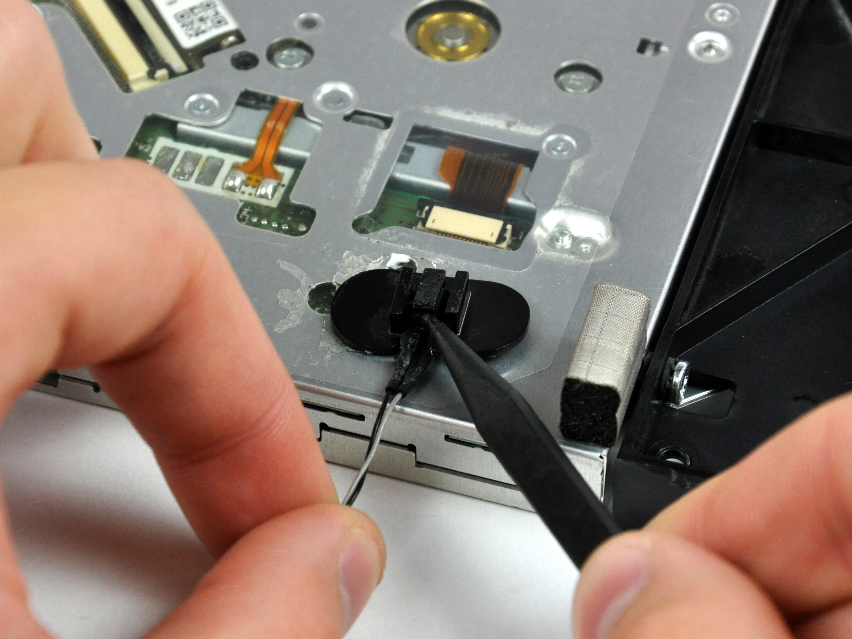

Add Note Edit Step 18 — Optical Drive Replacement  ¶
  • If necessary, remove the piece of foam tape covering the optical drive thermal sensor.
  • To remove the optical drive thermal sensor, use the tip of a spudger to lift the center finger of the thermal sensor bracket while applying slight tension to the thermal sensor cable.
  • If your thermal sensor is stuck to the optical drive, skip to the next step.
first image
Add Note Edit Step 19  ¶
  • Use the flat end of a spudger to pry the optical drive thermal sensor bracket up off the adhesive securing it to the optical drive.
  • If the adhesive gets dirty or will not stick to your new optical drive, place some double-sided tape under the two semicircular ears of the thermal sensor bracket.
first image
