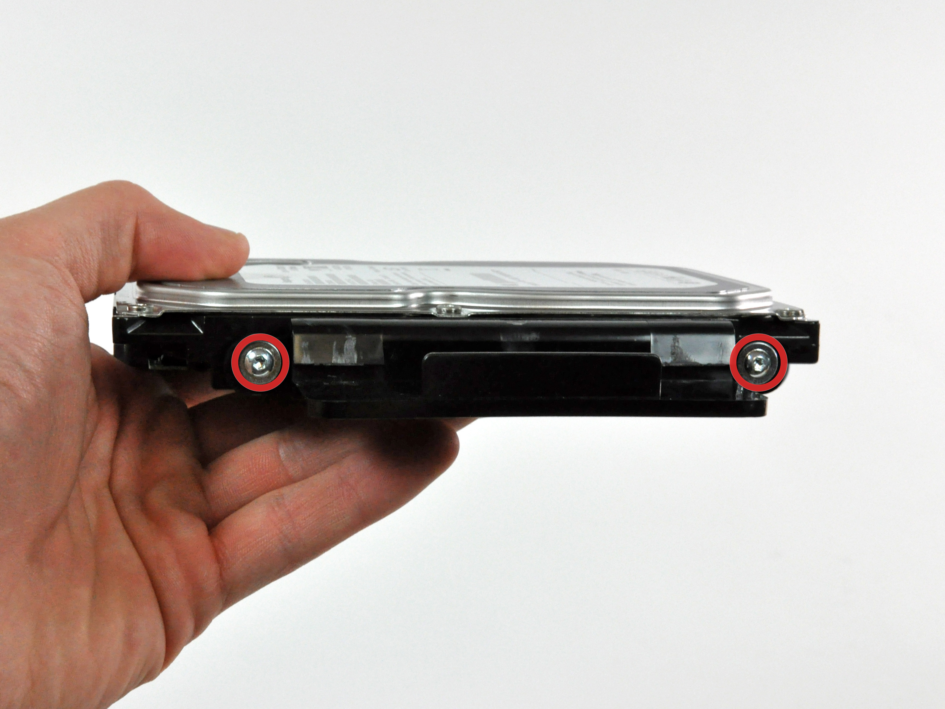

  19. iMac Intel 17" Hard Drive Replacement, Hard Drive: step 19, image 1 of 1
    • Remove the two T8 Torx screws securing the hard drive bracket to the hard drive.
    • Lift the bracket off your old hard drive and transfer to it to your new drive.
