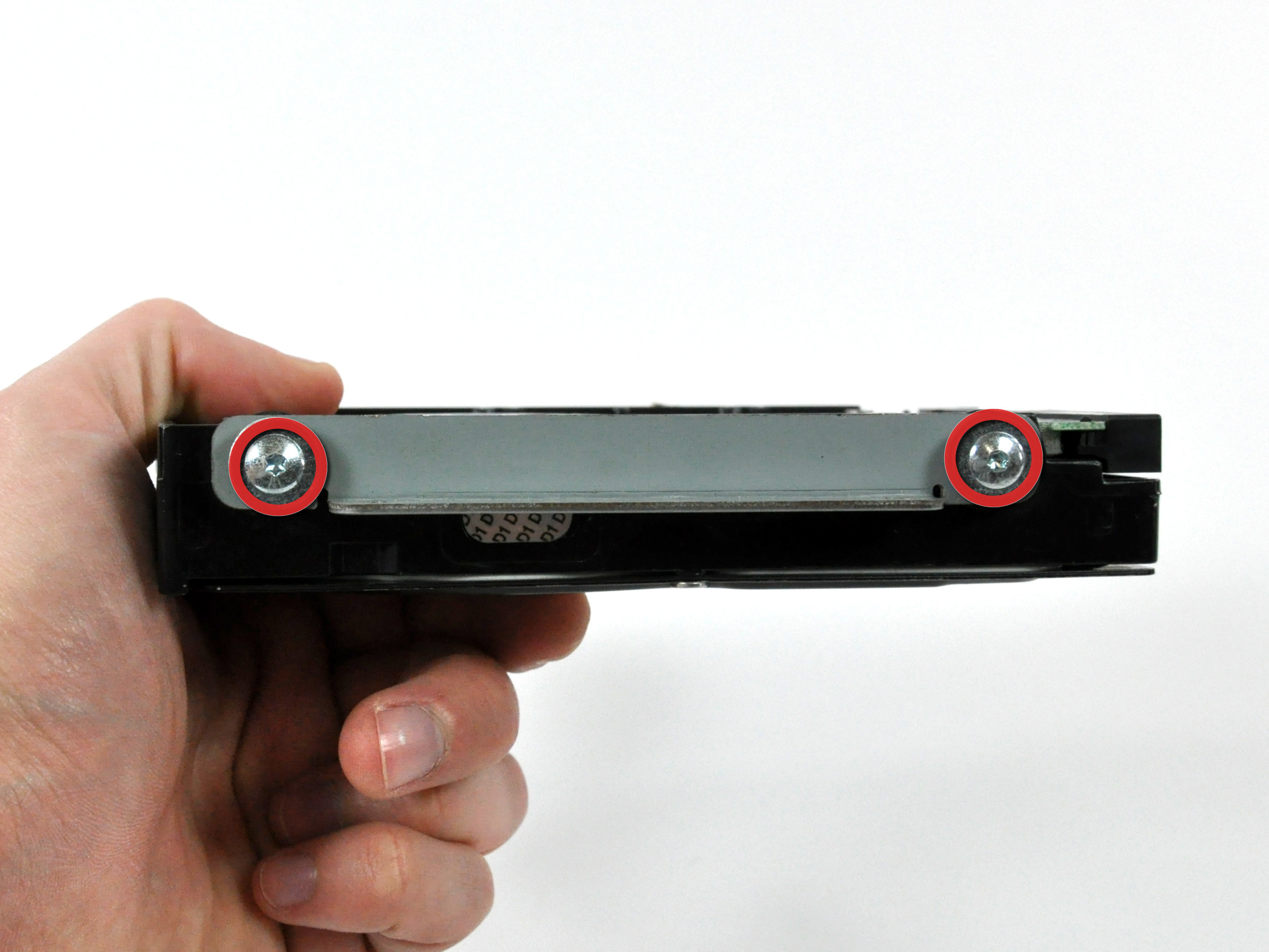

Remove the two 15 mm shouldered T10 Torx screws from the hard drive and remove the bracket.
